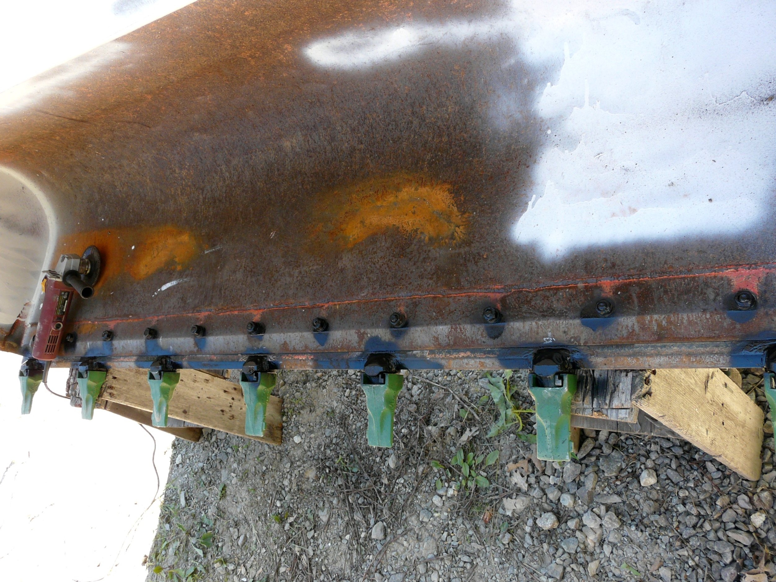

The true dedicated TLB's are pretty tough. I'd be on my 3rd std Ag. tractor the same size, as I would have killed a lesser machine. This is what I did for a tooth bar on a 6' hd Round bucket from my L39 with cutting edge, then weld on adapters for small excavator teeth for hard soil digging
Best teeth I have found are.
ESCO® Construction Excavator Lips and Tooth Systems | Weir
ESCO construction excavator bucket lips and tooth systems for ESCO buckets or retrofit to all popular OEM or competitor buckets.
www.global.weir
www.global.weir
For back dragging I have a Cutting edge welded to the bottom backside of my bucket. I find this does a much better job at backdragging tough material thahan beating up the bottom plate of the bucket.
