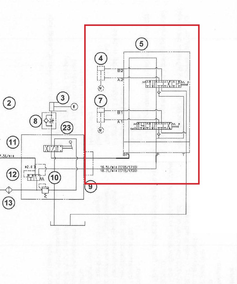

My question is why? What real world issues are you having/seeing that have you questioning the function of the PB?
Your hand drawn sketch.....trying to use retruning oil from a cylinder as its moving to feed the PB is not as cut and dry as it sounds.
First question.....WHAT are you trying to do with the PB while you are also raising the moving the loader?
The 3PH is something typically fed off a 3PH. So lets say you are trying to raise the 3PH while ALSO trying to lower the loader. BUT, you dont want to feather the FEL valve....so you want oil returning out of the base of the cylinder to go on to feed the 3PH and make it raise whatever, is that right?
If so, lets do some math shall we......
Lets say you have a 2" cylinder with a 1" rod for the loader. As you are lowering the loader. @ 2500psi.....your retract power per cylinder is just shy of 2000# plus a little help from gravity. That 2000# plus gravity is EASY to push that oil right back to tank through unrestricted passages.
But....now the path is restricted....because now you want to direct that flow to the lift cylinder for the 3PH.
Well, that 2000# of force acting on the 2" piston is only enough to muster ~630psi of pressure....add a little more for gravity helping it).
IF you are trying to lift something on the 3PH that requires more than that.....no dice. You try and lower the loader and raise the 3PH at the same time and NEITHER will move. Hence the whole purpose of power beyond.
If you really want to separate the incoming flow in the loader valve with the PB.....remove the PB from the equation. Convert the loader back to a simple open center valve. Install a flow divider before the loader valve and dedicate whatever you want to the loader, and the rest to the PB
the example with gravity is a good one, except for the fact that the "bad" condition there is user-choice. If speed of movement on that one cylinder is the user's priority, then they would not operate a downstream function (because, as you say, the "backpressure" would interfere with their priority operation.
forcing it to tank makes this choice for the user, in all cases. No option to use the full tractor flow while feathering, because some is being diverted. Perhaps this is just cheaper to make a valve this way? I don't know enough about internal routing; obviously many valves can support both high-pressure "tank" cavity and bridge/divert that to PB (sometimes optionally with 'sleeve')
One example of what I'd want to accomplish, is full-speed movement of the grapple while also moving the FEL arms or curl.
Of course I'm limited by the total pressure available to me, and if more than one cylinder encounters resistance (builds pressure) that will be divided among the cylinders.

Could also be that when operating loader when control valves are operated and the flow from valves are diverted from PB but to tank.... Pressure to PB may only be percent when FEL valves are all in neutral position.... If you have brand name of control valve and you can find a schematic of flow through valve maybe you question would be answered...
This is schematic for my FEL control valve for my MF GC 1715.... If you can find similar schematic for you tractor it may answer your question...
