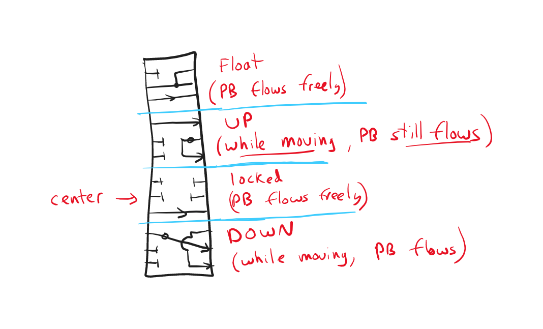

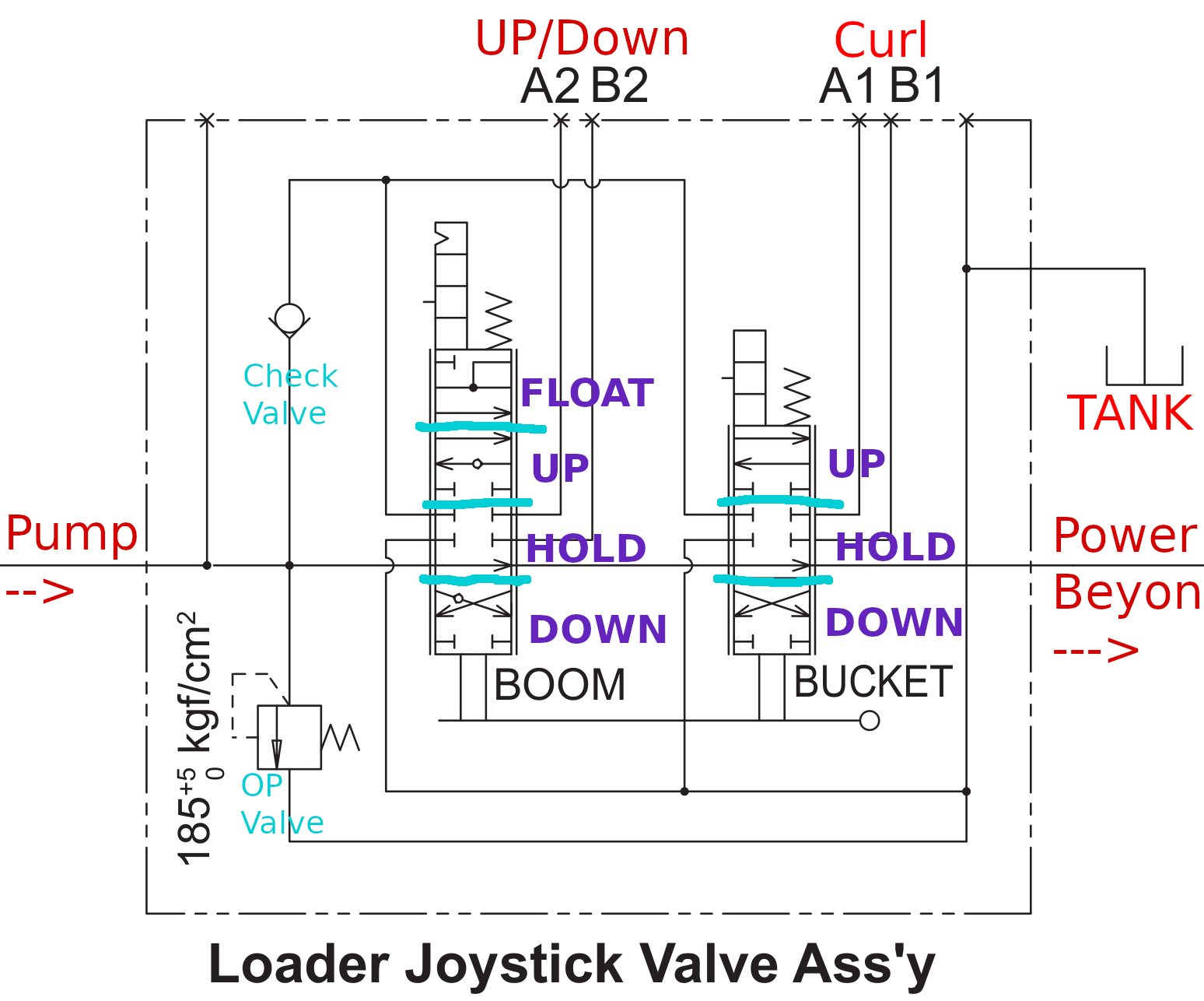

My FEL completely cuts off the flow to the remaining PB. IE: when you're using UP/DOWN or CURL, rear remotes, 3rd function, etc cease all function. I understand this is ~universal. But why?
here's the schematic from the manual (with some annotations to help, as these are hard to read if you don't look at them much). As you can see, FLOAT and Hold/Center allow PB flow, up/down do not (at all)
MY QUESTION: can you get replacement valves that operate like this (using the UP/DOWN cylinder w/ float as example)
  • in the end, when a cylinder reaches the end of its travel (or overpressure is reached), the same thing happens (PB flow interrupted, overpressure valve quickly activates dumping all flow to tank)
  • BUT in the really common case of feathering a change:
    • PB flow continues, fed from the draining cylinder
    • the FEL cylinder still has "priority" to the pressure in the system; it must be moving for any flow to be delivered to a downstream (in the PB circuit) load
    • the delivered power is split between the FEL and any other attachment in use .. but at least you have the option to split it here
I don't see a lot of downsides to my flow; why are FEL's on these CUT's ~all wired as they are, and is there a way to change this (aftermarket spool replacement, etc)?

   / why does using FEL stop Power Beyond flow #2
I believe what you are attempting to describe would be a series - parallel circuit which is what some FEL valves offer as an option. How these work is return flow from the lift lower cylinder is directed down stream to curl dump circuit. This is great for lifting and dumping or lowering and curling. This only works while the lift cylinder is moving.

During feathering the unused flow is going out the power beyond port.
feather a dozen valves with all of them getting flow and still have flow out of the power beyond.

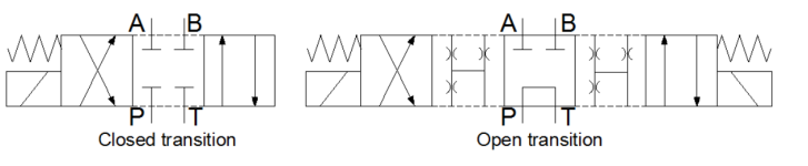

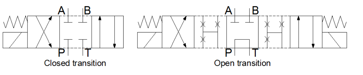

Ok, after re-testing more carefully, you are correct; flow is sent to PB (until the FEL valve(s) is fully opened.
So basically it "transitions" [somewhat] linearly from hold-position to [eg] up-position. Question: Assuming this is standard, if a valve does _not_ do this, is it noted on the flow schematic (how?)
For any future readers, the Kioti ck2610 with factory loader and rear-remotes can raise, curl, and backhoe simultaneously if FEL valves are so featured.
EDIT: "open transition" vs "closed transition" might be how a schematic should represent this. Although note the picture below (with the additional "dashed" segments) would not be the flow in the FEL as it would allow the load to drop when in transition - not how an FEL valve behaves. But per the link below, "closed transition" fully shuts the center option before beginning to open the left/right flows.
