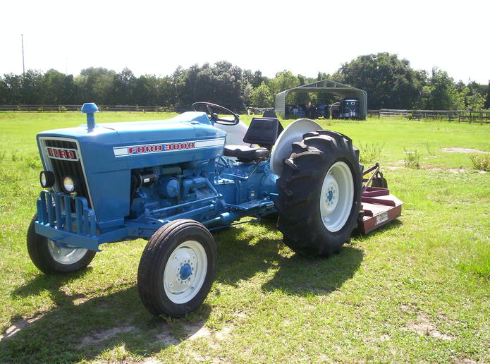

Hello , my name is Adam and am new to TractorByNet site. I am a new tractor owner and need some pointers on some maint. on my tractor. Will start with this: why does my tractor have tow oil filters? and where should I look for the tractor year and model of my tractor. thanks

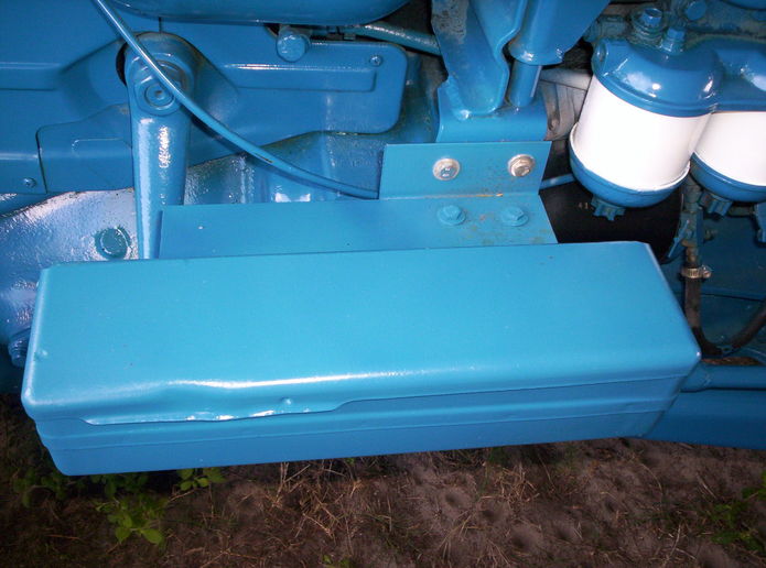

are you sure you are not seeing a dual filter head with 2 fuel filters on it? perhaps you have a early 3000 and it has it's oil filter hidden under a canister on the sid eof the engine instead of a regular spin on.
look at the 3 pics I post. first 2 show 2 white filters on my 3000.. they are fuel filters.. is this what you are seeing on the right side?
on the last pic.. it is left side.. look above the front tire, below the hood, and aft of the black generator.. that 'canister' is the oil filter for a early model.
post back.. or post some pics.
also.. under the moveable hood part that covers the battery there should be an id tag with model id and sn.
that info is also stamped on the clutch/trans bellhousing flat aft of the starter..
post back the info / numbers found there. early 3000 units will have a 3 as the first digit of the model ID.. later units 4-68 or newer will have a model ID starting with C.
sn's can start with the letters A, B, or C.. A for antwerp belgium, B for basildon england, or C for here in america. most units I see are C sn prefix, with some B and a very occasional A.

Ty for your reply. My filter is on the left side, as in your third pic. Will try and send a pick in a few days. I believe now, one is an oil filter and the other is a transmission filter. They are just in close proxemity to each other, but today I traced the device that one filter is attached and it had a line going to opposite side of tractor and into the transmission housing. Will also get the numbers from under the hood and let you know what they are. Sorry for being so simplistic, just my first tractor.
Question: when I am bushing, and I run across palmettos or even lesser type of weeds, my pto will jump out of gear. I reduce the rpms and try to put it back into gear you can hear it grinding, but it does go into gear until I hit the next patch of rough weeds. What do u think the problem is?
