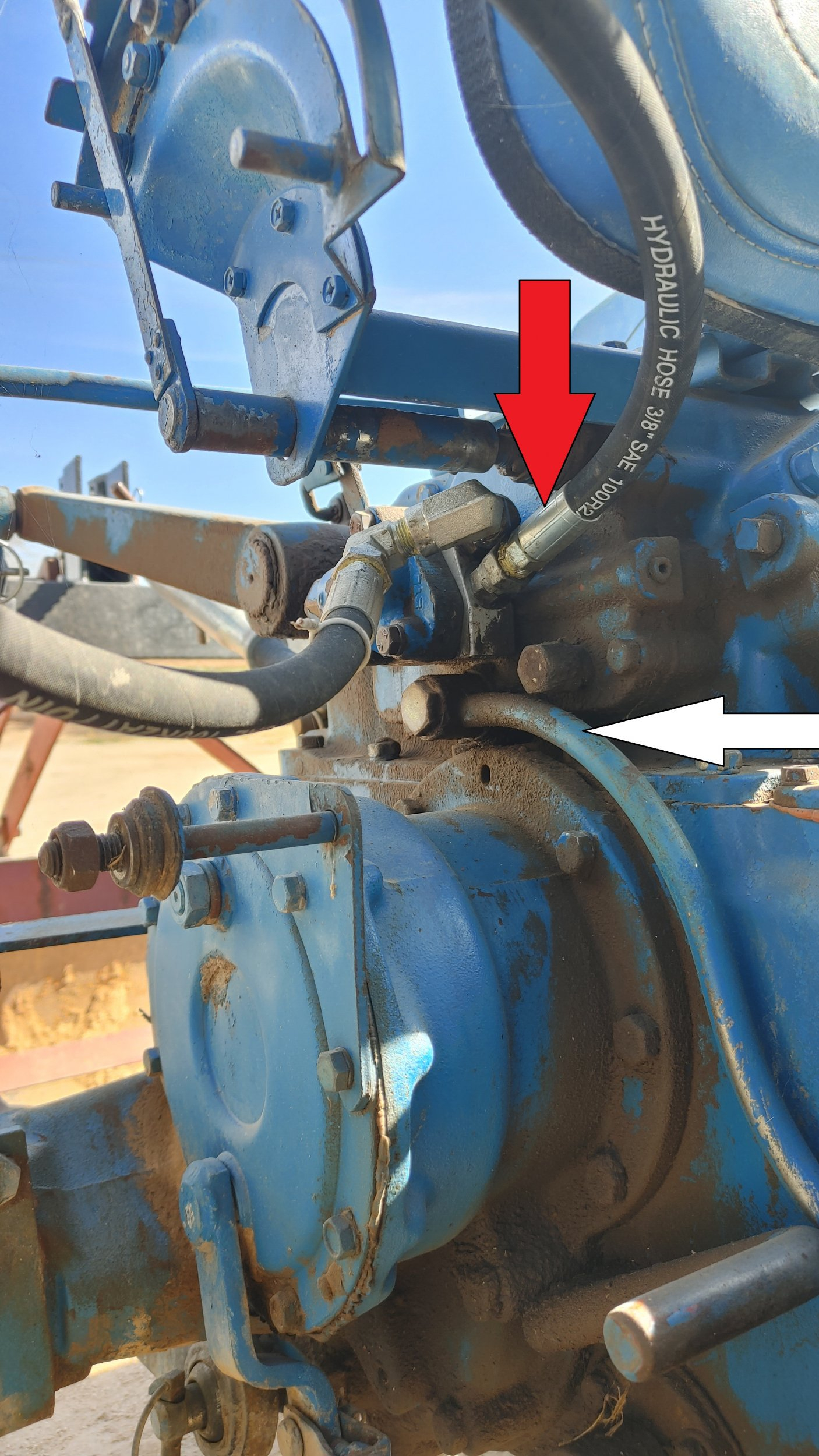

You said the FEL is fed from a block bolted between where the 3ph is originally fed? So what is feeding the 3ph now?
And you day the old valve did the same thing in float?
I'd say it's not a valve issue, it's the way the valve is plumbed.
Are there marking s on the ports. Like P and T
It almost sounds like it's either plumbed backwards or that it needs PB

#16
Ok, I had time to go look at it again. The white arrow points to the pipe that comes from the hydraulic pump. The red arrow is the pressure hose to the valve, which is marked as "IN". The other hose is the return which is marked as "OUT" (as it is plumbed the way I bought it). The 3 point is fed from the the pipe into the 3 point housing. The FEL is plumbed from the aluminum block that the hoses are attached to. When there is no FEL, the relief valve bolts directly to the lift housing.

Since you state relief valve bolts here if no FEL, Where is the relief valve in the system located now?
Is there six or seven hoses connected to the loader valve? Since like LD1 states both valves did the same it sure points towards something being plumbed incorrectly and if 1st valve didn't work connecting the 2nd valve the same way may have just duplicated the problem.
Do you have to mechanically shift something to make the 3PH work? Does the 3PH work properly today?
You have a pipe "from the pump" and a pressure in hose? So you have 2 pressurized inputs?
The blue item to the left of where the hoses are connected in the photo is the original relief valve. When an FEL is plumbed in, it goes on the other side of the adapter. There are six hoses going to the valve. The 3PH works fine. Nothing mechanical to shift for the 3PH to operate; just move the lever up and down. To be clear, I didn`t replace the valve because of the float not working correctly, I replaced it because it leaked like a sieve and I wanted a third function for a hydraulic top link anyway. If I put a hose on the PB port, where would the other end go?
