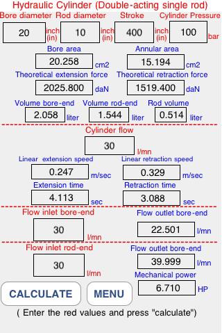

I looked in my old college engineering book. It makes NO difference whether the hydraulic cylinder is in the up or down position. The rod extends and pushes or retracts and pulls. The forces are the same in either the up or down mounted position.
   / Why do most tractors with FEL's......................... #30
Doubling acting cylinders do not have the same power both ways. Its simple math and physics.
