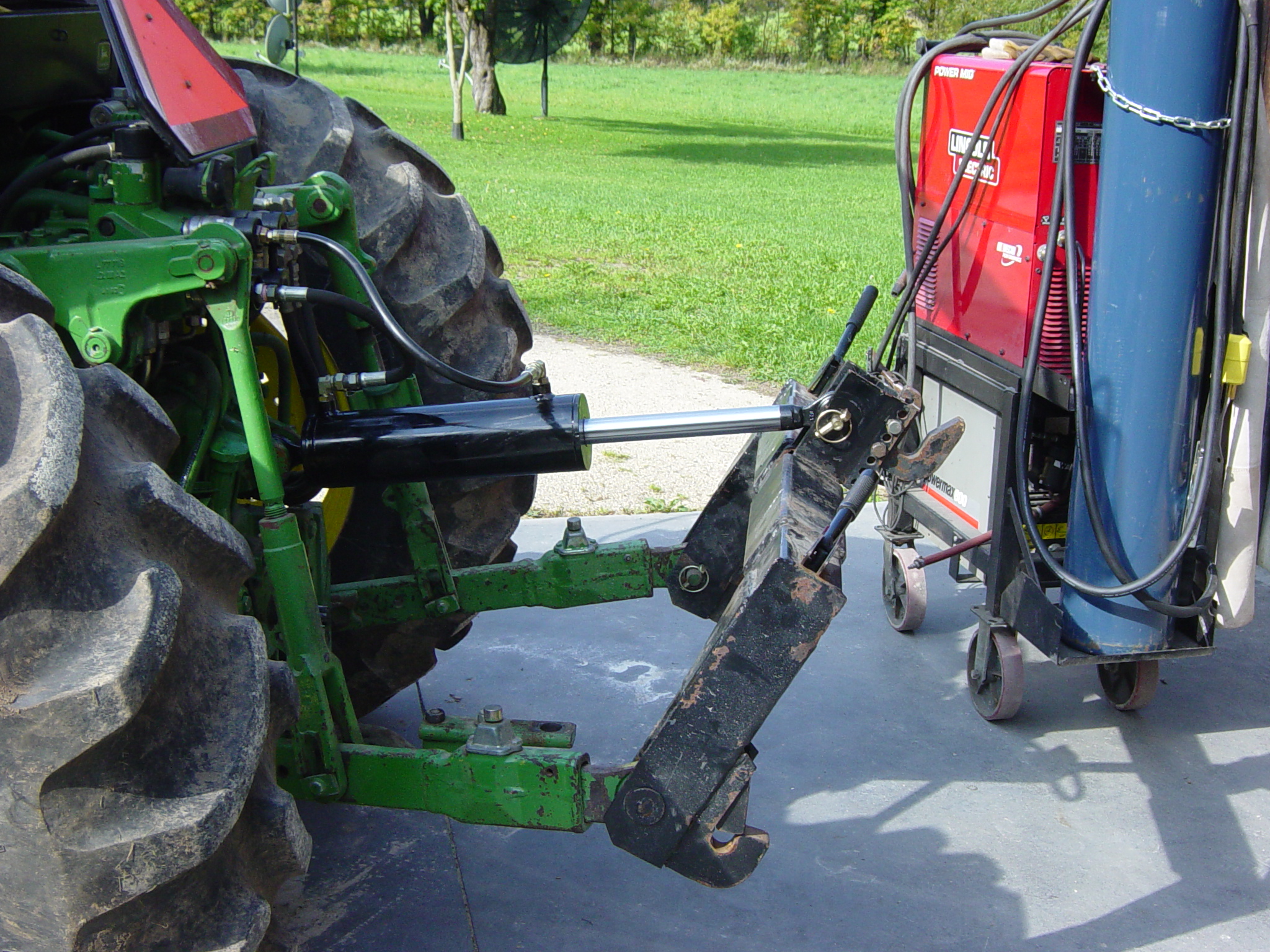

I know! Bought one cheap at a Richie Auction. POS, had to modify (widen) it to fit my stuff, but it's GREAT! Makes the archaic horrible Ferguson System Bearable.
No offense, but I still don't know why people bother with the lift arm-only, two point quick-claw things?
A top tilt cylinder can make it even easier. With larger tools, you sometimes need only extend and hook the top, then pull in the tool aligning the bottom perfectly.
