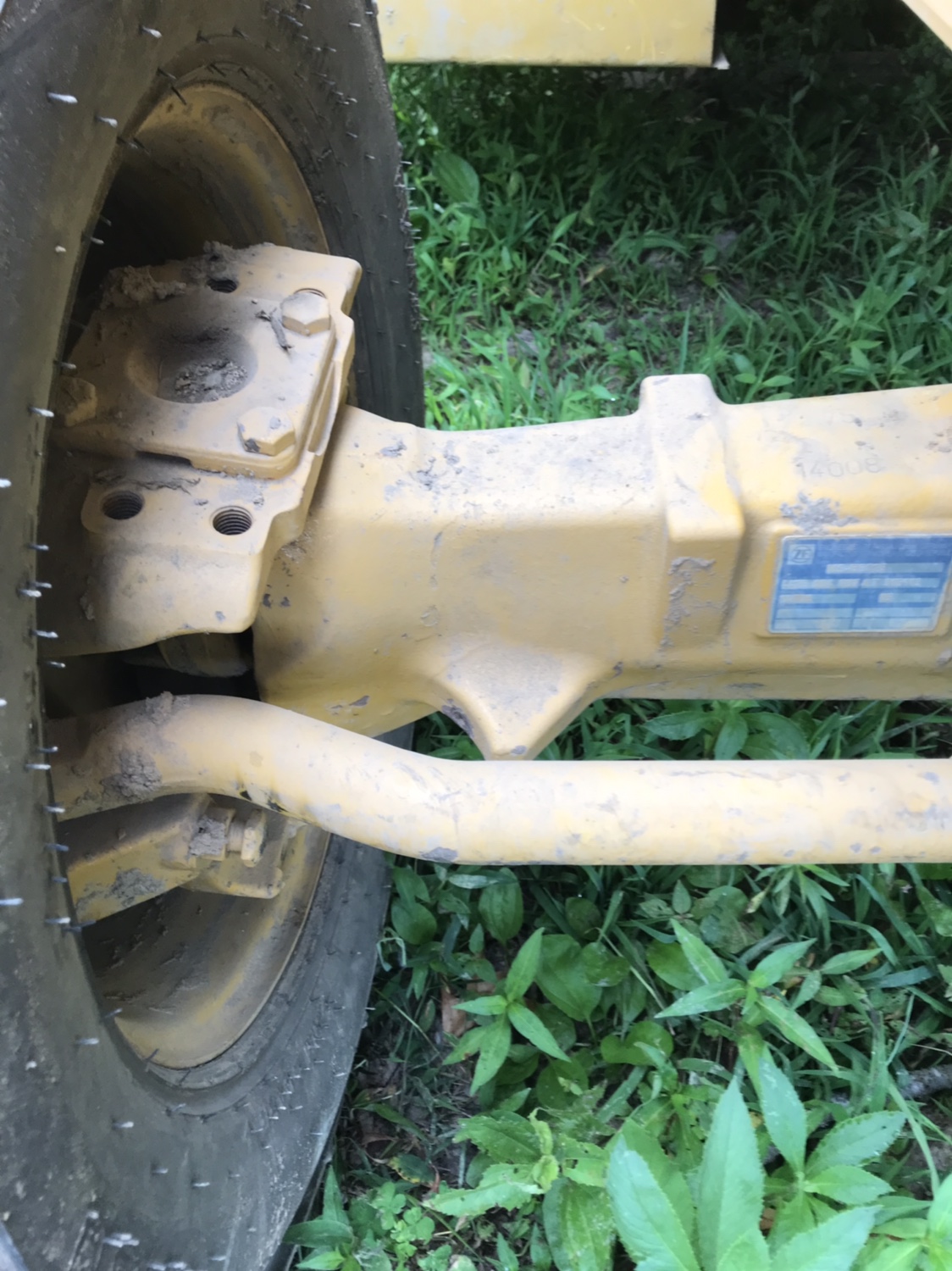

Define "considerably". Because my L3301 has a 5" dia. front axle and it would be hard to believe that a Korean tractor has a "considerably" bigger front axle for the equivalent hp tractor.
My Deere axel is considerably bigger and and a better design than the ring and pinion tractor axels. Never mind the fact that the machine weighs 3 times as much as the tractors. That doesn’t seem to important in this discussion. IMG_6985.JPG

The Grand L is far superior to the standard L. Not just built a little heavier. I miss my L3240 every time I run the L3800. The most notable differences are a way better 3 point hitch, way better transmission, nicer seat, stronger loader and better steering design on the front axel. There’s a lot more lesser important features too. And I’d pick a Kioti over a standard L.
Yep, you get one heck of a lot more tractor in a Grand L for your money. Little things like telescoping lower links and telescoping sway bars make hooking up SO much nicer. And I did pick a Kioti over a standard L. :) I have heard people denigrate a Grand L as just "bells and whistle" meaning that the extra things the Grand L offers for extra money are superfluous over a Standard L. They don't know what they are talking about. There are dozens if not hundreds of improvements in a Grand L over a Standard L not the least of which is more weight, and considerably larger axles to go along with their stronger loaders. But companies provide choices and price points to sell tractors. It is up to the individual to decide where they want to fall on that spectrum.
