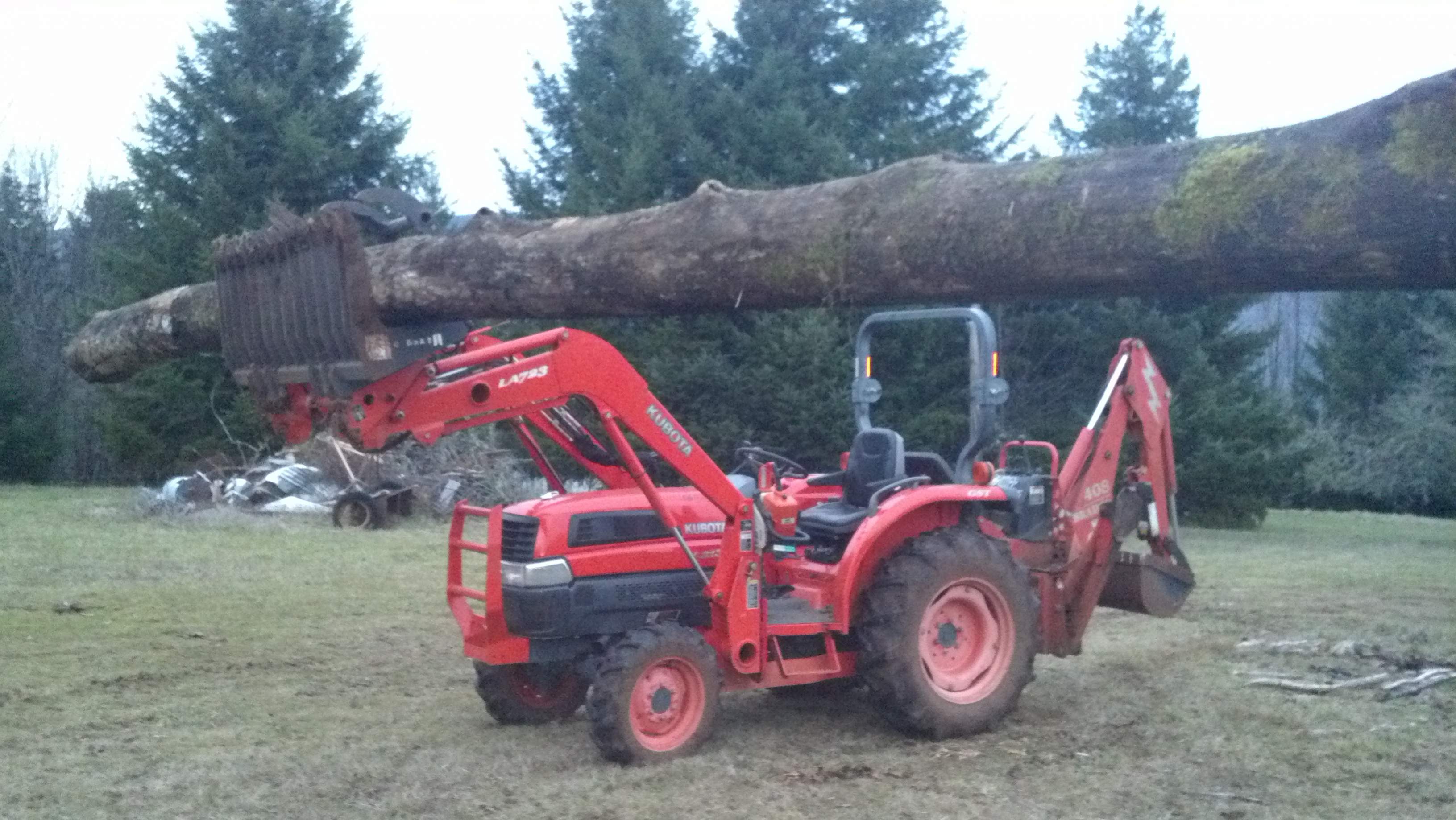

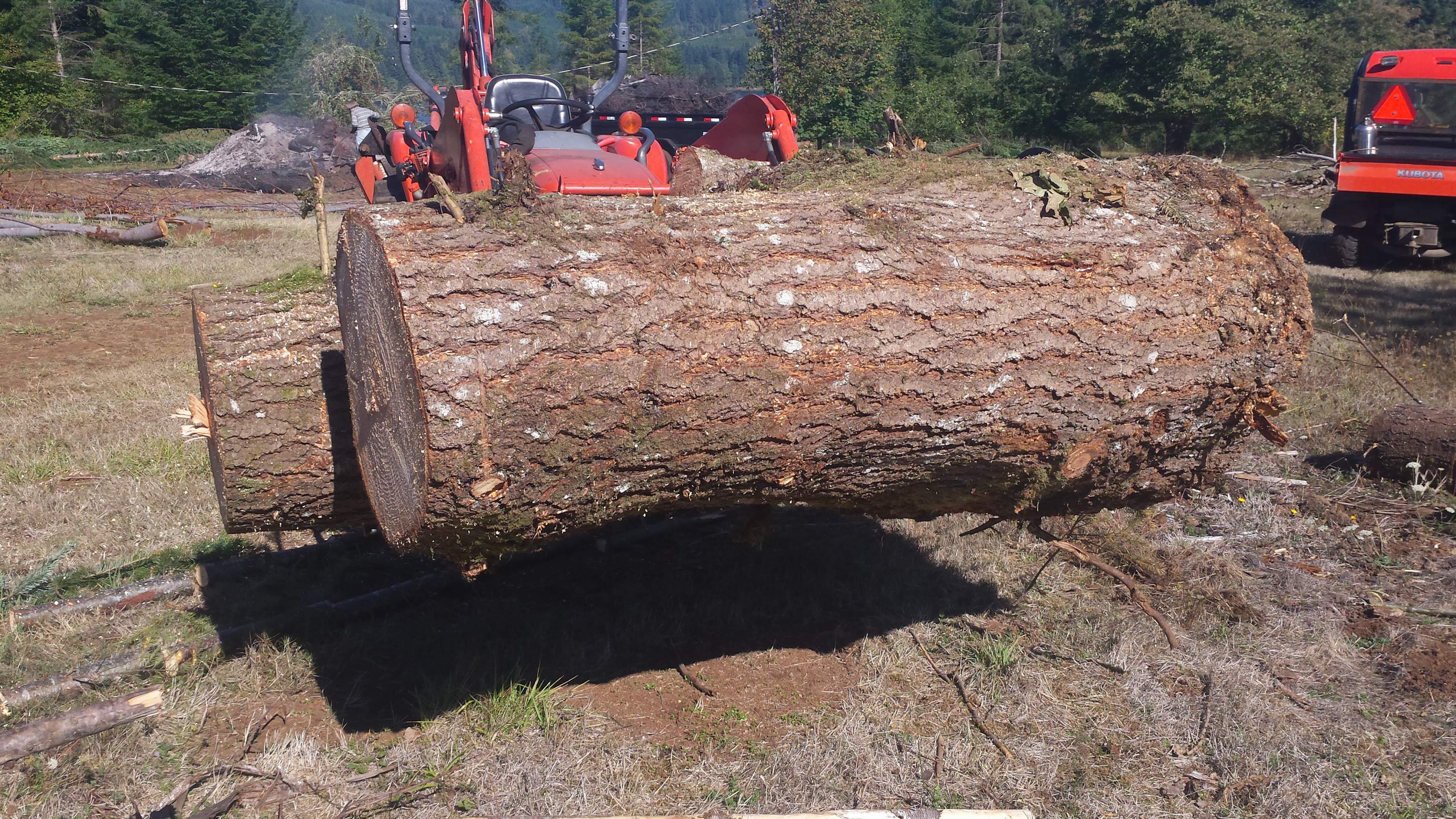

Grand L3130 with LA723 loader, needs backhoe mounted plus Rimguard loaded tires to keep rear down. Stock from dealer no hydraulics adjusted.
David
