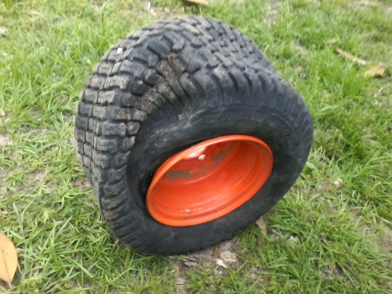

Thought I would post the outcome of the foam filled tires. I finally got back into the woods where the tractor has sat for the last month. it was not to hard to put the tires on with someone to help. the tires are heavy with the foam in them ( 200 pounds each,) but they don't have as much bounce as a regular tire, and this made them easier to handle. I ran the machine out almost 2 miles, and I could tell it rolled a little different, but not enough to even think about. I would recommend getting them filled, if you are contemplating any kind of demo work at all.
