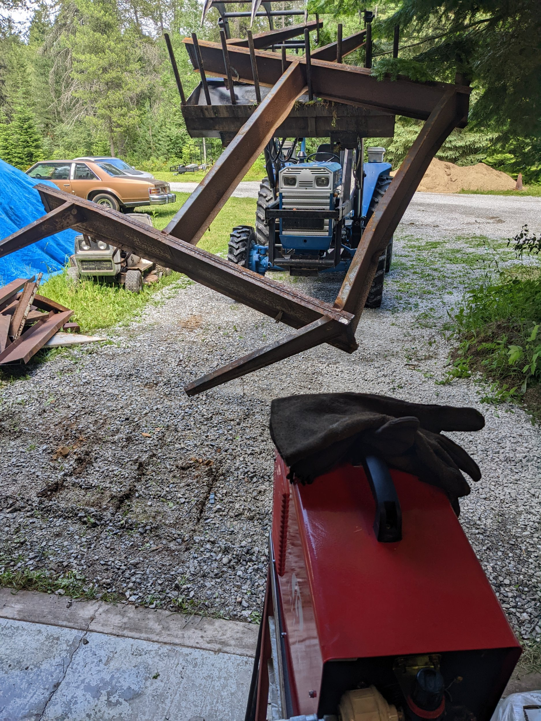

I have the 3 in 1 LTPDC2000d version LOTOS makes
in October it will be 7 years old. Its very first job was sectioning a complete car into pieces of 4x4 or less to go to the recycler.
Today cut up an entire 55 foot mobile home frame.
For some reason the one I got just won't die. I think it is on it's second paint gun air filter:ROFLMAO:
It is a passable stick welder but like my Idealarc Lincolns better.
A very decent DC TIG welder.
But it is the only Plasma cutter I have so it gets used quite a bit.

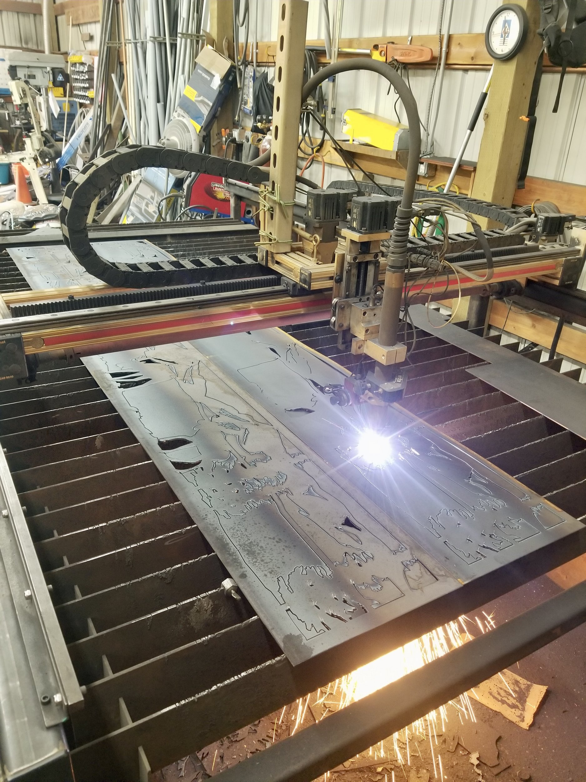

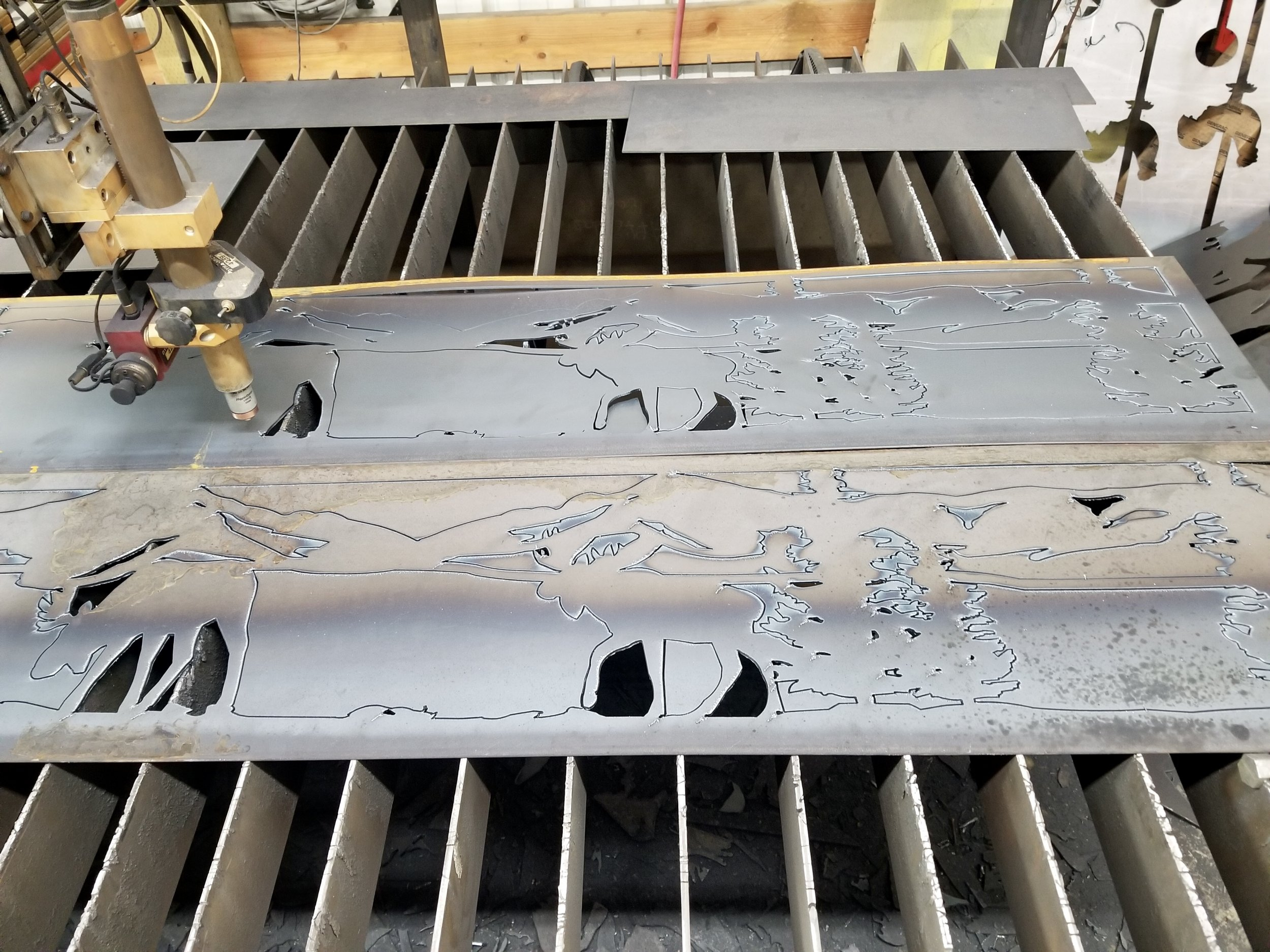

Hypertherm 45 love it. They make what everyone else copies. Long consumables life.
Water separator on compressor, coalescing filter inlet and has it’s own coalescing self draining filter internal. Dry air a must.
Use 911 Motorsports stencils and tub cutting table.

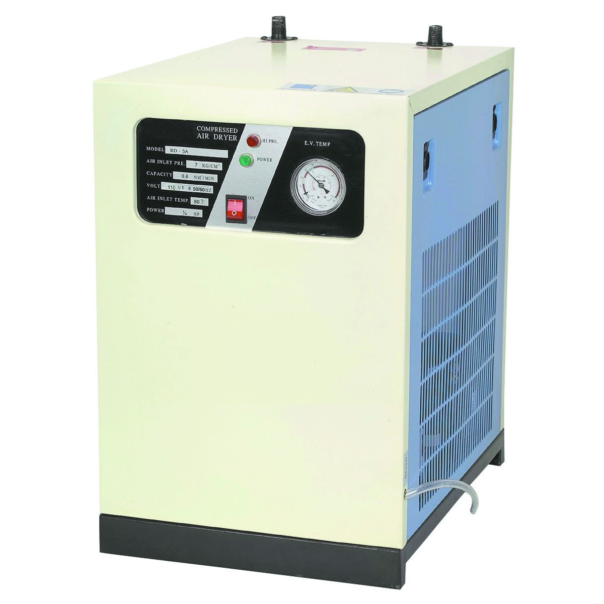

I have an IR refrigerated dryer on my compressor main outlet plus one of those cannister filters that take a toilet paper roll on the inlet of the Hypertherm. Dry air and plenty of it is the benchmark for any plasma cutter. They don't work well with a small compressor either. I have both a Sullaire screw compressor and a 10 horse Champion reciprocating compressor for a back up and the screw cannot keep up with demand when using the plasma table. With both running, really spins the electric meter.. lol
   / Who want to chat about plasma cutters? #19

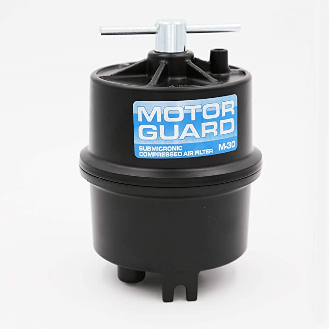

Very interested to know more about the air dryer you are using.
I actually went with the harbor freight unit… 10 years ago and still working great. Removed 100% of all moisture.
how do i know this. I also have a Motor Guard paper air filter downline. The filter remains absolutely dry after a year of use. I do change out canister every year just to be safe, but the element is always spotless. And my plasma table get alot of use.
