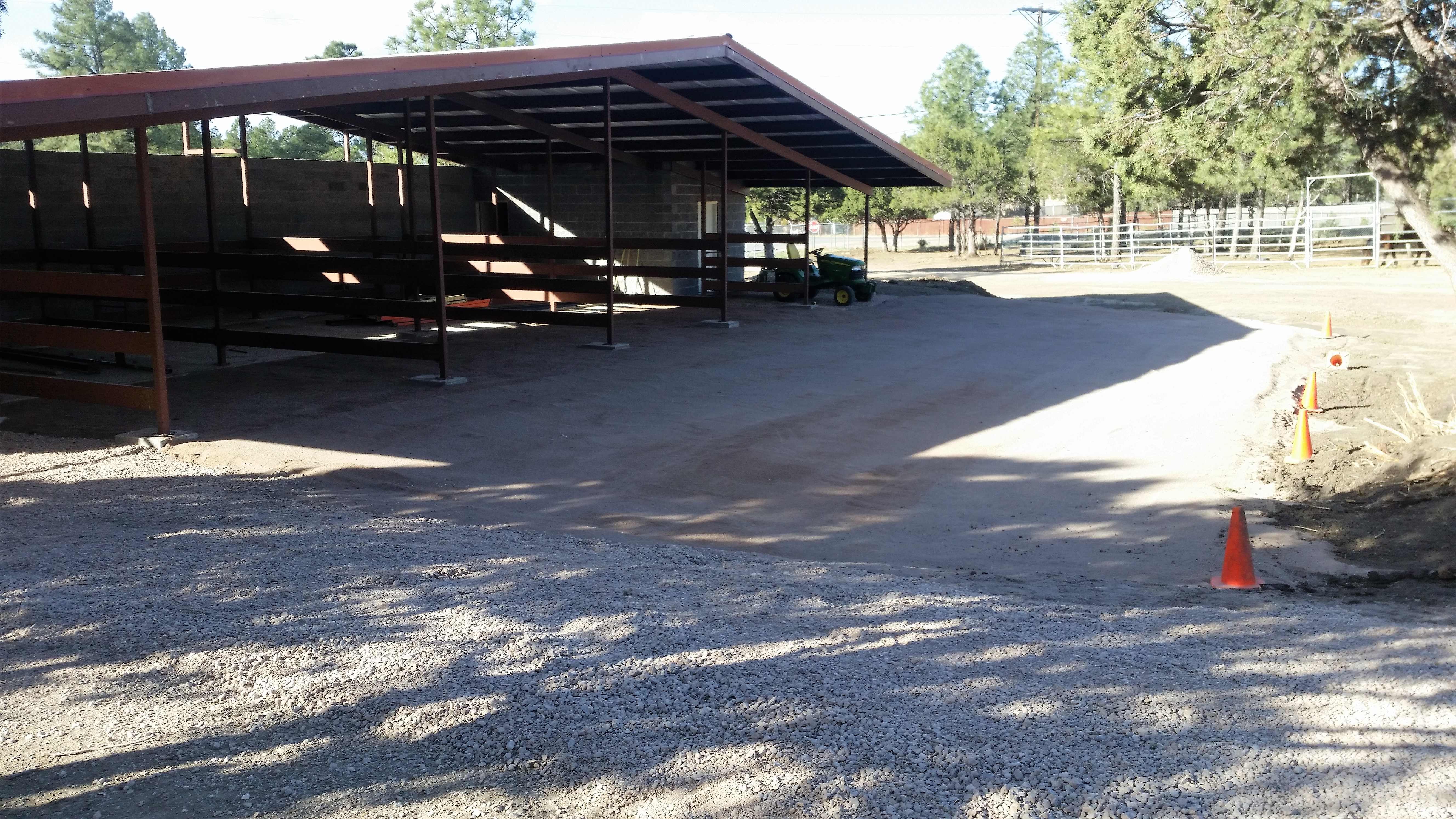

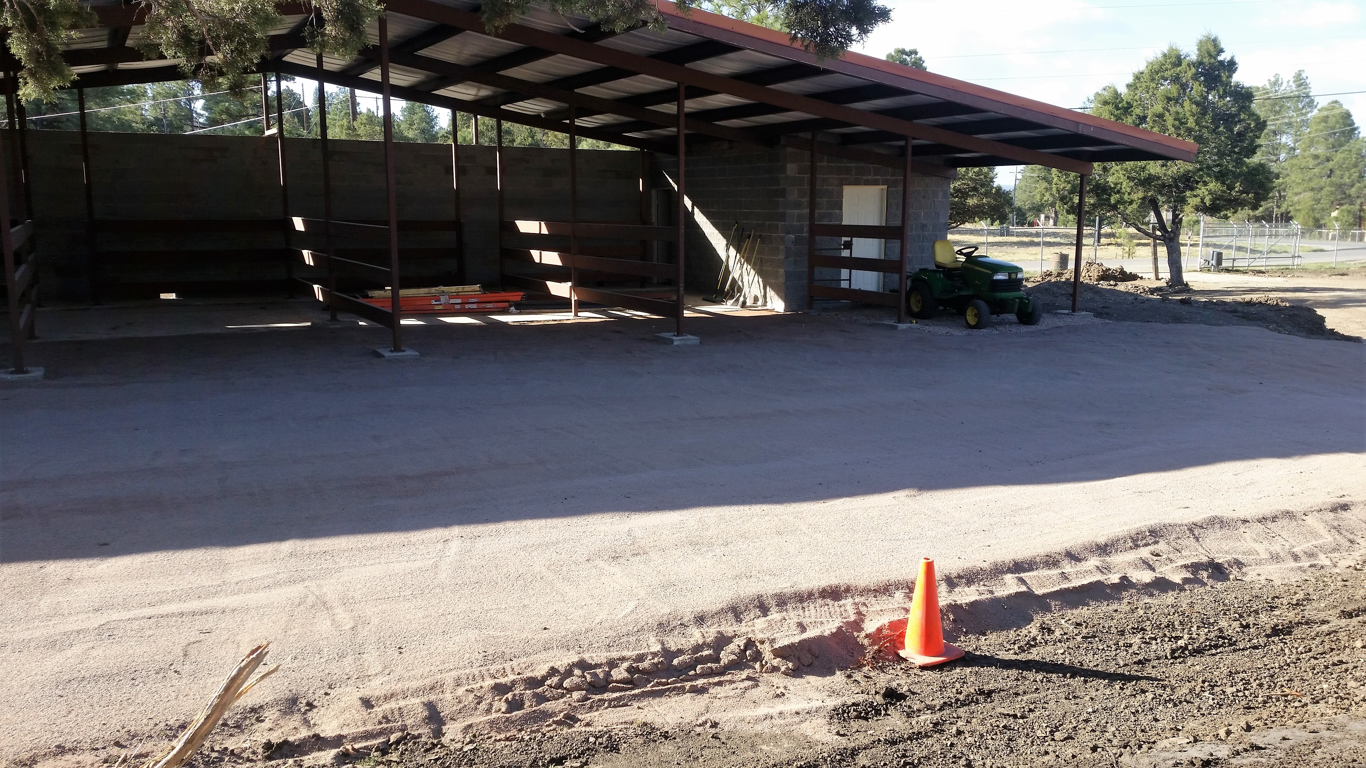

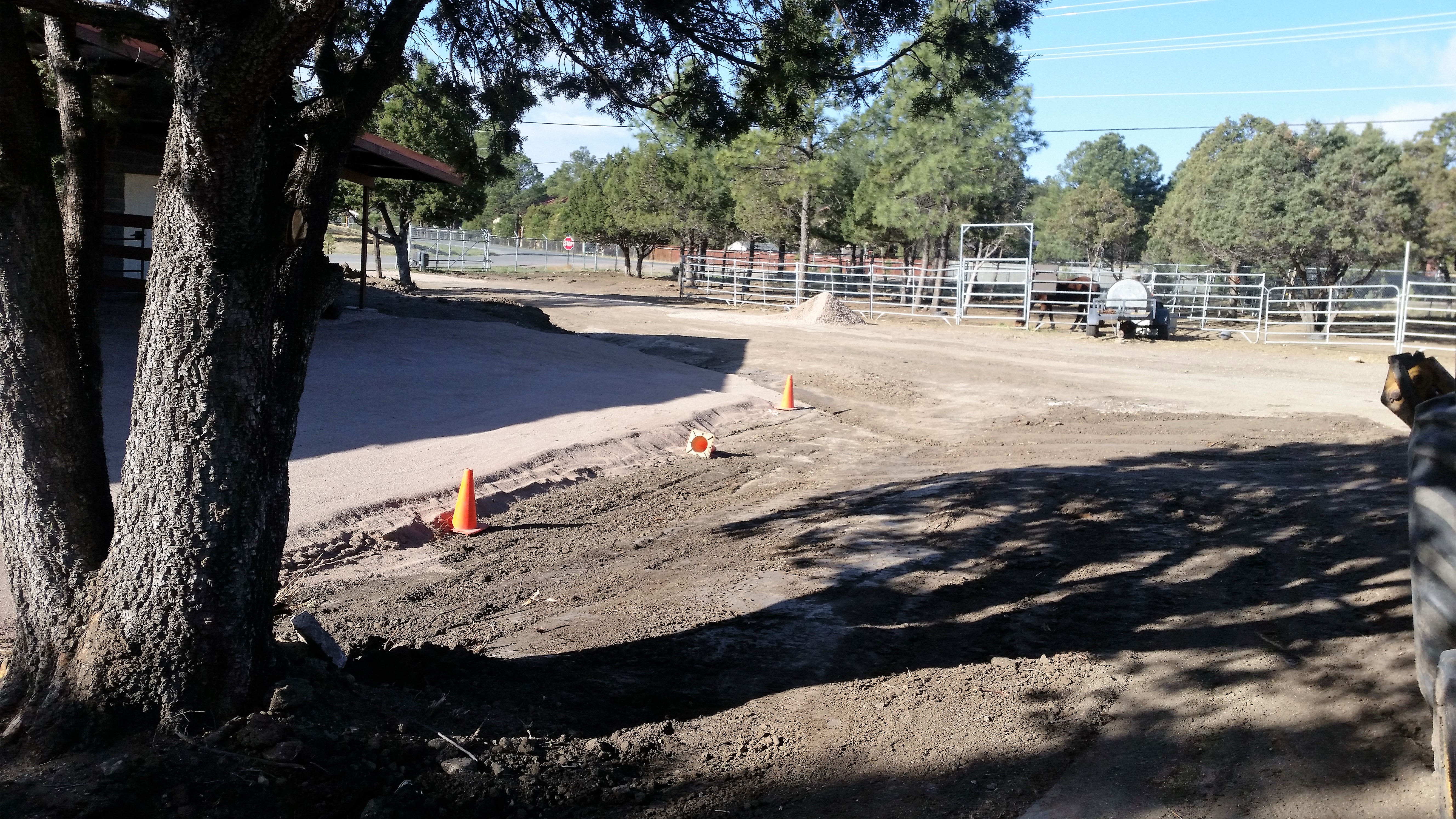

   / Who uses dual tilt cylinders? I do... #39
I am finishing up a job for a horse barn right now and could have used more tilt than the single 4" stroke cylinder would allow. Maybe a longer stroke cylinder would have helped but the tractor is tilting one way and I needed to cut in the opposite direction. Had to get off and adjust the manual screw adjustment many times to get what I needed.
The customer built the barn facing the up slope with pens to be built extending up the slope. When I mentioned that the barn should have been built on the upper side with the pens down hill he seemed to be embarrassed but agreed. To fix his problem I had to tilt the pen area with a down hill .350 slope and run the water around the sides of the pen and barn. Then built a small berm ahead of this on the up hill side to divert the water away from the whole area. Added 6 inches of sand for the horses to stand on and smoothed it out.
