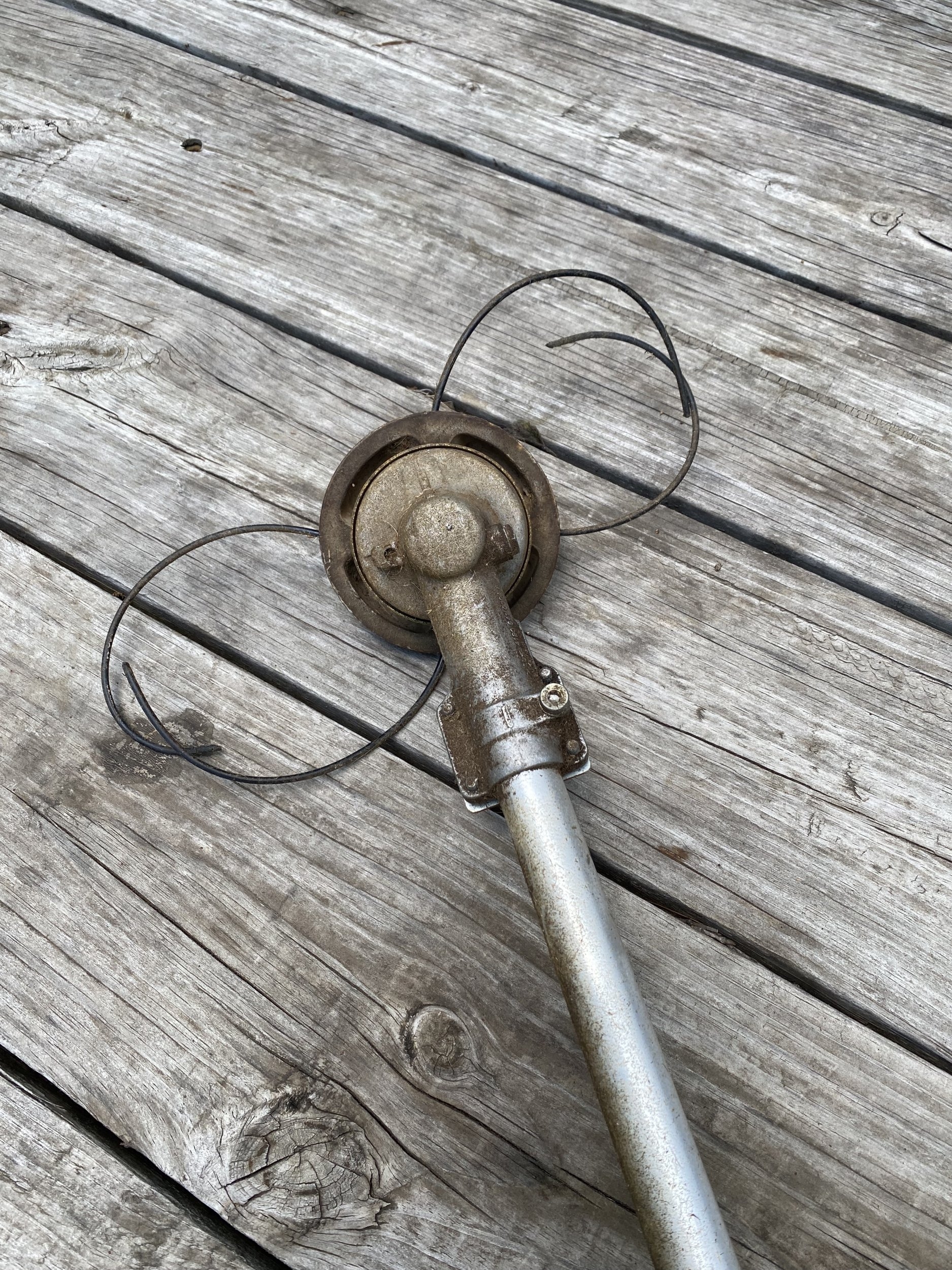

   / Who uses .155 line successfully in a string trimmer #7
.130 has been working pretty good for me on my KB131 powerhead.
