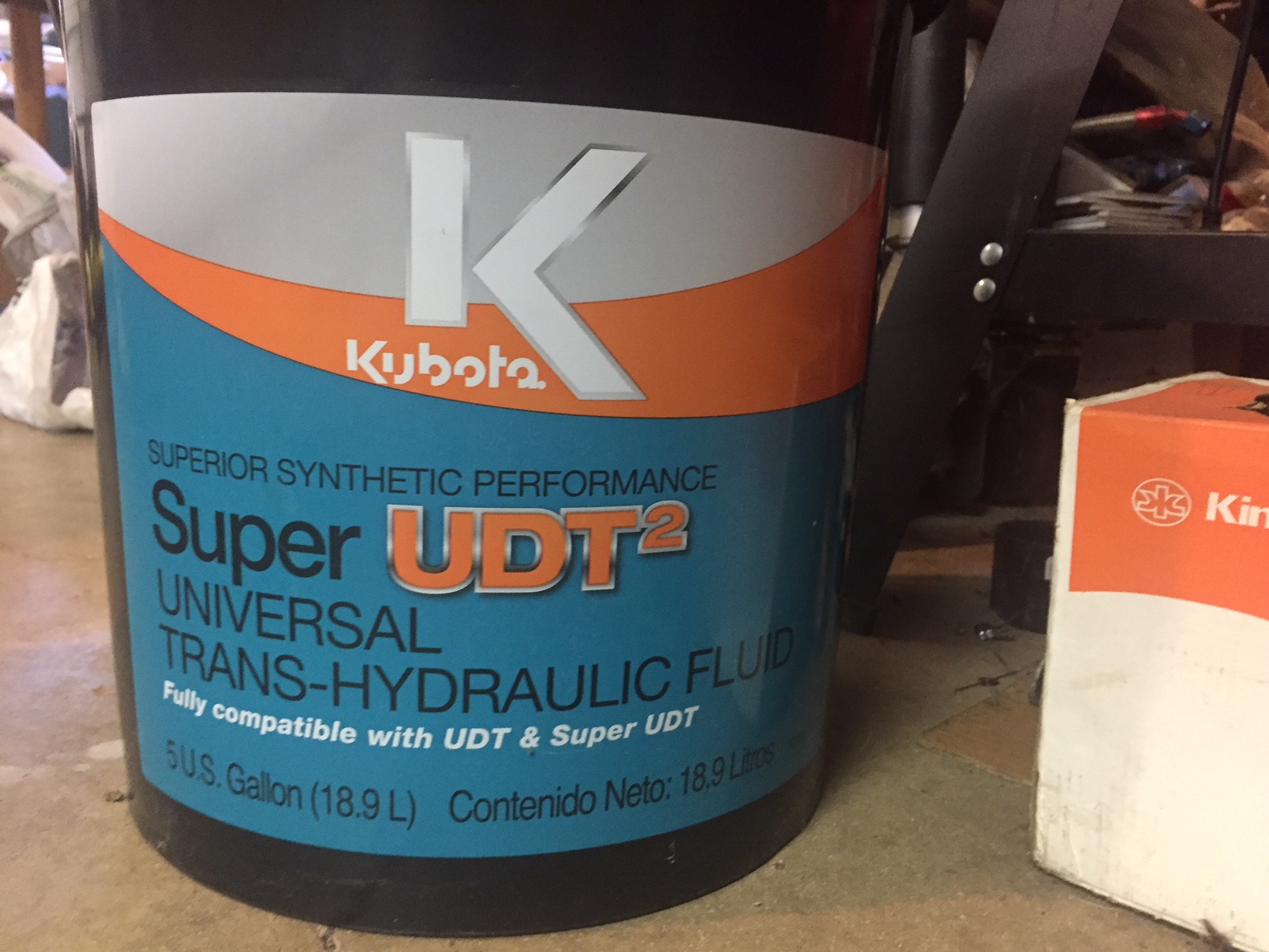

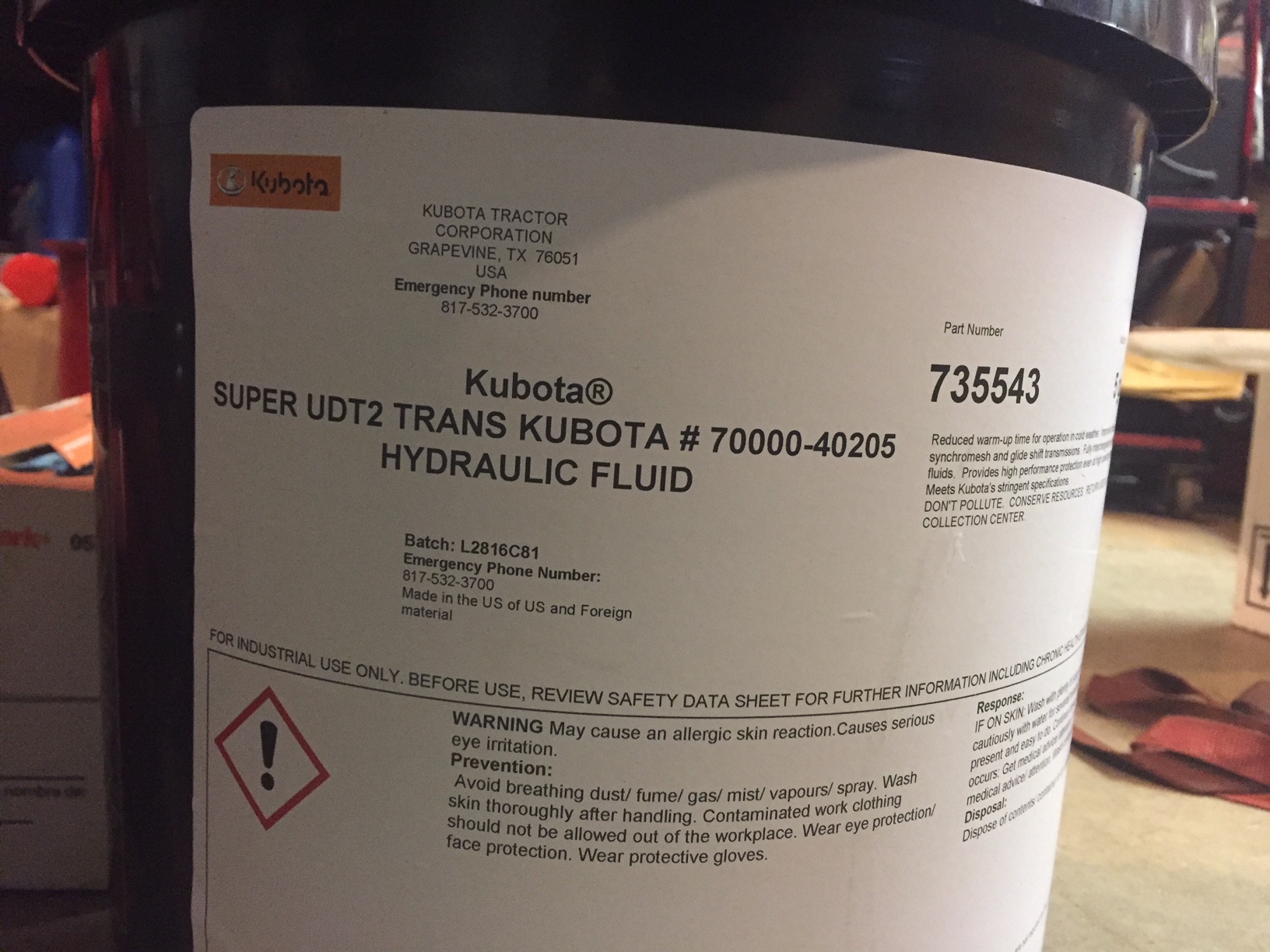

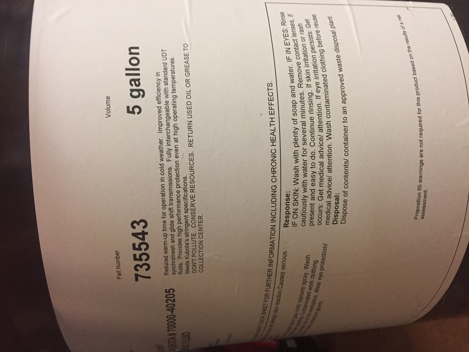

Below you'll find a few pictures from one of the recently purchased 5-gal pails. I'm not seeing where is says it is Synthetic.
Added in Edit: First picture clearly shows it is SYNTHETIC
Well, it says "Superior Synthetic Performance" in the first photo. This isn't a politician talking so my guess is they mean what they say or imply. I can't think that conservative Kubota--or any company-- would run afoul of mom and apple pie and litigious America to make a sneaky statement in this day and age, right?
In the past, I am certain I have seen the word synthetic in Kubota marketing and promotional materials regarding this oil. This oil better be synthetic.
My bad!!!
I must have looked at it several times and didn't see it... I'm really sorry about it.
For the record I've used it in all my Kubota tractors and it does (B3030, B3130 and L4740) seem to work well in colder temperatures.
