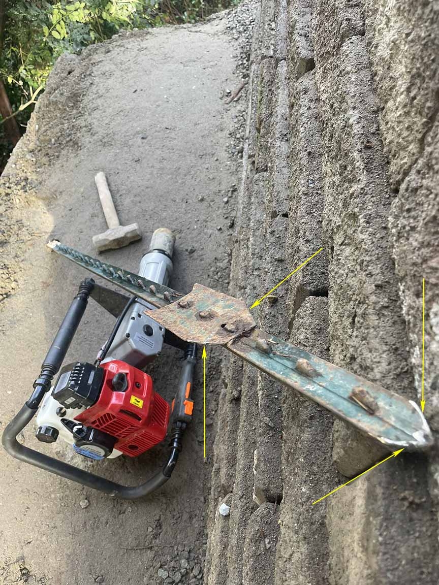

The helical anchors will arrive today Sunday.
Crazy what Amazon has done to projects, with one-day delivery.
I cannot IMAGINE they will hold as well as 6ft (or even 8ft) T-Posts.
Maybe I'll just toss them in the toybox and go get 12 T-posts.
I'll know how easily (or difficult) a 5 foot post drives in, fairly soon.
Driving 12 T-posts could be a chore, but I have 2 days....

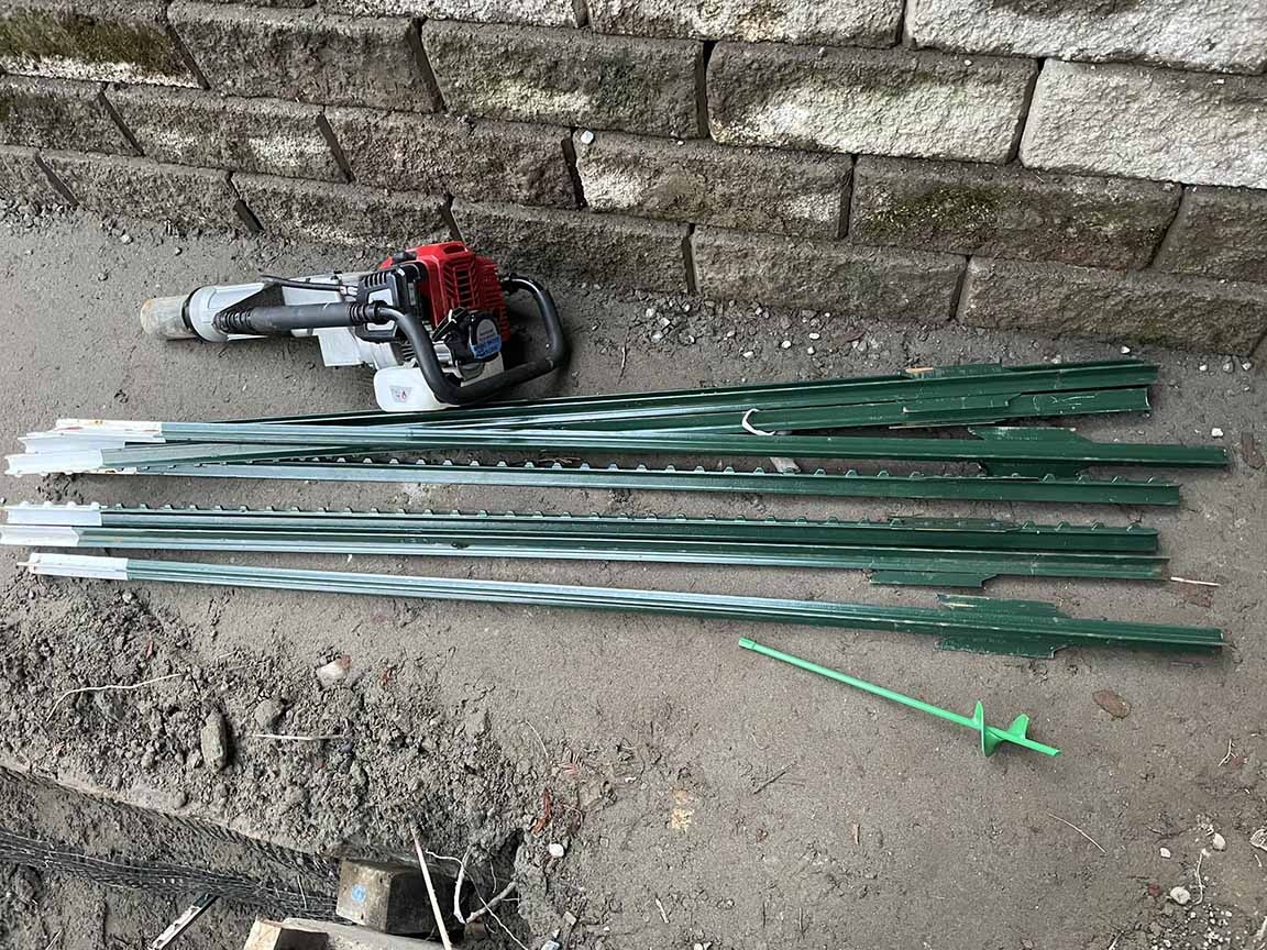

Here's a pic of a sharpened T-post and my two drive methods.
I bought the gas-powered driver for another project.
Intended to sell it after that project, but didn't.
All you tool-guys understand how that goes.

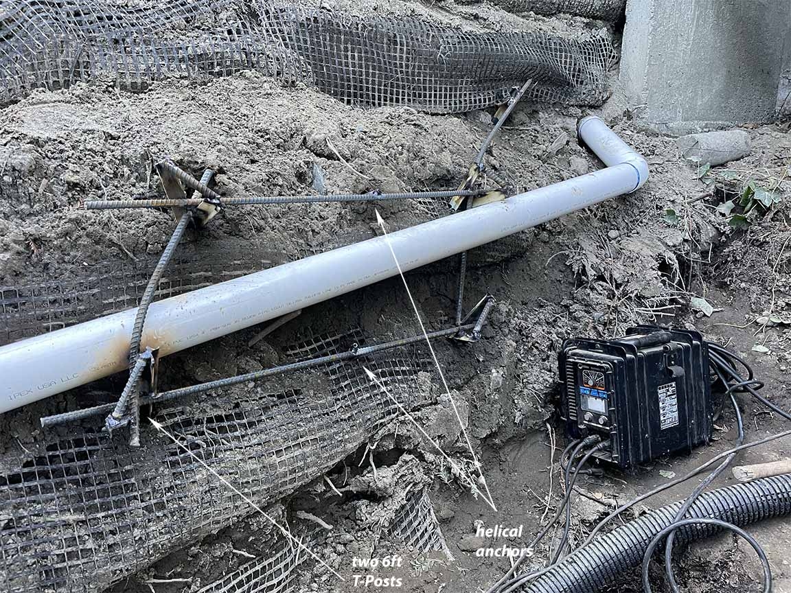

The helical anchors available quickly on Amazon.....were un-impressive (no suprise).
I'll put them in my toybox for some other project.

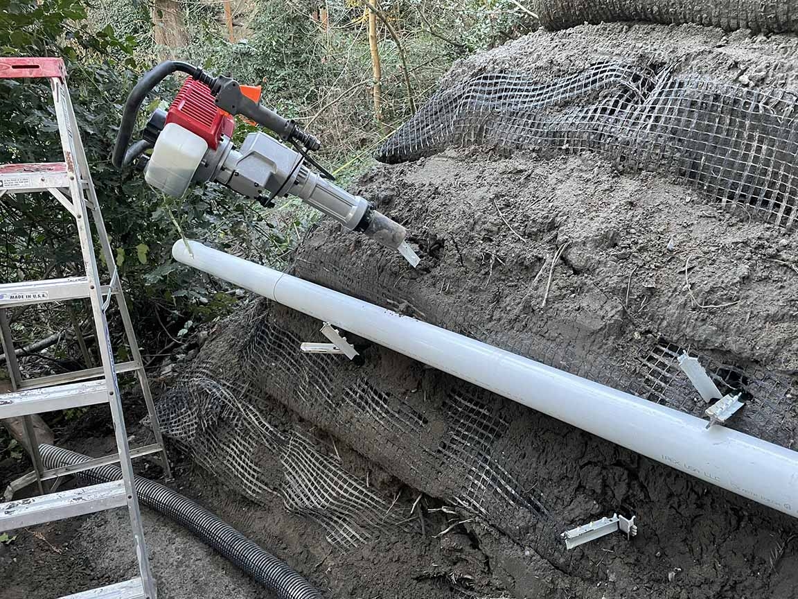

Driving 6 foot fenceposts in with a gas-powered fencepost driver.
Well they didn't just fly in.
But I think tight enough,
and splayed apart they will resist pullout.
I think this arrangement is much stronger than plastic geotex deadmans could ever be.
If I'm bored tomorrow I'll screw some of those little helical anchors in too, I'm curious.

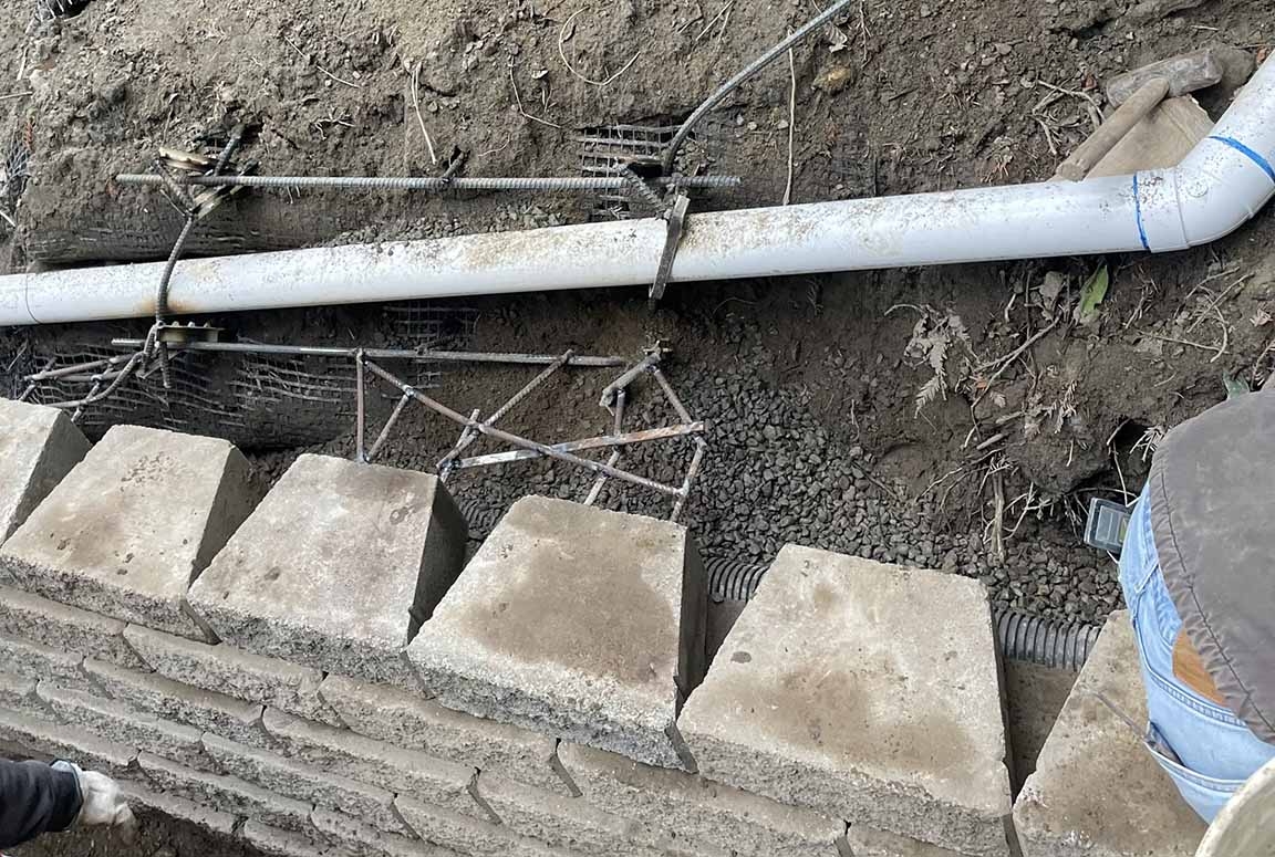

I'll weld this #5 Rebar frame all together.
That one up at the right was my "test-pole" to see how hard they drove in.
I'll attach to it simply because "I can".

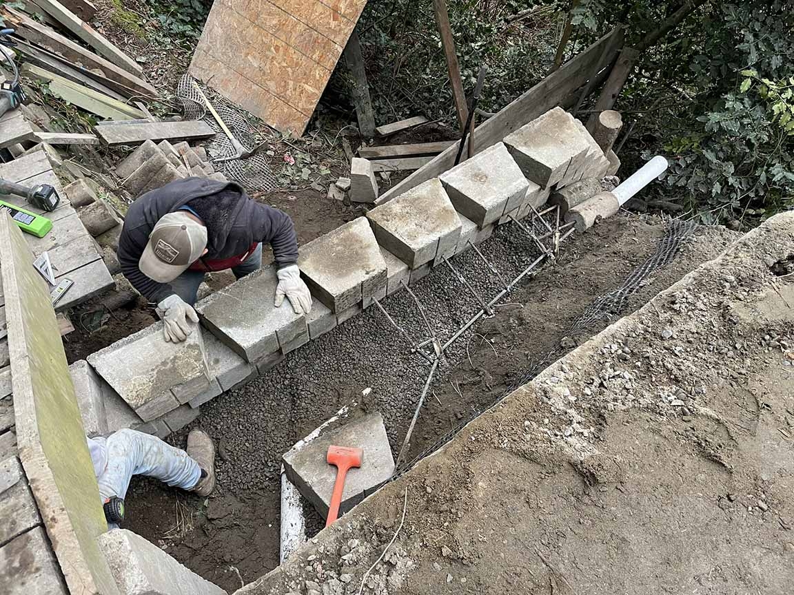

Here's 3 drilled blocks for row 6
and 3 drilled blocks for row 10.
Rebars poked thru a hole with a welded dogleg to retain it in the block.
I'll weld tie-bars from the blocks to the frame as the wall goes up.

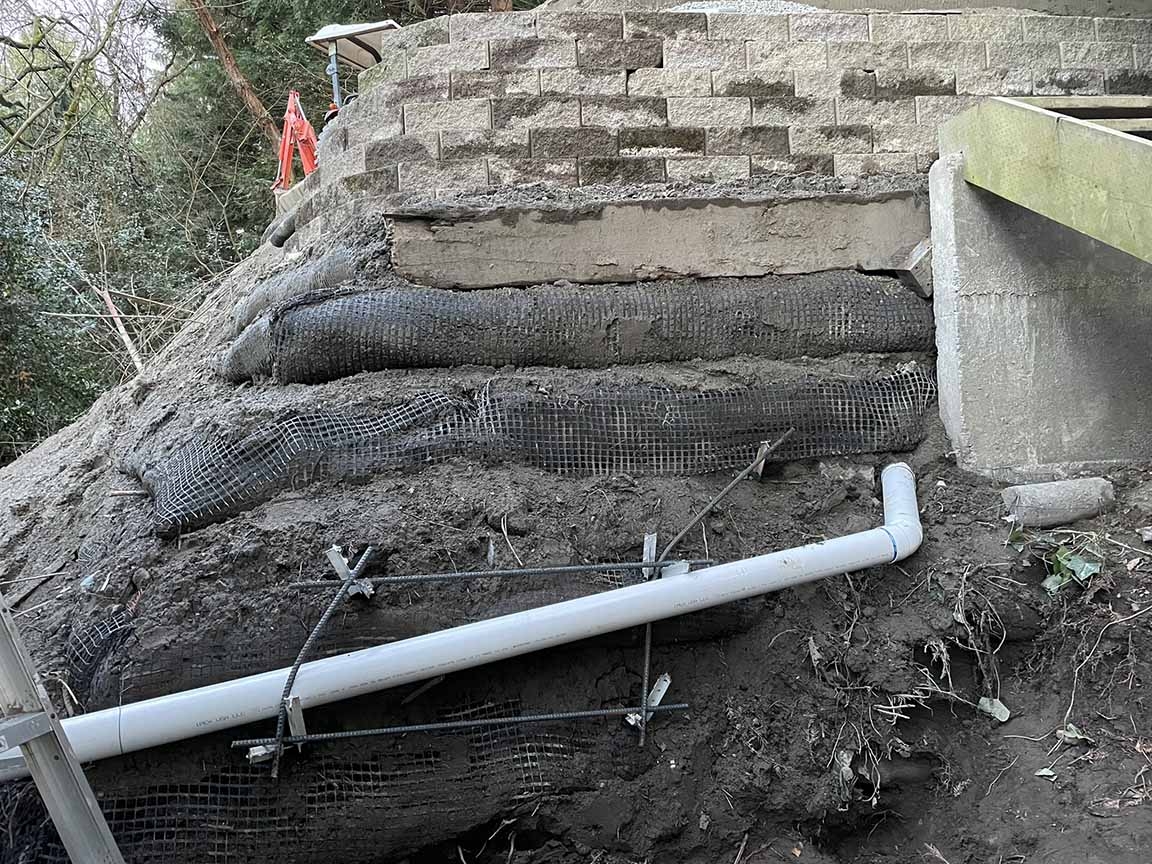

I welded the eight 6ft T-Posts and rebar rectangle together.
It's really solid.
No way in h*ll is a plastic deadman as strong as this method.
From the other buried steel I find here, I'm sure this will last 40 years and more.
I doubt this little house will still be here in 40 years though.
I lengthened a couple 2.8" helical anchors with rebar and screwed them in.
Mostly was just curious “how they go in”.
They got tangled in geotextile, but eventually got them in, and welded.
Every little bit helps (helps the overkill !)
Here's row 6, welded to the tieback structure
Here's row 9 welded to the tieback structure.
This wall ain't gonna tip over.
Just about done, and ready to backfill the dirt bank.
I'll put some of that black woven fabric over the gravel before covering it with soil.
Pavers tomorrow.
