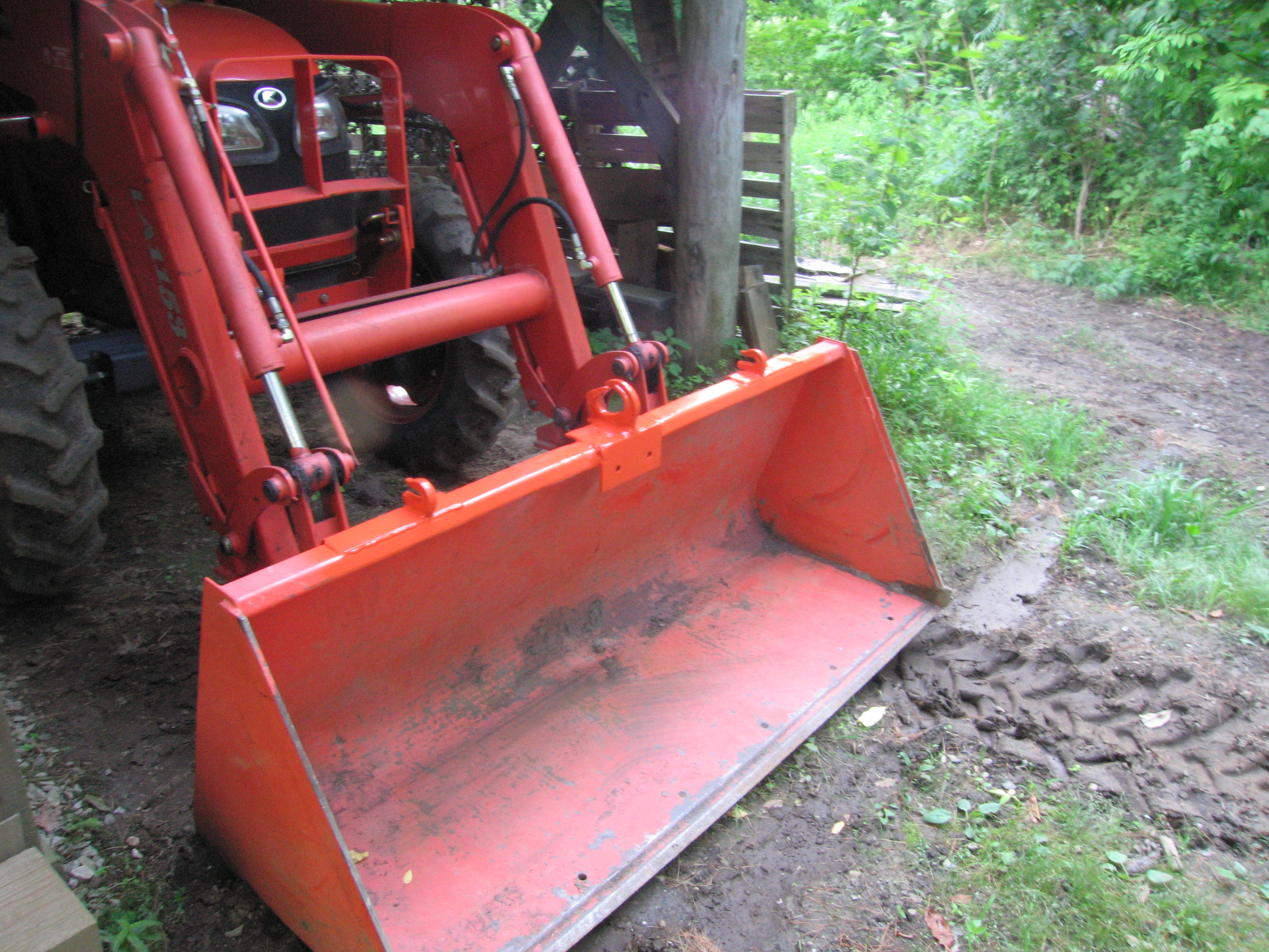

Ken, i viewed your photos of Kubota products, but none of the photos Identify The buckets by model/ part number and I don’t have a good enough photo of my bucket to compare.

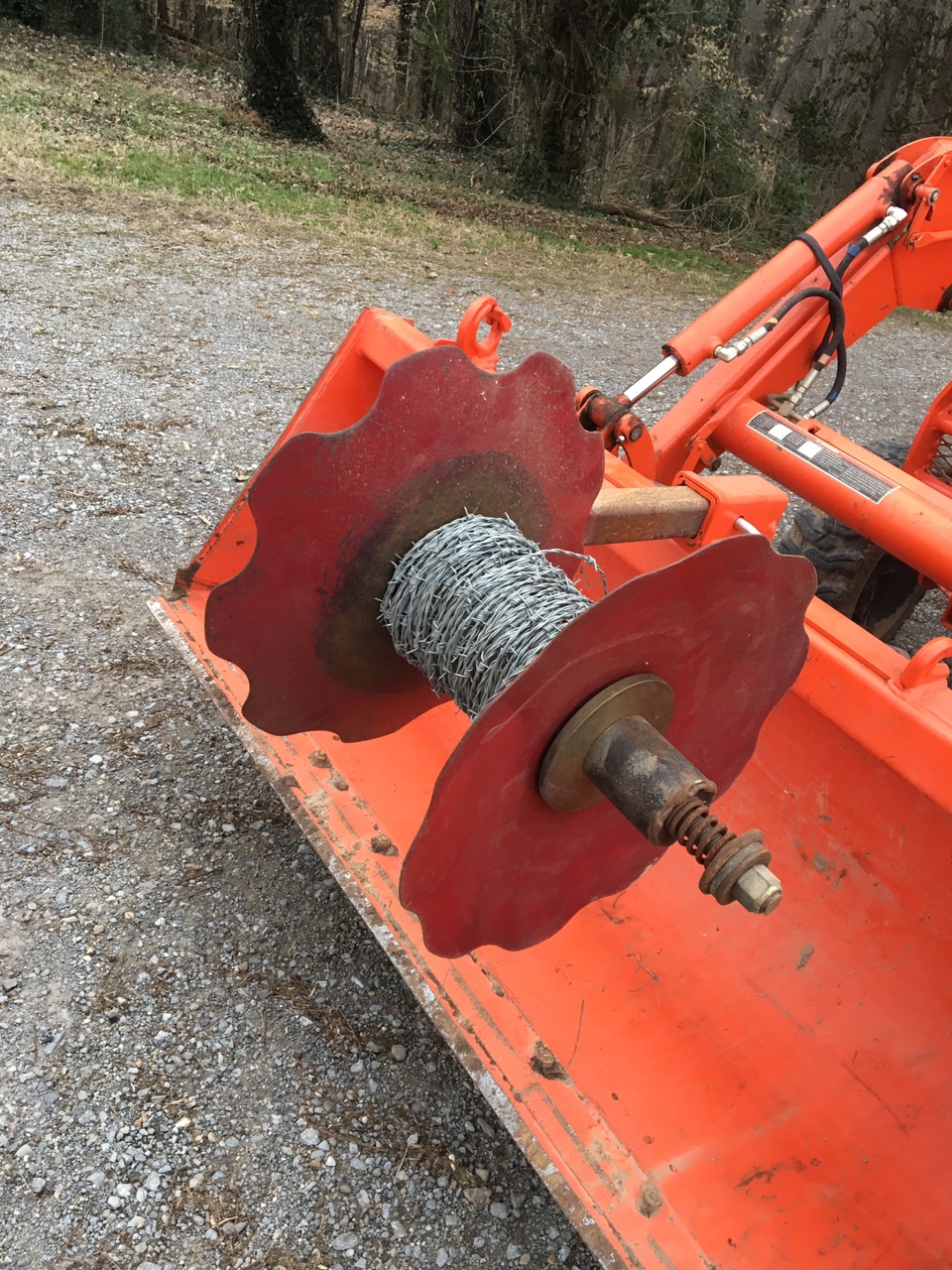

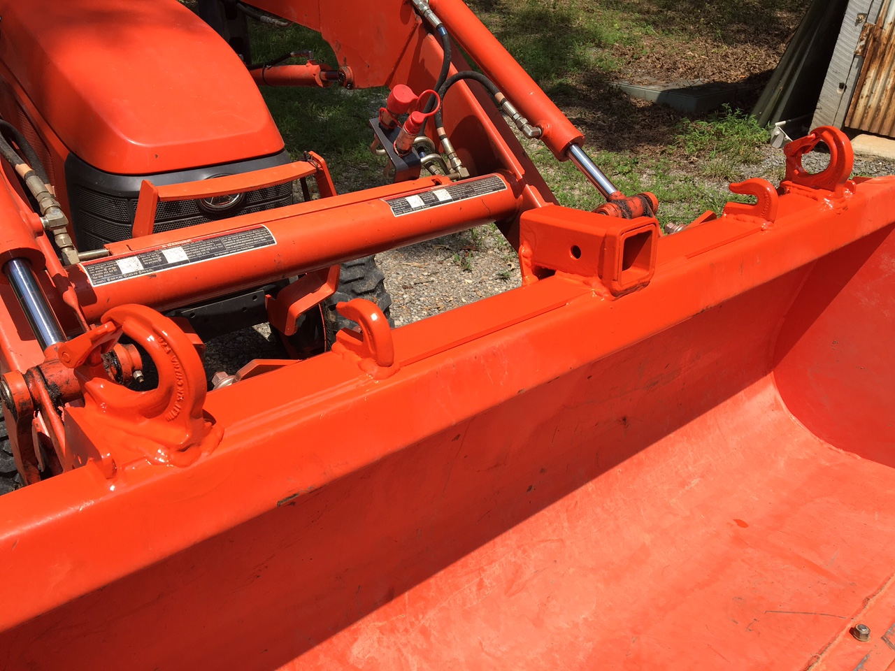

IMG_0591.JPG B26 HD bucket.
Use the receiver hitch more for
attachments than trailer hitches. Bale spear, barbed wire unroller, vise, platform for sprayer, etc.

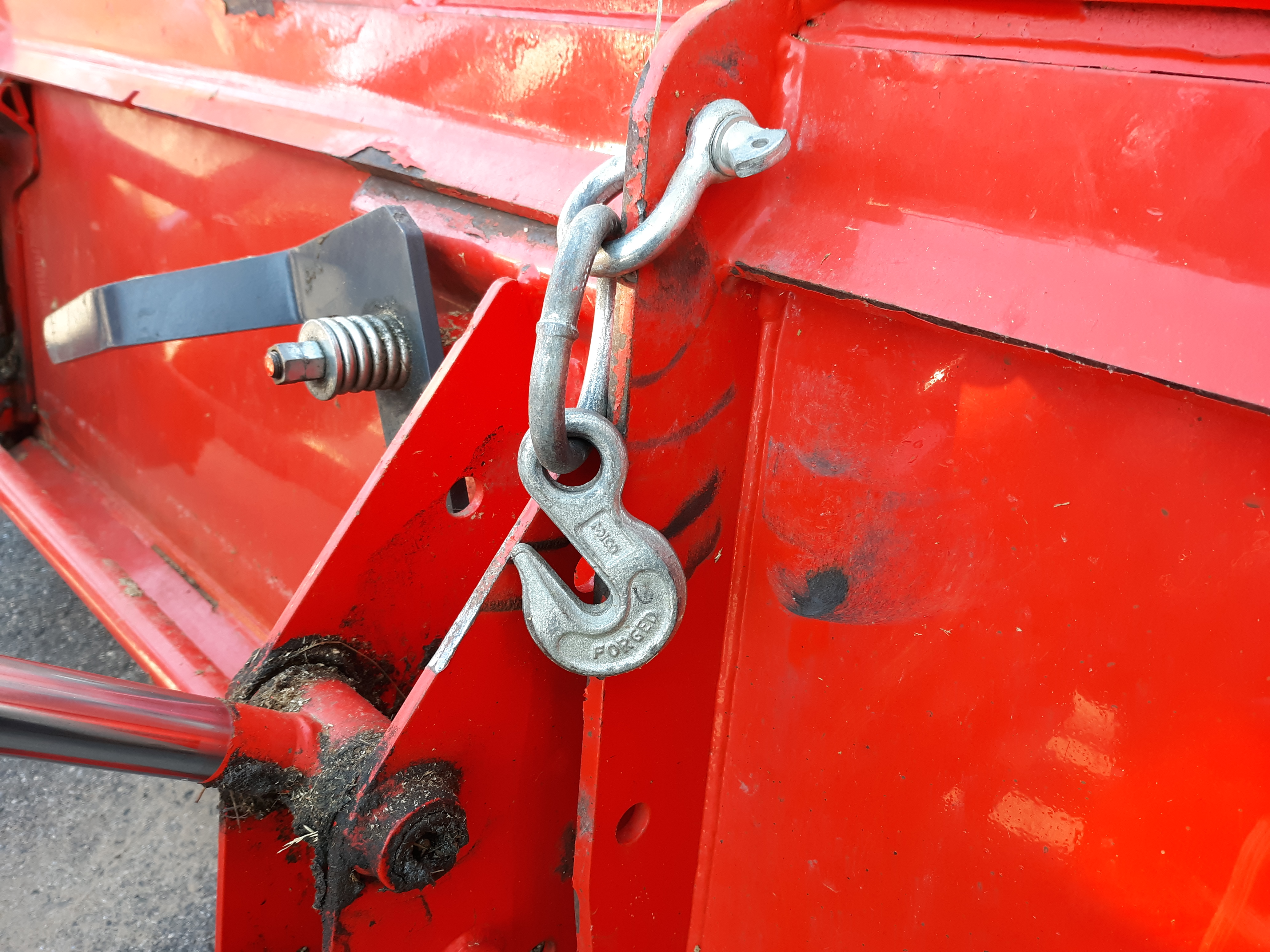

   / Who has installed Bolt On Hooks to their LA1065 bucket #14
I went this route so I can grab something from either side but have it slip/lift from the middle to keep the load balanced
#15
Peter, where did you find the oblong ring with hook?
   / Who has installed Bolt On Hooks to their LA1065 bucket #17
R and R a junk store in Hooksett Nh. I got a set and mailed them to another member on TBN was around 20.00 Pm me If you want a set...
