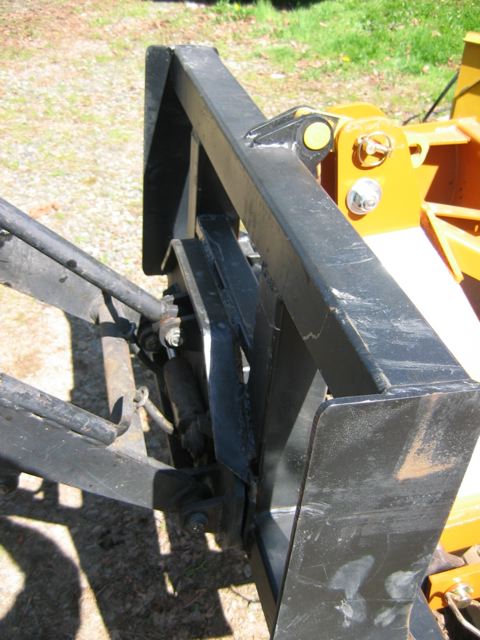

Can anyone post a picture of the Lackender adapter got 3 point implements. I contacted them and if they supply the plate, the price is almost 1K delivered. Seems quite high to me and wonder what it looks like for that amount of cash.
   / Who has a Tiller Atatchment, Opinions? #25
Here are some pix. They are not very good and I am not at the tractor until the end of the month... I am sure Ken will get you better pix before I get to...
That price quote has to be wrong, unless Steel has gone through the roof. I think mine was $425 plus $65 for the adapter plate... And cause i bought so much from him he reduced the price

Unfortunately, I just dropped mine off a couple of hours ago to a local welder to have the attachment plate removed and the correct one put on at the correct angle. This was the first one Lackender made for this size tractor and he made a mistake when fabricating the plates. Fortunately, i caught the mistake before Woodland Farms had his shipped. A friend was going to weld mine but he has been recovering from knee surgery and having a rough time of it. I finally could not wait any longer so I gave it to the local welder. I have a couple more attachments that need to be corrected as well.
