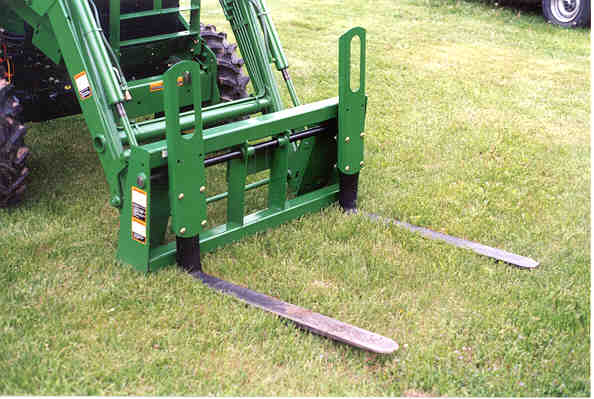

I like the simple design of the quick tach JD pallet forks and was wanting to build my own based on that design. There aren't any to look at in my area, so I need some help on the dimensions from those of you who own these. I'm looking for the following:
Dimensions and length of top and bottom square tube
Dimensions and thickness of the side plates
Dimensions and thickness of the middle support plates
Distance between the middle support plates
Diameter of the fork mounting rod
Distance from center of fork mounting rod to bottom of side plate
Height of fork to center of mounting tube
Thickness of mounting plate where loader frame attaches
I also plan to add mounting points for 3PH use and possibly a grapple. This will be my first project with my new welder - a Millermatic 210. Can't wait to get started! My biggest problem (other than needing the measurements above /forums/images/graemlins/smile.gif ) is finding a set of used forks - I have looked everywhere!
Thanks for any help you can give me!

Here's the information you're looking for. These measurements are for the JD pallet forks that fit on JD's 460 loader (I believe it's the same as what fits on the 430 loader). See pic attached.
<font color="blue"> Dimensions and length of top and bottom square tube </font>
Square tube is 3" x 3". Both tubes are 53 1/2" in length.
<font color="blue"> Dimensions and thickness of the side plates</font>
Side plates are trapezoidal in shape. Top is 4 1/2"W. Bottom is 8" wide. Plate is 21 1/2" high. Plate is 1/4" thick.
<font color="blue"> Dimensions and thickness of the middle support plates </font>
4" wide x 15" high. Plate is 1/4" thick
<font color="blue"> Distance between the middle support plates </font>
10 3/8"
<font color="blue"> Diameter of the fork mounting rod </font>
1 1/2"
<font color="blue"> Distance from center of fork mounting rod to bottom of side plate</font>
16 1/2"
<font color="blue"> Height of fork to center of mounting tube </font>
18 1/4"
<font color="blue"> Thickness of mounting plate where loader frame attaches </font>
1/4 "
Hope all this helps you out.
..Bob
