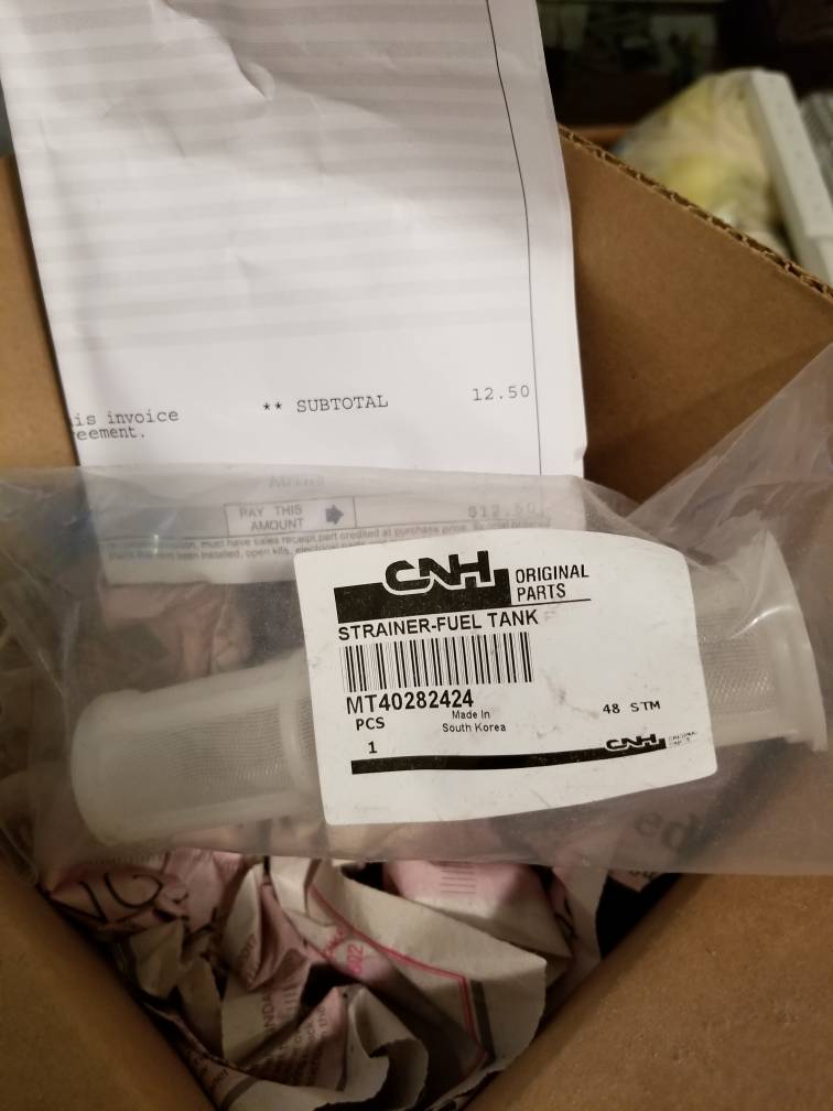

I just added an o-ring around the plastic screen, snug fit but it would take allot harder hit to pop it in the tank now.
   / White plastic screen fell into gas tank on XG3140 #24
Good info...but, but, $49 for a 50 cent strainer?
You can get one from messicks for a few bucks. Same thing happened to my screen when I was refueling and the government mandated fuel can slipped off the lip and punched the filter out.
   / White plastic screen fell into gas tank on XG3140 #25
Bought this one from Messicks. $12.50 shipped to my front door. 20180429_170602.jpeg

That certainly beats the 2/$50 from LS.
They have other stuff that will fit the XG3140. The 2017 NH Workmaster 40 is the same tractor.
