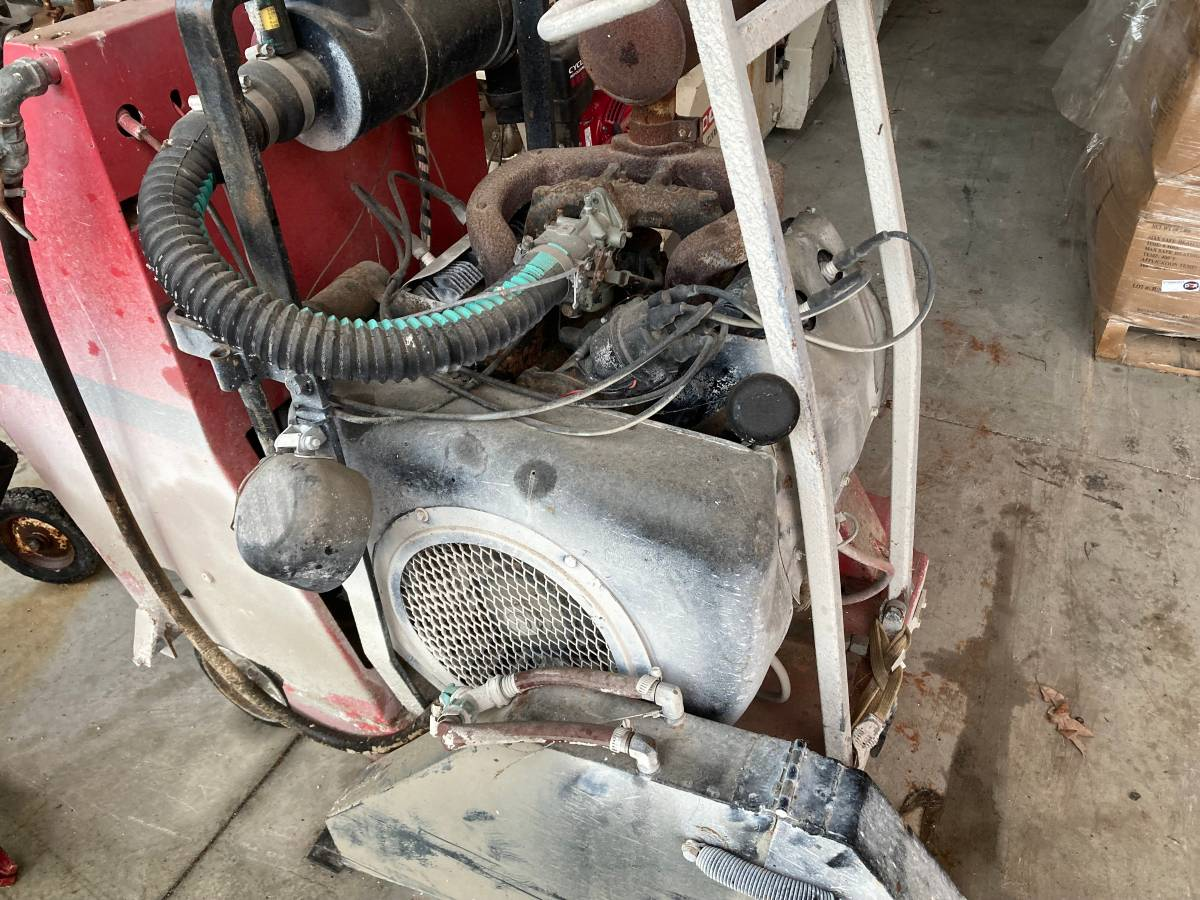

Does anyone know what model of Wisconsin V4 is pictured? I looked at my 1770 but it does not seem to have the provisions to mount a distributor in that position. Thanks.
John
   / Which Wisconsin V4 engine has distributor on top of engine under the carb?
Airbuscuit,
That looks to be the same model as it has the distributor in the same place. Do you know what model it is? Thanks.
