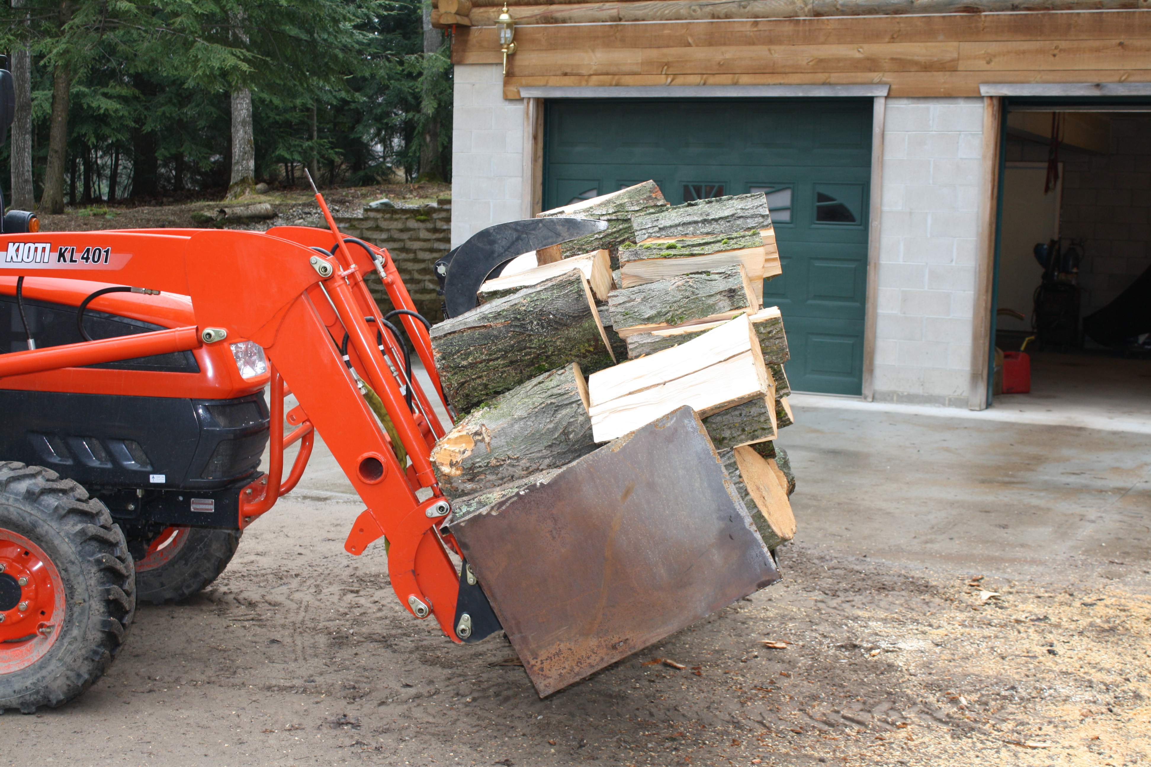

How often do you guys have a full load in your grapple? The only time you have a full load in the grapple is with brush is when you are moving a pile. You are not rarely going to get a full load gathering brush. I can get a really big load in my grapple with a 30" opening.
I think I posted this pic in this thread already.
Every time I possibly can, it will be loaded to the max and that is most of the time. grapple 006.jpg

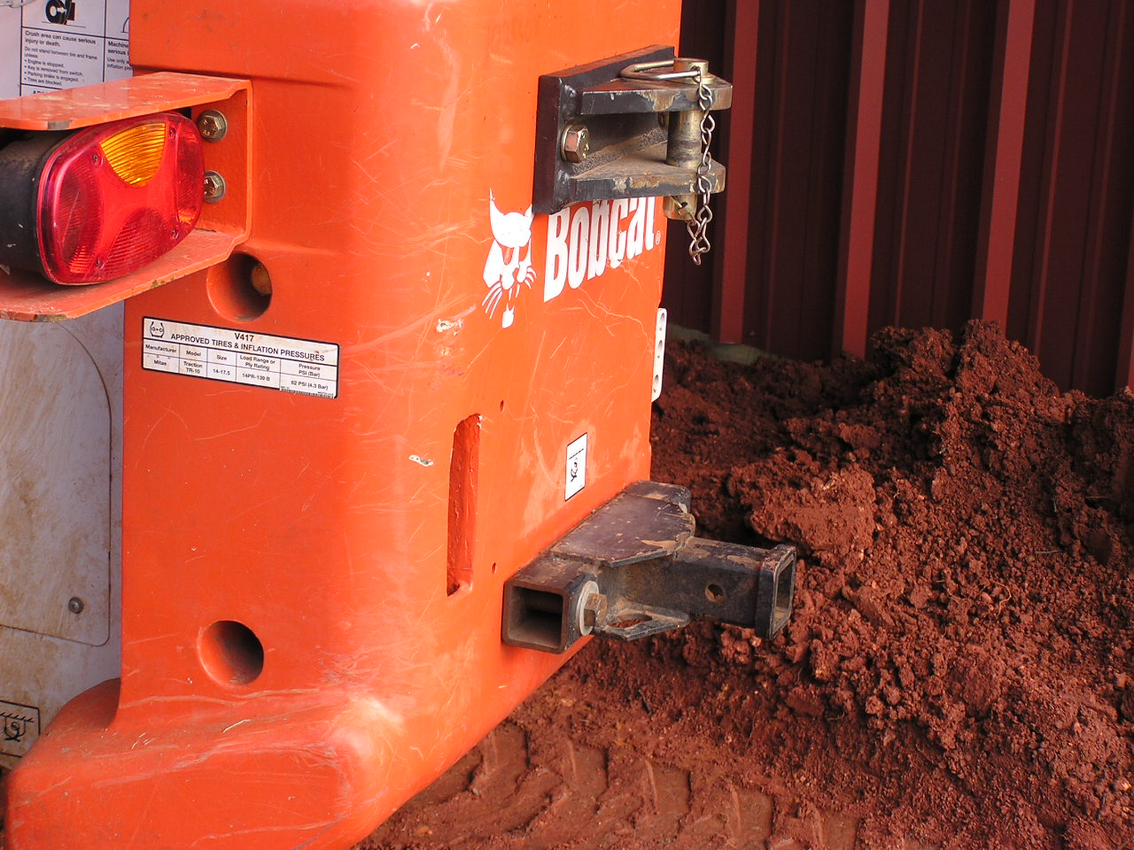

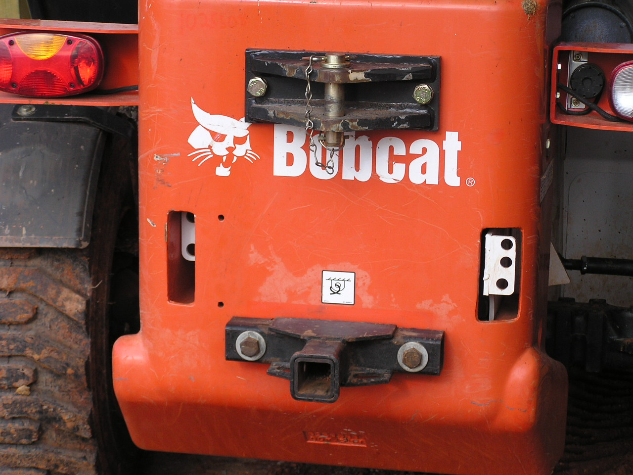

If I may thread jump a bit: I'm wondering what kind of a log skidder does a Versahandler make? Seems small enough and steerable enough to negotiate some tight wood lots.
I use it in the woods a lot, notice both mirrors are gone, replaced with cameras and a 7" monitor.
The V417 is the smallest Bobcat Versahandler, 6' wide 7.5' wheelbase, 11' turning circle, 7,000 pound drawbar pull, over 5,000 pound lift.
It has a SSQA, so most skid steer attachments will work on it.
I moved the pin hitch up and cut off a receiver hitch for the bottom.
More info here: http://www.tractorbynet.com/forums/toolcat/183057-toolcat-vs-v417.html
And here: http://www.tractorbynet.com/forums/bobcat-construction-equipment/160568-compact-telehandler.html

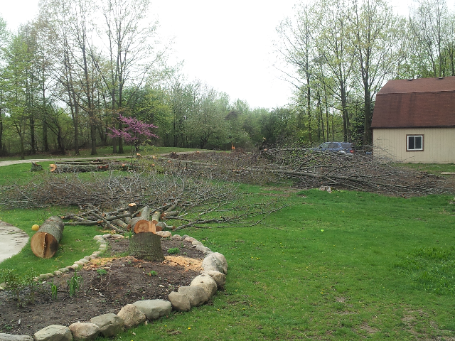

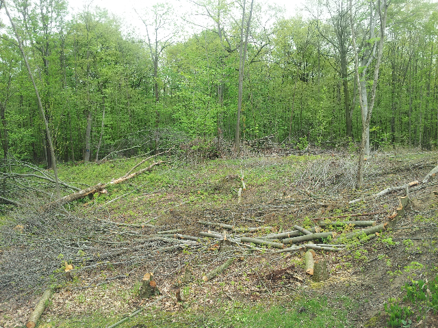

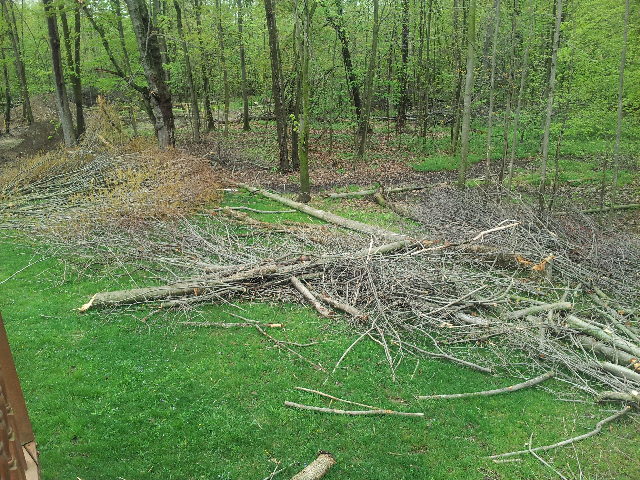

Believe me, I have no shortage of things waiting to move with it! This is just tip of the iceberg too...
<img src="http://www.tractorbynet.com/forums/attachment.php?attachmentid=317174"/>
<img src="http://www.tractorbynet.com/forums/attachment.php?attachmentid=317175"/>
<img src="http://www.tractorbynet.com/forums/attachment.php?attachmentid=317176"/>
Stop wasting your time with a chainsaw. Get a ripper and take those trees out whole rather than being left with a nasty stump. Checkout the ripper thread from a year or two ago.
