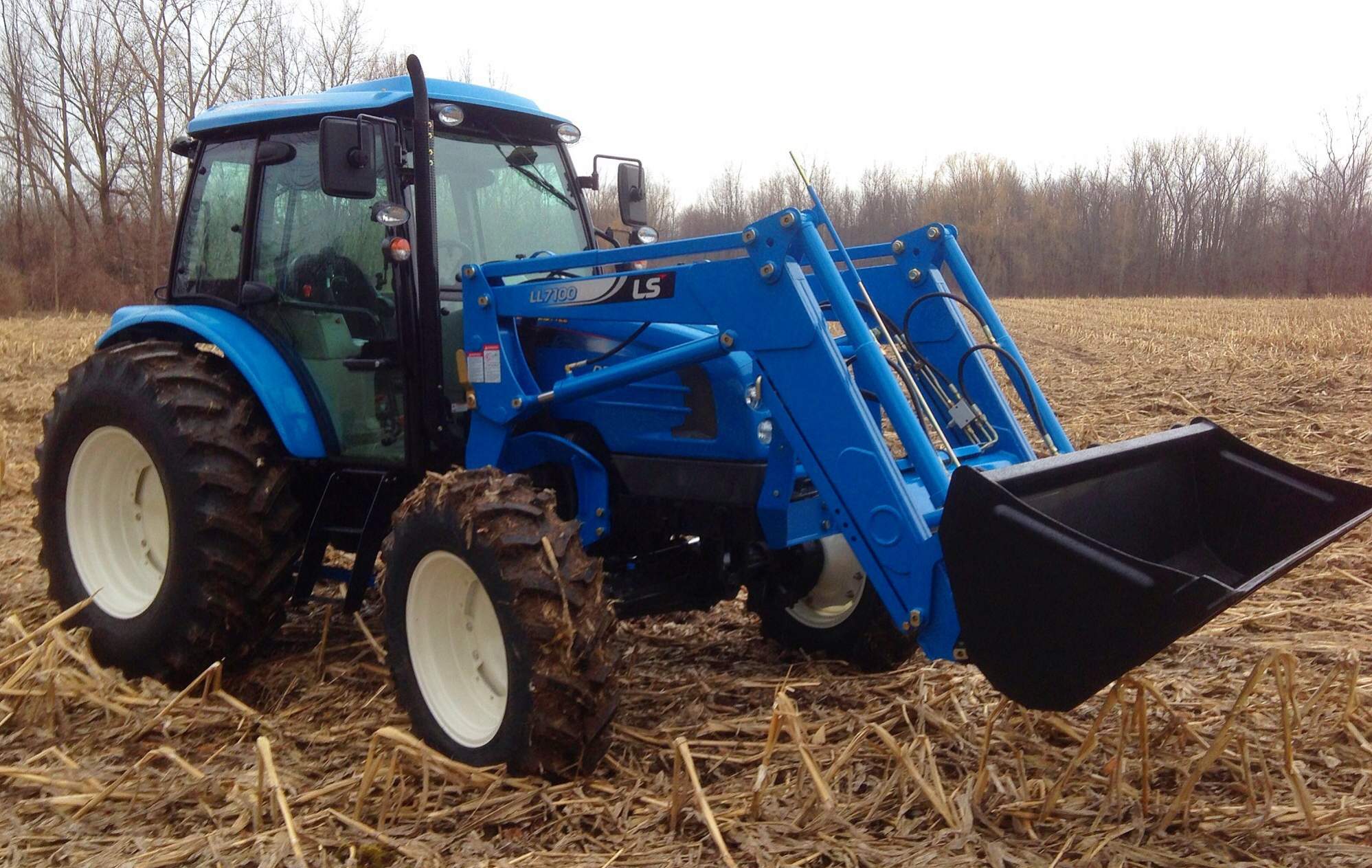

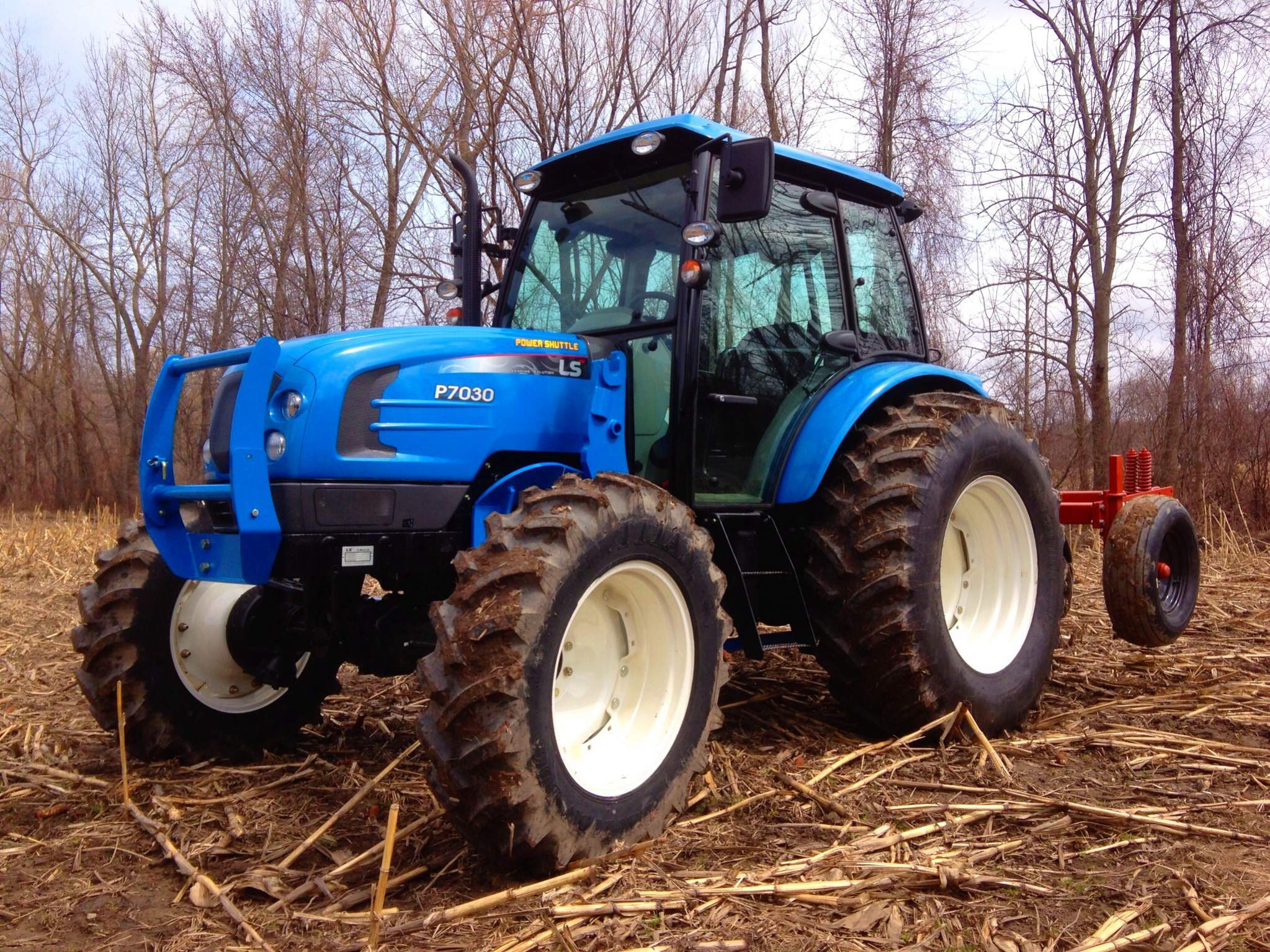

50k for a tractor with 12 speeds, no creeper gear, no hydraulic hi-lo and 540 only pto? Hope you don't do much mowing, haying, baling, plowing, discing etc. You won't be happy if you do.
   / Which Tractor to buy? 4720cab,5055ecab or 5065mcab #17
I agree, some of those features would be great, Just cost you about 10k more. I love of the features of the LS, just couldn't get past the looks and lack of weight.
   / Which Tractor to buy? 4720cab,5055ecab or 5065mcab #18
When I was shopping, I was looking at the 5075e and that tractor weighs 1000 lb less than the LS and it cost 10k more than the LS. If you have to own Green so be it.
IMHO regardless of brand, only 12 forward speeds on a 50k tractor is absurd with no ability to upgrade. If you are not doing ground engagement work, mowing, bailing etc than it might be ok. If it had a 540/750/1000 pto you could make up for some of the lack in gearing, but it doesn't.
I would make sure before laying down your hard earned cash the tractor will do what you want, that's all.
And I think my LS isn't that Ugly! :)
   / Which Tractor to buy? 4720cab,5055ecab or 5065mcab #19
I think your LS compares more to the JD 5085. I agree compared to the JD 5075, The LS is far superior. Step up to the 85e and your in a completely different tractor. The e-series has enconmy 540/540 and you can get 1000 pto. When moving heavy loads(loader work) or pulling heavy equipment you will appreciate the extra 1300 pounds. Also the hydrulic output is much better on the 85e. Not taking anything away from your tractor, Its one **** of a tractor for the money. I dont have any LS dealers close to me, that was also a big factor of over looking them. Love the pictures, I think it its growing on me. Its those **** front headlight I cant get over. lol
