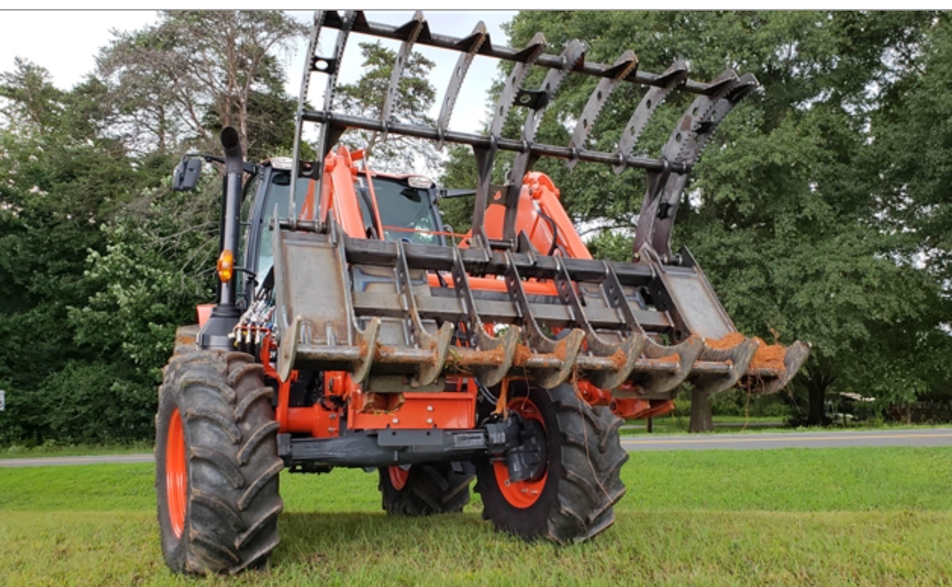

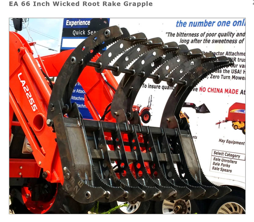

Which grapple do you have? Mine has short lower tines, more of root rake design, many have longer lower tines for carrying/scooping. My thoughts are short tines shorter than bucket gives you more leverage to tear things up. It weighs 600# much more than a bucket. Also it is 66" wide Ar400 steel so less twist on FEL frame and tougher than a bucket. So that how I plan to strip the area of foliage small trees roots and not move a lot soil. When top foliage is gone then I want to score the clay couple inches at time to move it to a new location. When I hit occasional flint usually they are soft I hope stab and break them, then roll them out. With old tractor I used a sod buster, box scraper with tines, then a soil scoop. It worked but was slow. But I moved many cubic yards when I could not afford truck loads, or had to improve drainage. Now I want to line tools up and just get out of the AC cab to change them. Older and fatter

Good plan. EA makes good stuff. 54” wicked double clamp, long bottom on the B26, 72”, T1 steel skid steer grapple on the M59. It’s heavy but strong. 20+years old and bunch of hours. Back when I got it I had weld a bobtach yoke to my M5030 loader frame to use a grapple. They share use of a Danuser Intimidator grapple too. After grubbing trees and clearing miles of fence lines for decades I’m all for making life easy now.

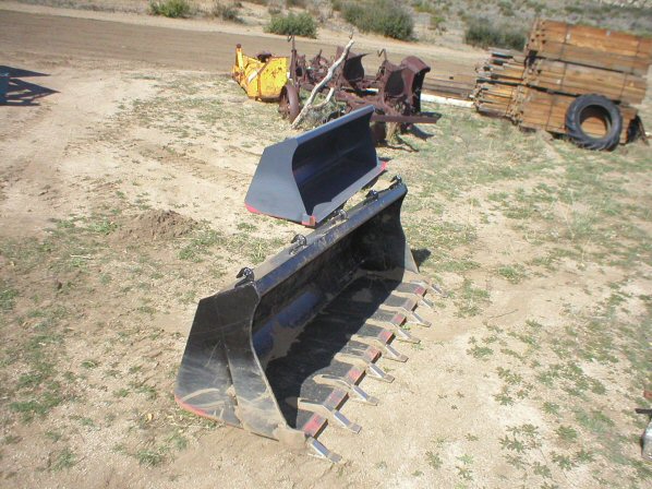

I have an 84" material bucket and a 78" digging bucket for my 75 hp tractor. The digging bucket is on most of the time. ;)
