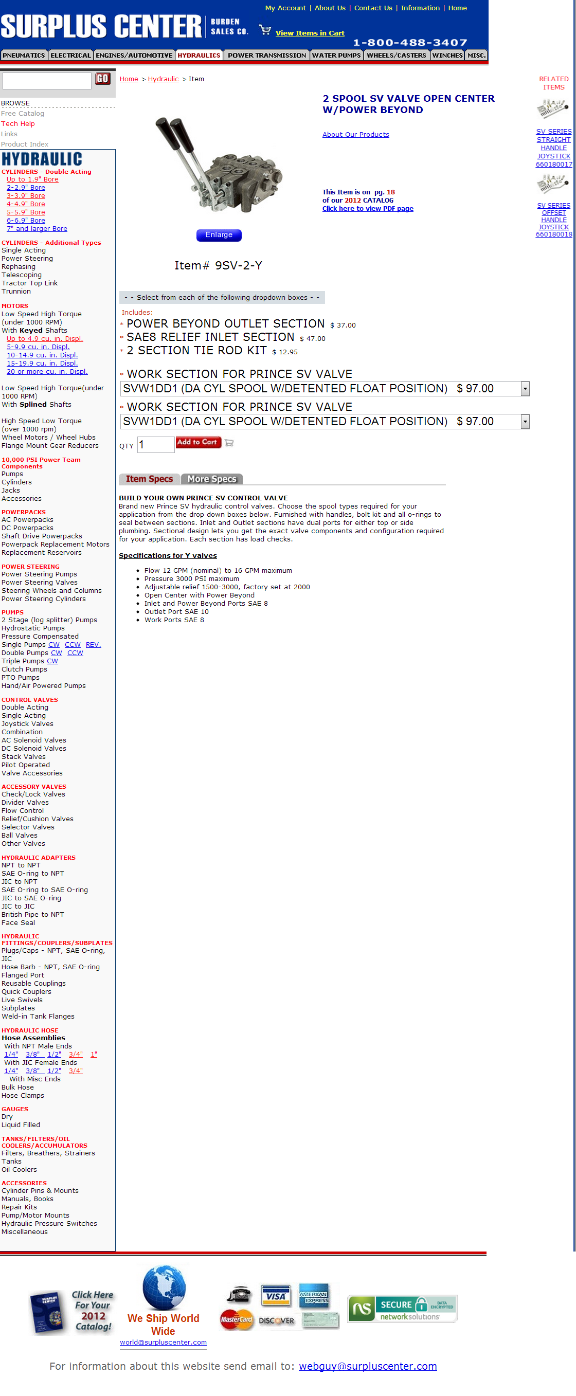

Hey guys, first post. Thanks ahead for all the info. I've been reading alot from the forums on rear hydraulics, power beyond and top and tilt kits. I'm really interested in adding a top and tilt kit to my Kubota L3700SU. I have basic understanding of hydraulics and thanks to the forums, have figured out the power beyond concept. I am in the process of gathering parts for a top and tilt kit for my tractor and was looking through all the spool valve at the Surplus Center. Any recomendations on which 2 Spool valve would be best for my particular tractor? Thanks again.
   / Which spool valve? #2
Maybe this one. I prefer stacking valves, easier and cheaper to add more valves in the future if-when needed. I would get both valves with the float function. Always nice to have float when needed vs needing it and not having it. ;)

2 SPOOL SV VALVE OPEN CENTER W/POWER BEYOND
Item# 9SV-2-Y
Components:
- SVW1DD1 (DA CYL SPOOL W/DETENTED FLOAT POSITION) #PSV D SECTION
- POWER BEYOND OUTLET SECTION #SVE22
- SAE8 RELIEF INLET SECTION #SVI15
- 2 SECTION TIE ROD KIT #660401002 $290.95 in
$290.95

J_J, do you think these valves are okay for a L3940 with total hydraulic flow of 14.7gpm. The valves are rated at 12gpm nominal and 16gpm maximum.
Thx.
   / Which spool valve? #6
You will not notice much difference as most tractor owners don't run their tractors at max rpm anyway.
You don't have to get stacked valves if you only need one spool with float. A monoblock valve will work. , and less expensive.
   / Which spool valve? #7
Thx.
You are only running the implement pump flow through any of the remote valves. For your tractor that is 9.8 GPM. You would have no problem at all.
I typically recommend stacking valves because it is sooooooooo easy to add more valves at a very low cost in the future. Once a person realizes how easy and efficient hydraulic functions can be, they often want more. JJ is correct though, a monoblock valve is less $$$ if that is all that you will ever need. ;)
