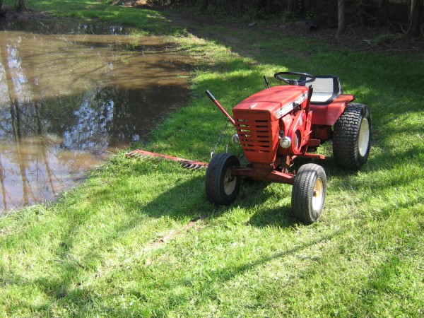

Sicklebars are more expensive and maintainance intensive than rough cutters, but there are certain conditions in which the sicklebar is preferable: harvesting, getting under fence lines, etc.
Also add mowing steep banks and around ponds.
I'd like to find a great deal on a 5' sicklebar mower for my BX23 but the 50" on my little 876 does a pretty good job reaching where my finish mowers won't. Plus it's cut my weed eater time dramatically, my back really likes that :D
