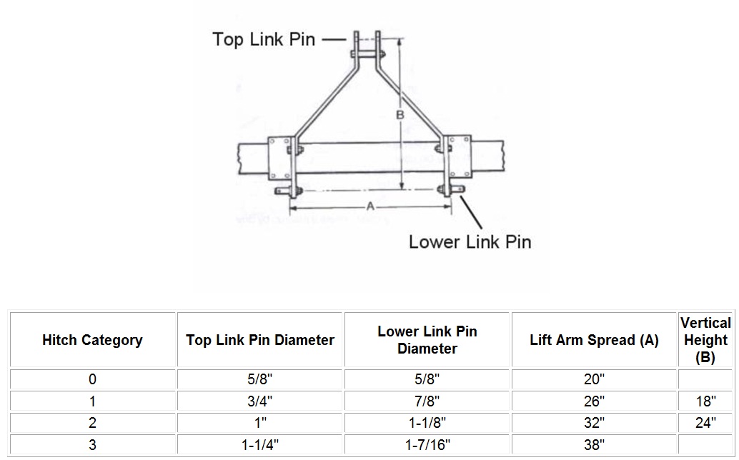

According to Phil's Tractor Sales, your tractor has a category 1 three point hitch.
The Harbor Freight Cat1 Quick Hitch should work fine. You may need to then modify your implements, even if they are category 1. Manufacturers of category 1 implements do not always adhere to the standards of the industry.
The standards that are set forth by the industry are shown in the attached image. The measurements of the Harbor Freight Cat1 QH are given here.
Inside Dimension of Lower Hooks 27 1/4"
Outside Dimension of Lower Hooks 29 5/8"
Width of Lower Hooks 1 3/16"
Good Luck with your project. There are several threads here discussing useful modifications you can do with your QH.
