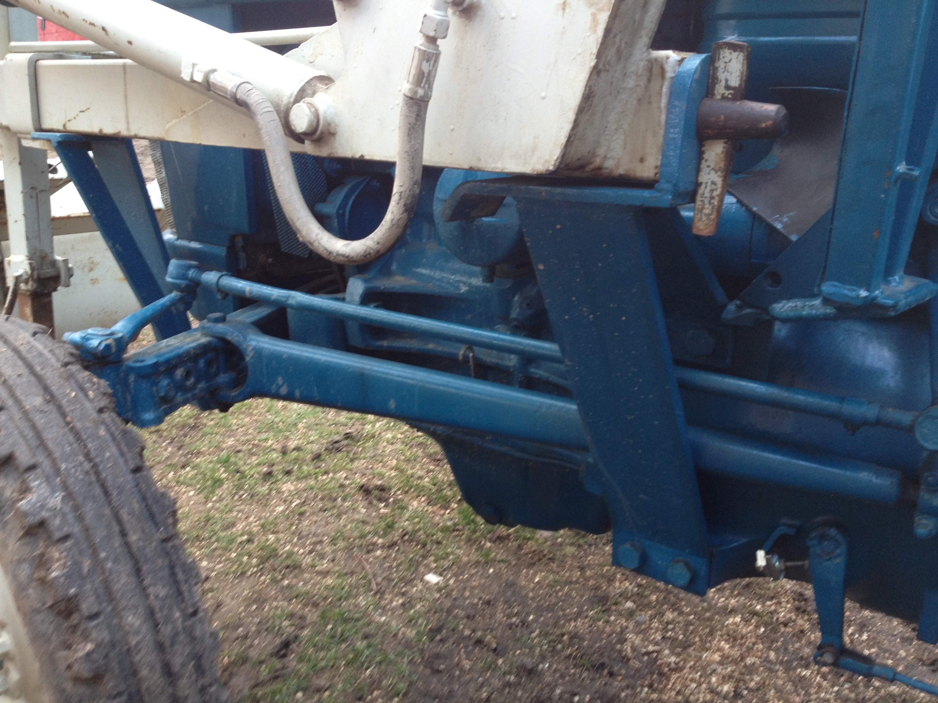

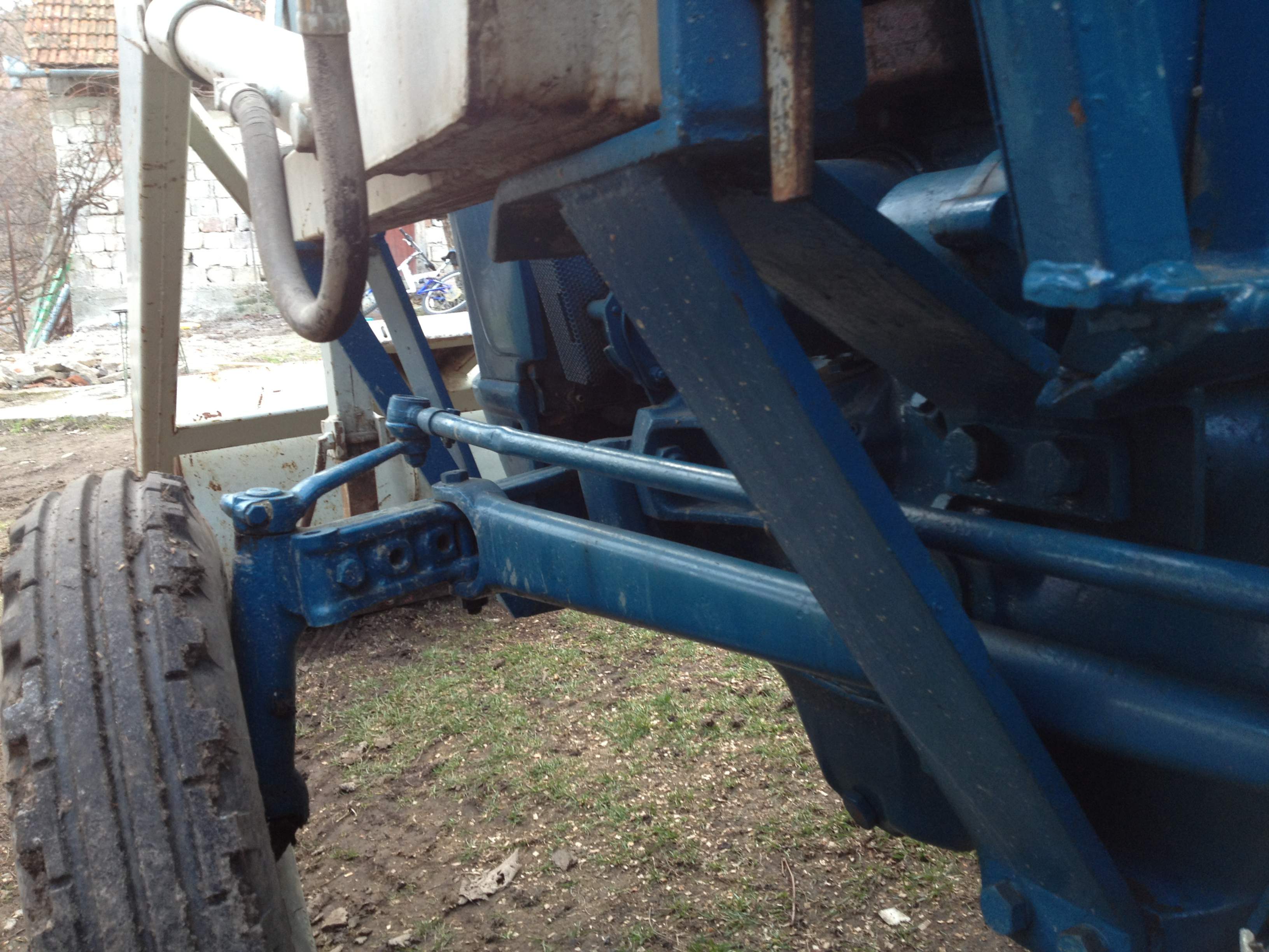

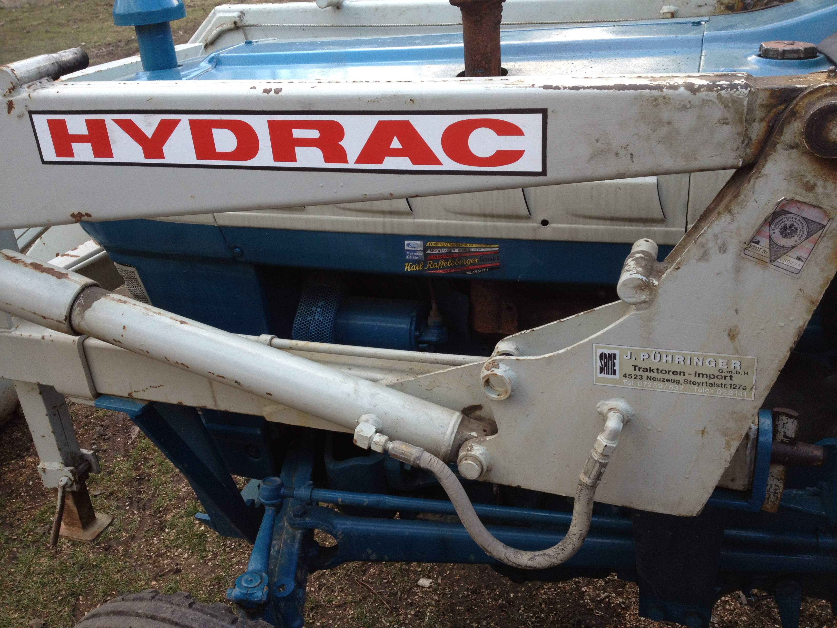

I have been searching for a power steering kit to buy to help me steer my Ford 3000. My tractor has a front loader. In my searching most kits that I find state " not recommended for tractor with loader". Any help in which power steering kit I can use with the loader would be much appreciated.

There is only one kit that I am aware of, it is just available from many, many sources. The reason it is not recommended for use with loaders is that you may or may not have clearance issues. What loader do you have?

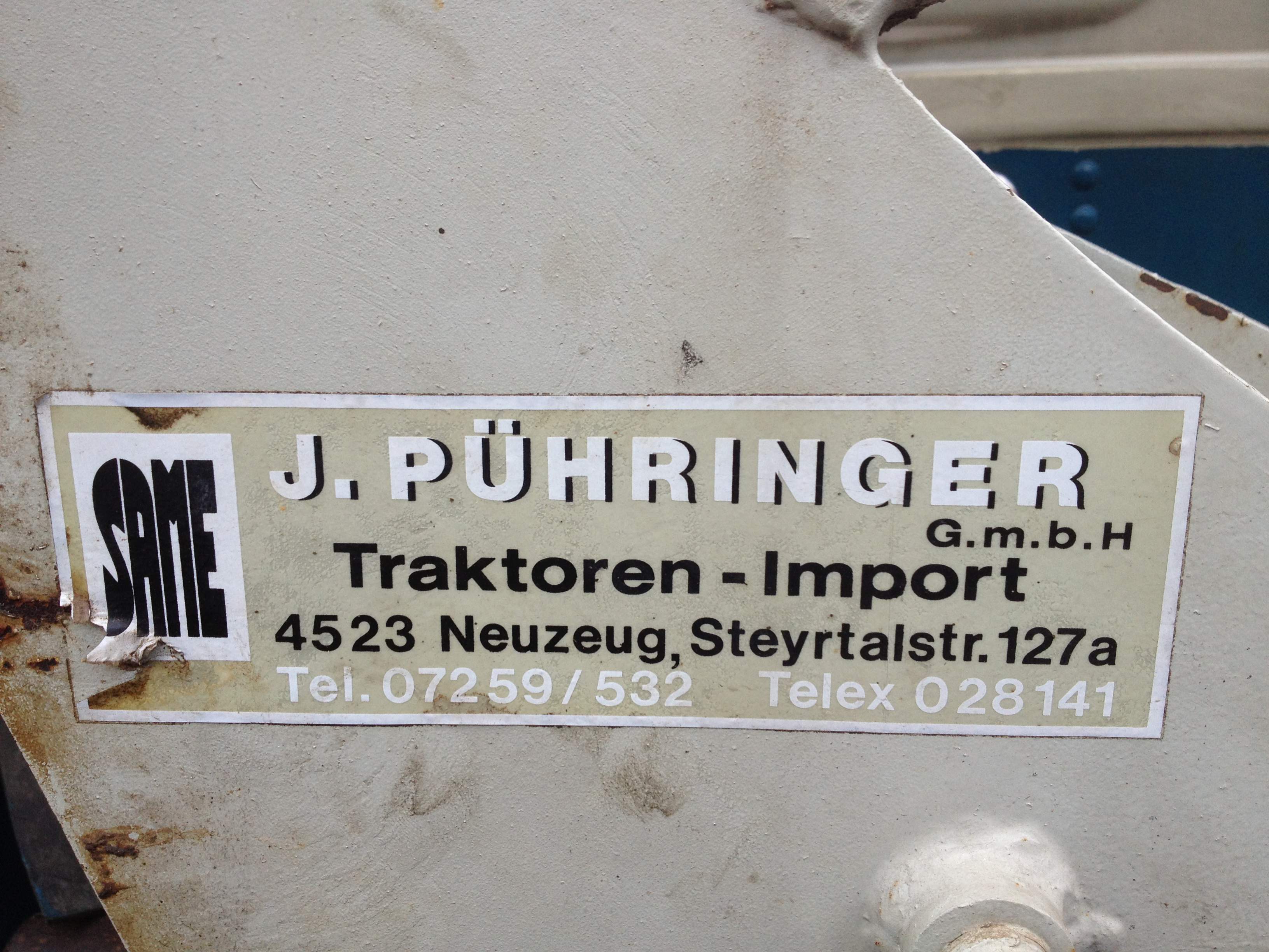

A picture is worth a thousand words.....looks like it is made by Same.....
Is the clearance problem at the Hydraulic Cylinder Mounting Plate to transmission housing and the hydraulic cylinder itself?
   / Which power steering asst. kit to buy for Ford 3000 WITH loader #5
Looks like J_J sent 3 links to the same kit offered by diifferent sellers. Seems like there will be a conflict between the cylinder and LH loader mount.
yeah....it is hard to say with out the cylinder in hand. Surely I would have to modify the cylinder mounting plate at the transmission housing.
