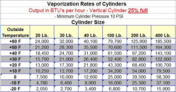

A lot depends on the ambient temperature. I used to do a food booth at a craft fair. We found a wonderful 6' cast iron griddle, and found that a 20 lb. tank would not provide enough gas, so bought a 100 lb. tank. There was no room for a 100 lb. tank under the grill, so we dug a hole and set the tank in the hole. Of course, it iced up. When we dug the tank out it, the dirt around it was a solid block of ice. Keep a heater on that little 20 lb. tank and it will work fine. Otherwise, the propane cools by evaporative cooling until it won't evaporate any more. A larger tank has more surface area, so the propane stays warmer, but if you plan on running a propane generator in sub-zero weather, some means of heating the tank is a good ideal. A system that tests fine in the middle of the summer may starve and die at 10 below.
Good post.
Here is a chart showing available Btu's, tank size and ambient temps.
