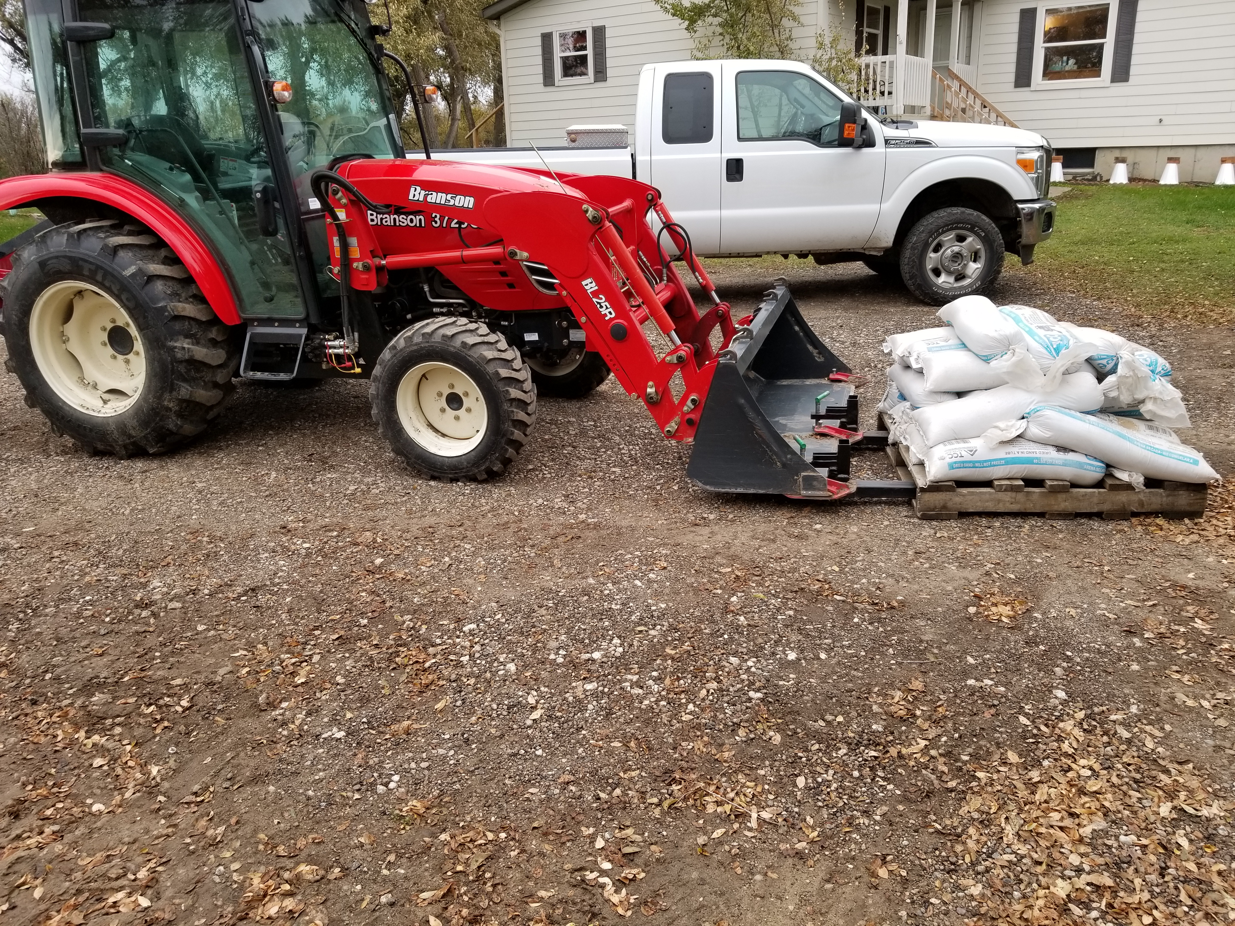

Ironically enough, I had to move a pallet of sandbags this morning to get the lawn furniture put up for the winter. So, I took a quick couple of pics to illustrate a couple of the issues with clamp on style forks.
This will illustrate how far forward of the pivot pins the load sits when moving pallets. That is 22 bags of sand weighing 60 lbs each, plus the minor weight of the hardwood pallet itself. So, 1320+ pounds, but the center of the load is over 3 feet (closer to 4 ft) in front of the pivot pins. The pallet is sitting on the forks at an angle because it was actually all the way into the corner and I had to come in slightly angled to grab it.

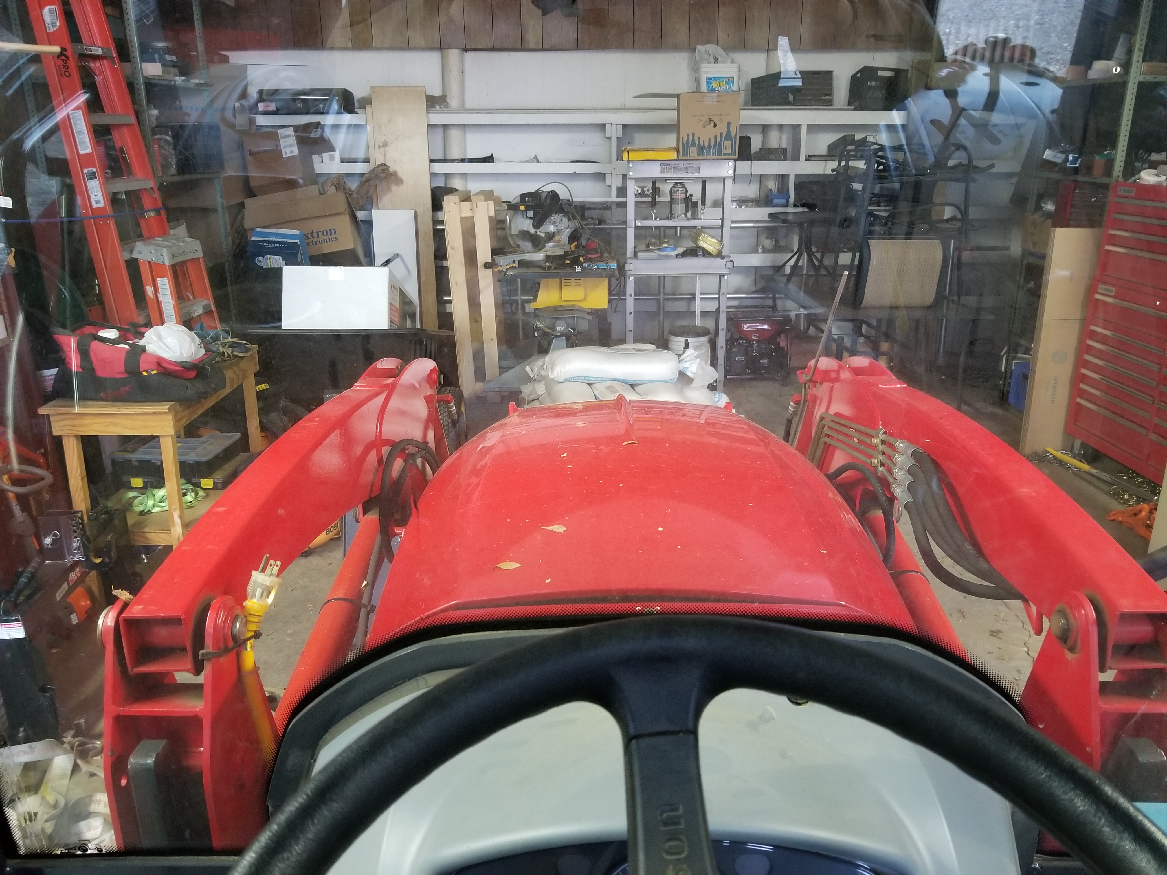

Here is the pallet just off the ground. Notice the blocked line of sight to line up "the shot" of getting the forks into the pallet. A tall guy can kind of see over the top of the bucket when it's down at ground level like this. But if I was trying to stab a pallet that's on a truck or trailer, forget it. The bucket entirely blocks the view of lining up the shot, and a spotter is mandatory. In this pic, I'm putting the pallet of sandbags back in the garage, as it's not winter enough to need the ballast in the pickup yet. So I'll still have to come get this pallet later and set it in the bed of my truck. Hope to have my new forks by then.
