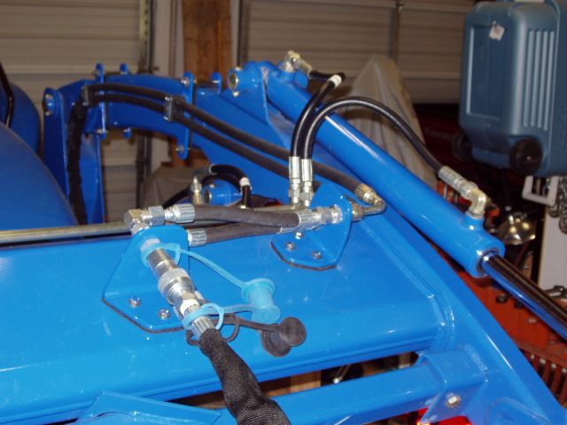

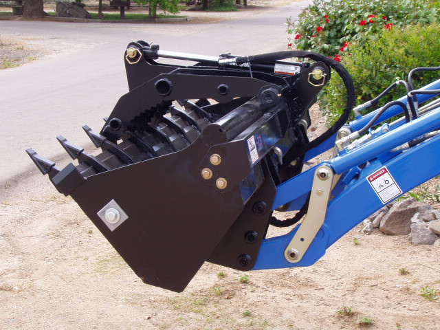

Hey,
thanks for all the good tips as I'm sure I'll need all the help I can get . I see the grapple has hoses on it.I plan to run hoses from the rear under the tractor up on one of the loader arms to where the hoses can reach the grapple hoses with the grapple tipped down all the way. Is that what some of you did when running off the rear remotes?
   / Which one would work better? #12
I love everyones useful tips on here! :)
   / Which one would work better? #13
Hey,
First photo shows the 3/8" hydraulic hose with 1/2" QCs on two bulkhead fittings at the bottom right of the 12 gauge shotgun scabbard. I need this disconnection to remove the FEL.
Second photo shows hose routing on the FEL arm and two ninety degree bulkhead fitting turns on the FEL cross arm, the last one has a 1/2" QC to remove the grapple.
Third photo shows the 3/8" hydraulic hose loop required to open and close the grapple with full up and down bucket curl.

I did buy it, just got it today . It's still in the shipping crate . I got the 5' and it looks to be really rugged. It only took 4 days to get to ME. from TN.
I'll be taking it out tomorrow to get a better look . I'm planning to use my rear remotes , so I still have to get my hoses to hook it up and will be trying to find out how long they need to be . I'll try getting some pic's on tomorrow.
I'm not going to sleep all night :D been wanting one of these forever.
