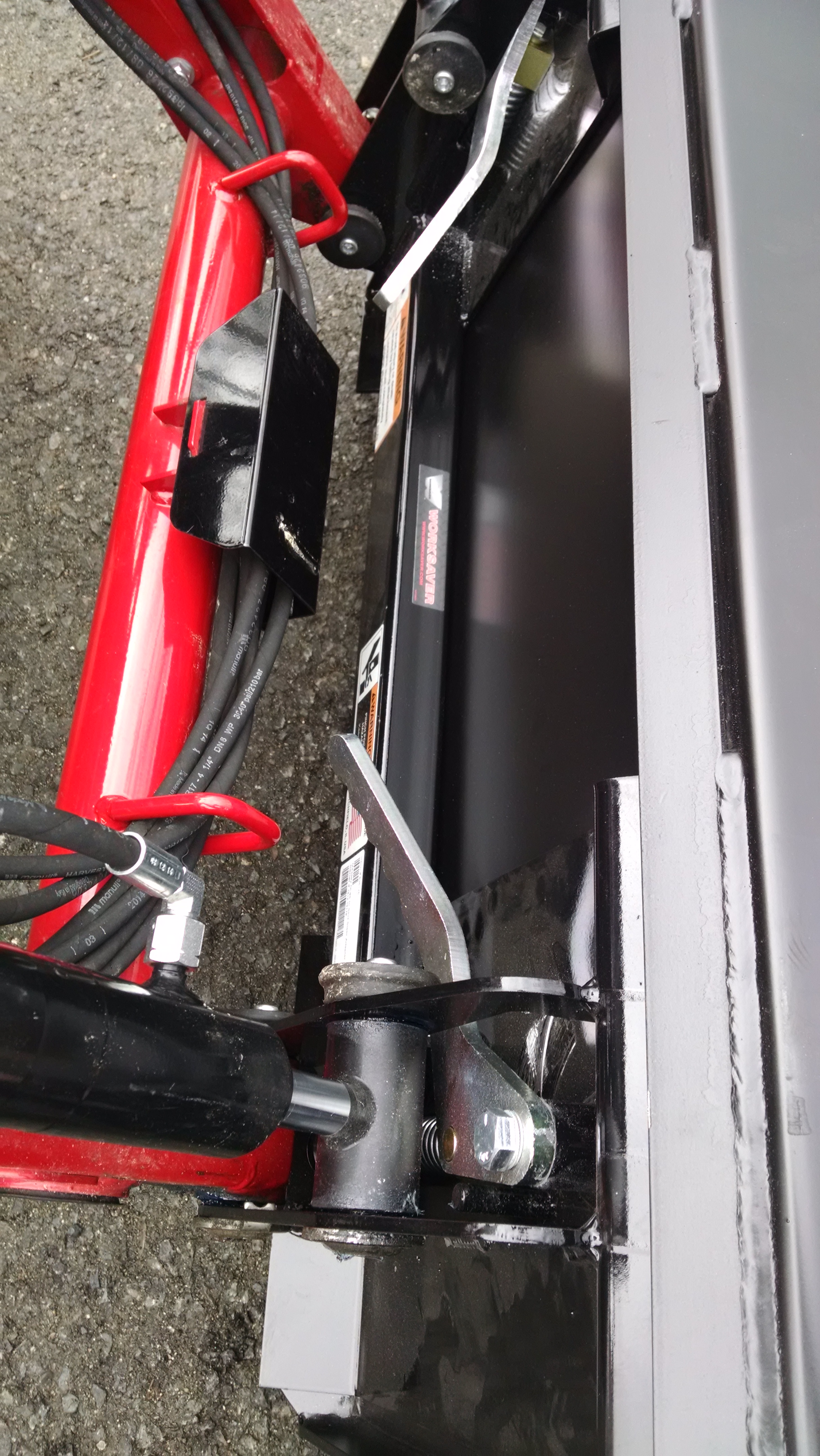

I installed the worksaver SSQA. Very nice rugged unit for the GC.. I go from the bucket to forks back and forth enough to have spent the $600 I paid for it, Best thing I have done to my tractor.
   / which one, JD 1025R or MF GC1720 or MF 1526 with woods backhoe or NH25s #26
Atsah,
I've never heard of the worksaver ssqa. How much does the QA weigh ?
I've really enjoyed mytractortools.com quick attach as it allows me to switch units very quickly as well as provides a 2 inch receiver.
   / which one, JD 1025R or MF GC1720 or MF 1526 with woods backhoe or NH25s #27
Atsah,
About 85lbs.. 3/4 of the way down the page is the model for our GC's..
