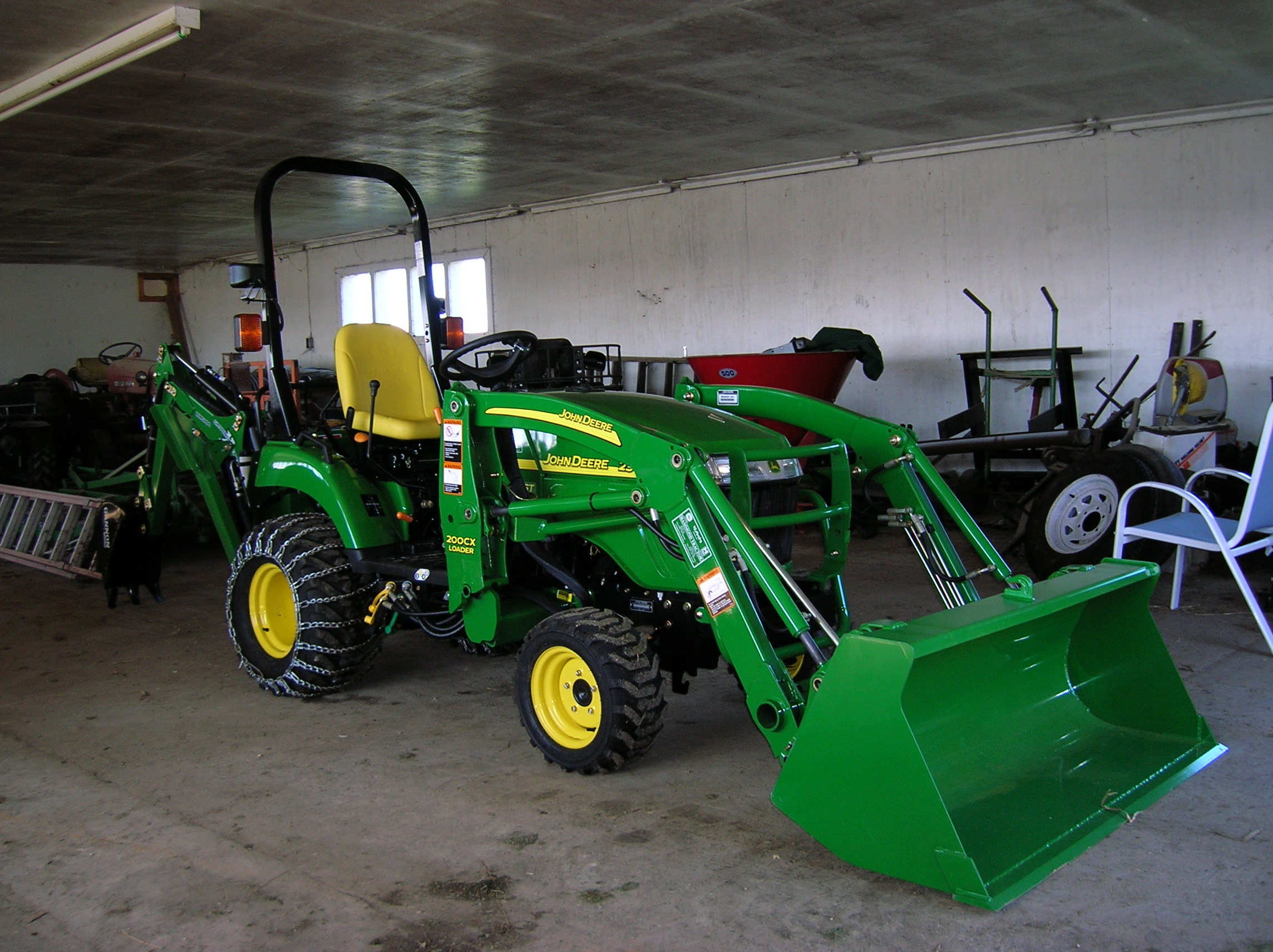

   / which one, JD 1025R or MF GC1720 or MF 1526 with woods backhoe or NH25s #94
This was my 2305 with a Woods backhoe..

#95
Looks nice. Thanks for the pix, nice tractor shed. Is the woods better than the JD backhoe?....or maybe JD didn't make a back hoe for this model?
And you ofted it because of problems right?
   / which one, JD 1025R or MF GC1720 or MF 1526 with woods backhoe or NH25s #96
I Think I bought it in 08, JD didn't make a hoe for it yet, I think they started the TLB with a 263 hoe or something like that a year or two later.
I sold it because I did what I needed to do at my new property and didn't feel the need for a small TLB in my future. I think I put 65 hours on it and sold it to a lawyer for close to what I paid for it. No problems that I can remember, the hydro hoses along the floor board and the hydro filter pointed to the ground with no plate to protect it was my only dislikes.
