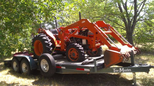

I'm trying to gauge what model this tractor might be from knowing which loader it has on it. It's not the most efficient method, but the seller is kind of :confused2: combined with lazy when it comes to selling this tractor which makes me :smiley_aafz:. I haven't went to look at it yet, but I probably will tomorrow.
Here's the picture:
The seller says the loader is a LA500. The side panels are off of the tractor in the picture which makes me think they thought the tractor was a LA500 model.
Any help/guesses would be appreciated.

L3010? Five hundred series loaders were on the mid-sized Kubotas.

It could be either a Kubota LA500 or a BF500 front end loader that came with the L2850 tractor.

The LA 500 loaders were used on L-2850 tractors, They were rated at 27 PTO horsepower.
