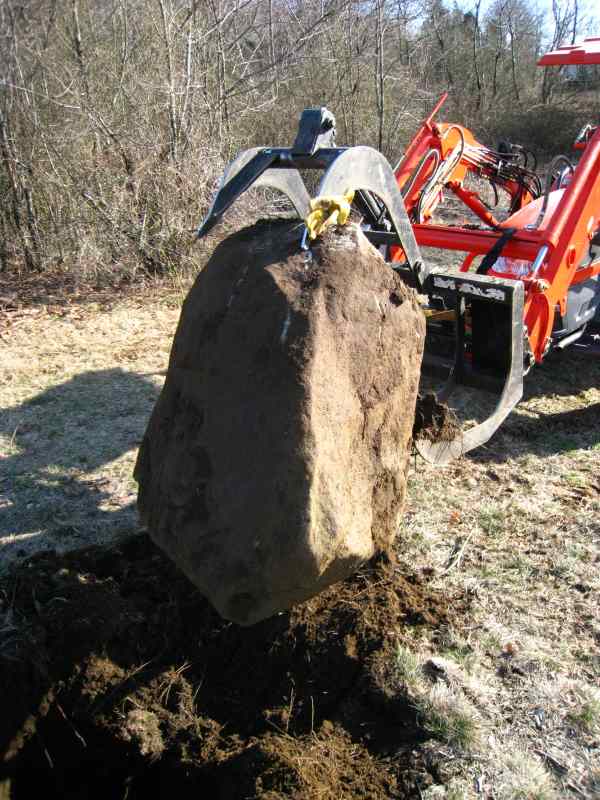

That might be correct but note that the rock is well more than 24 inches out from the pivot pins too. I'd say it shows the loader lifts about what the specs say.

Impressive pictures of the boulder, IT.

Josh's point is also why the lift and curl are useful for popping things out of the ground if you can dig a grapple underneath. You get the "full" rated lift and curl only at the pivot pins so the closer you get the object to the pivot pins the more force you can exert.
/ Which Kioti? #46
a boulder granite is 168 lbs a cubic foot. minimum size is 2X2X4= 16 cube
16 cube of granite is 2688 LBS. my take on the size is it is bigger than that.maybe in the 3500lb range.
for reference sandstone solid is 163 cuft.
/ Which Kioti? #47
That is what I thought too but even with the lower estimate it makes the point that the loader is not really overrated.
I think it's close to 3500 lbs +/-. I have a granite boulder that's about 50% bigger and it weighs 5128 lbs. as weighed by the quarry where I bought it. Of course, I can't move it.
