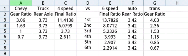

He asked if a 6 speed with a taller rear end (3.42) would tow as well as a 4 speed with a shorter (3.73). The answer is yes and it should technically tow BETTER since every gear will have a lower overall gear ratio until 6th which is the highway fuel saver gear. The 2010 F150 6 speed is almost identical nummerically but offered 3.15, 3.31, 3.55, and 3.73 axles.
Here's the numbers...
   / Which is the Better Tow Truck? #33
I posted this a few months ago:
Since GM went to a 6-speed trans. they have 3.08 and 3.42 instead of 3.73 and 4.10. Here is a chart I posted a few months ago. Don't let the low numbers
(3.08 and 3.42) fool you.
Trans ratio gearing--4 speed----------6 speed
1st gear--------------3.06--------------4.03
2nd gear-------------1.63--------------2.36
3rd gear--------------1.00--------------1.53
4th gear---------------.70---------------1.15
5th gear-----------------------------------.85
6th gear-----------------------------------.67
Overall gear ratio - trans X rear=overall ratio
-------------------- 4 speed w/3.73-----------6 speed w/ 3.08
1st gear-----------------11.4-----------------------12.4
2nd gear-----------------6.1-------------------------7.26
3rd gear------------------3.7-------------------------4.7
4th gear------------------2.6-------------------------3.5
5th gear-----------------------------------------------2.6
6th gear-----------------------------------------------2.0
I guess it depends on what all you want to do with the truck but it looks like 6 speed with
3.08 would be better than 4 speed with 3.73 for towing.

Ok, so if you were looking for a used truck with the older 4 or 5 speed tranmission, what setup would you get? The numbers obviously prove that a modern 6 speed even with a 3.08 rear end has lower overall gearing than a old 4 speed with 3.73's and that same 6 speed with a 3.42 has lower overall gearing than an older 4 speed even with 4.10's. You can't just look at the rear end gear ratio and you should care how many speeds they offer in the transmission as it makes a big difference. Wait til you see a new RAM 8 speed with a 2.80 rear end with lower gearing than an old 4 speed with 4.10's...
