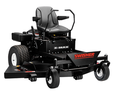

I have a 60" Swisher ZT that is probably half way between a consumer unit and a professional unit. Mine doesn't tear up the grass much. When going down hill it can get a little un-nearving if the hill is steep and the grass is a little damp. It will tend to gain speed quickly because it weighs a lot. Rather than use the brakes by pushing the handles "out" which is probably the "right" thing to do, I tend to pull them back to slow down. It is a stupid thing to do but feels right at the time because that is what I do on flat ground all the time. Then the wheels totally loose traction and spin backwards momentarily and steering becomes problamatical because they both don't loose traction at the same time. It then gains more speed and I have to push the handles forward to regain steering control, and pick up even more speed. I need more practice on steep hills.:eek:
Side hills are O.K. but it crab walks accross the face of the hill because the front is trying to fall down the side of the hill and the rear tire on that side has to be turning faster than the up hill rear tire to compensate.:)
Stability is not an issue. I don't think you could tip mine over even if you tried. There is just to much weight down low and the deck is 5 foot wide. I am pretty sure that you wouldn't be able to drive it to a place it would tip over, it would just slide down the hill first.:D
It is my understanding that the front deck ZT's are far superior on hills as compared to the mid deck ZT's although I have never used one.
I do like mowing with the ZT, it is like riding the tilt-a-whirl at the fair:D:D:D

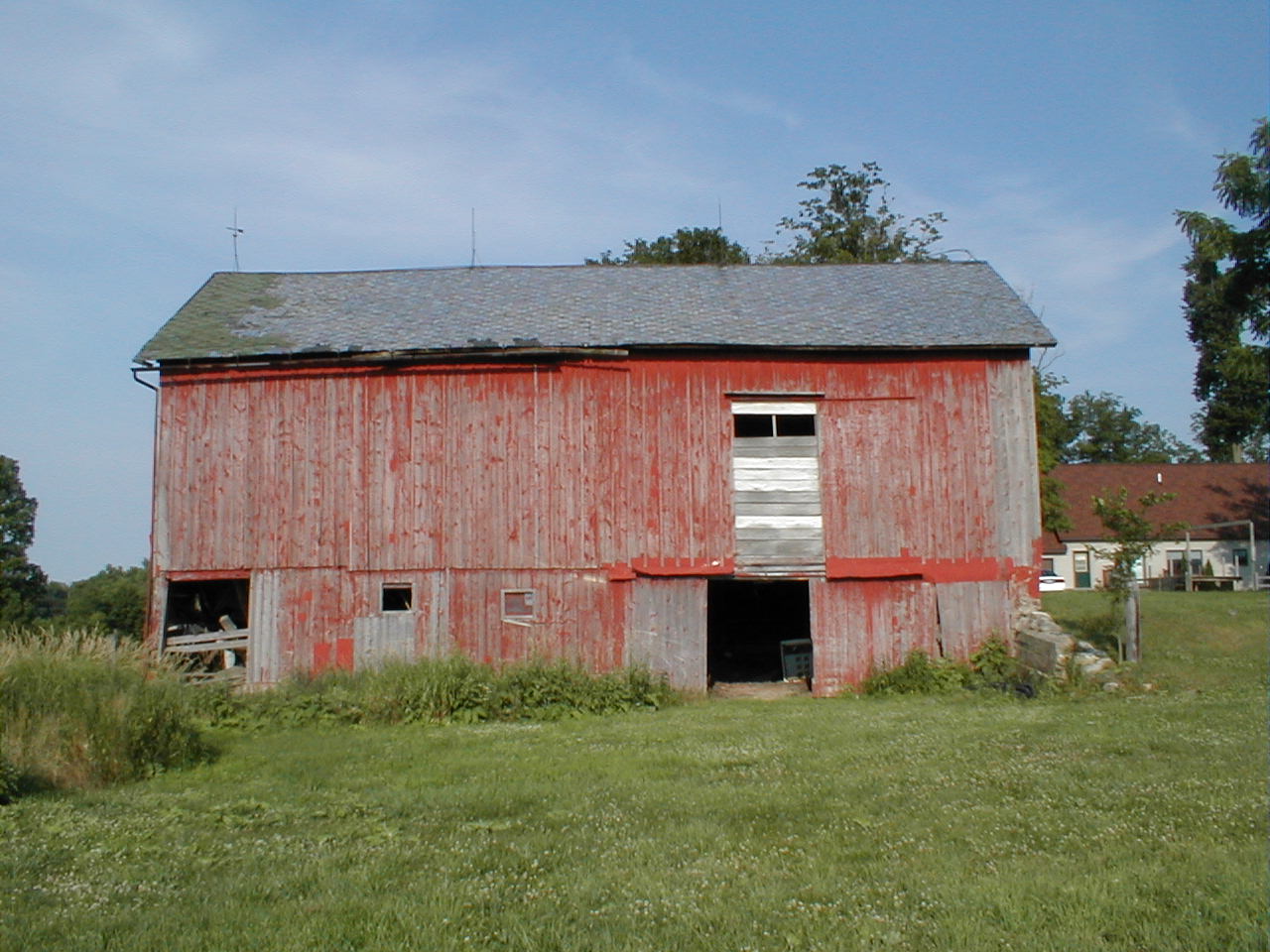

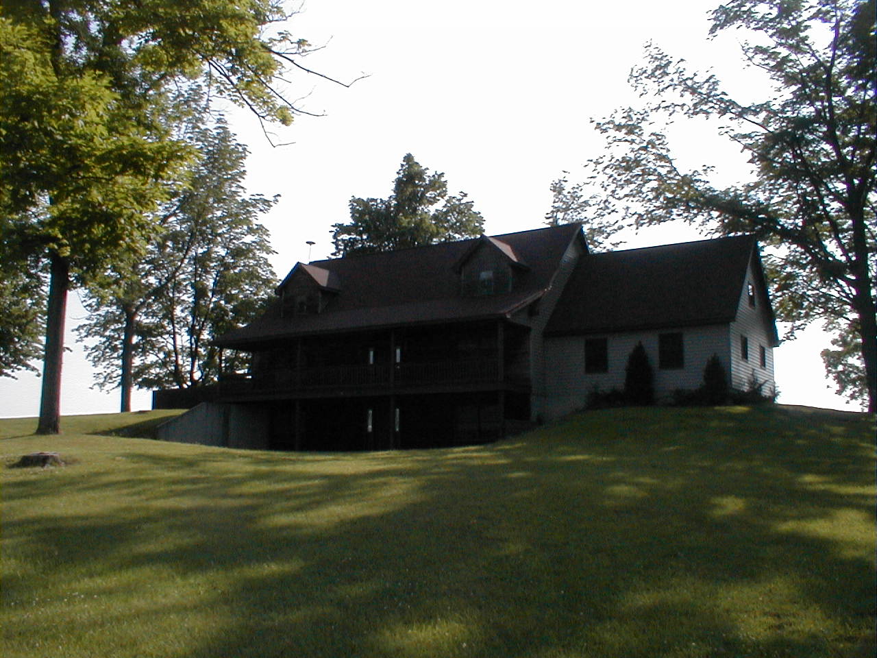

HOw steep are your steep hills, do you know?
   / Which is better for mowing on hills, ZTR or SCUT? #13
No I don't, my house is about 100 feet from the road. My basement floor (walk out basement) is about 8 foot above the edge of the road. Then it gains another 8 feet to the garage doors on the west side of the house. My old barn is a "bank barn" you can drive into the first floor and it also has a walk out basement on the back side of the hill. The slopes are irregular making constant corrections necessarry.

Great idea on the mowing - I'll have to remember that. Doesn't work for my current situation, but I could see being in a place where it was a neat trick.
Steve - I think I'm a bit steeper in places, but that looks pretty similar (I just built a bank barn for that reason). So you are a good comp indeed. Do you find going up hill easier?
oh yes it will climb an almost vertical slope without hesitation. With 26 hp and dual hydrostatic transmissions it will go anywhere. The weight transfer and traction are supurb when going up hill and it steers very well going up. If your area is aranged so you can do the steep parts going up and the more lesser slopes going down it will work well. From what I have read the professional units handle the hills better than mine. When you drive mine down a 45 degree incline like I have at the corner of my barn there is a bit of a pucker factor the first time. All is well as long as there isn't anything to run into at the bottom because the steering becomes a little vauge unless you have the stones to push forward on the controls. If I do that I am flying down the hill!:eek:
