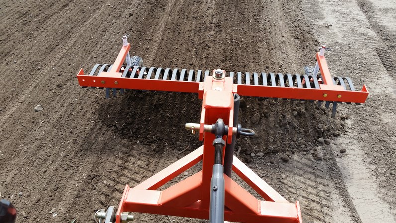

I don't know what brome grass is unfortunately, but it doesn't work like a tiller, it has small carbide knobs on the rotating drum (which does rotate similar to a tiller) which dig up the ground only a small amount at a time. I will typically go anywhere from 1" to 4" deep but usually somewhere in between. What it does is pull all the material out of the ground in front of the implement, and then there is a small opening that all the soil will go back through, which gets deposited behind the power rake, but the larger things like rocks, roots, old metal in the field etc, all get carried in front of it. At the end of the row you have a pile of debris with almost no dirt in it. Or you can windrow and push everything off to the side.
However, eventually you will have a pile of rocks or roots or what have you, to pick up with your bucket.
This job the op is trying to do, is THE purpose of a power rake. Absolutely the tool for the job.

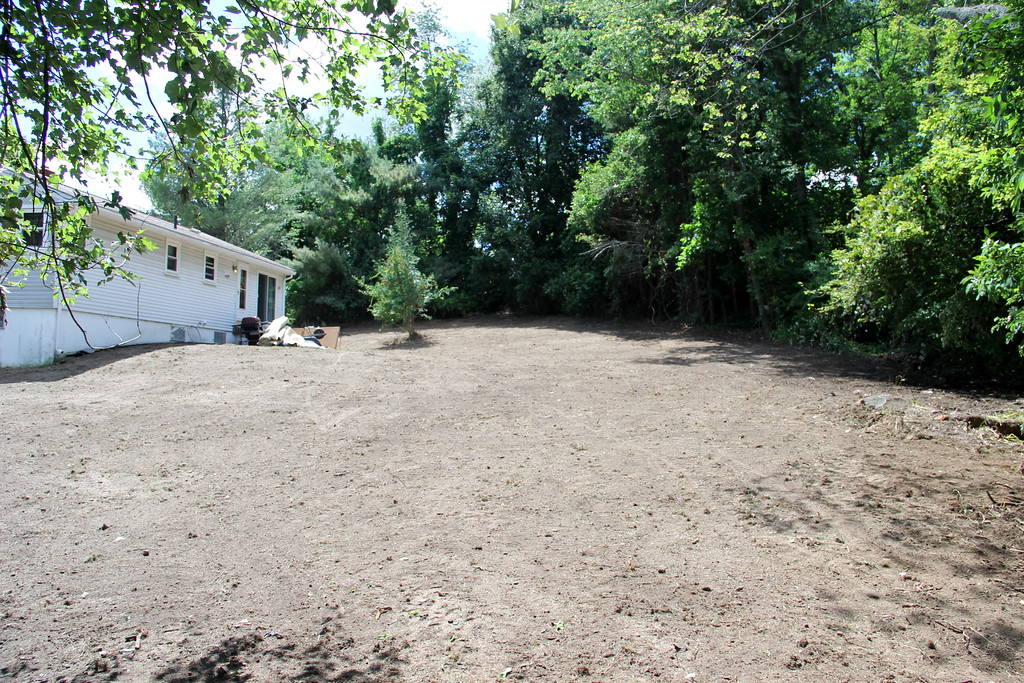

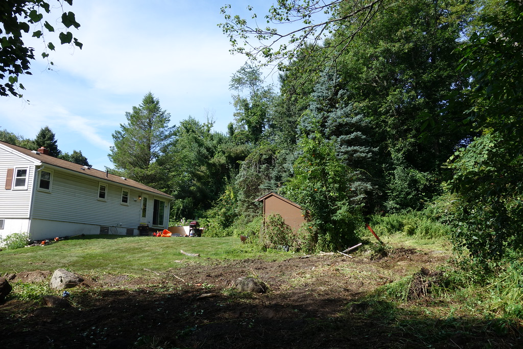

Here is a before and after of some heavier duty use.
