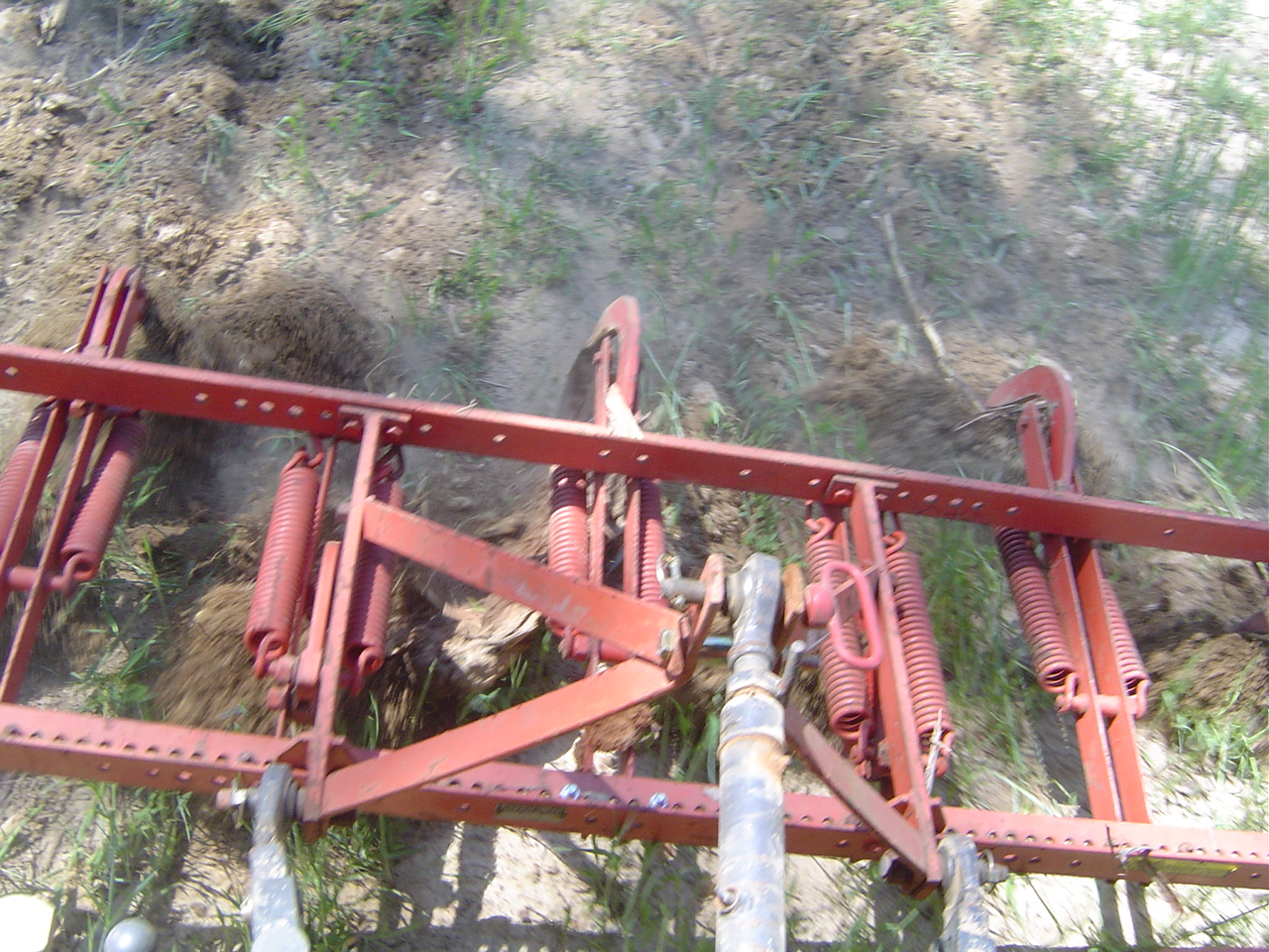

Here is what I use. Spring tooth chisel. Breaks up the clay nicely, pops rocks to the surface. 1 shank per 8 hp or so for a very general rule of thumb. This 7 shank unit can really pull hard behind my m5400. I know there are 5 shank units available new. Big spring on each shank so chisel will ride up if large obstacle is hit underground.
(Sorry about the pic size - I haven't found a pic resizer for Vista yet - haven't looked for one very much either)
