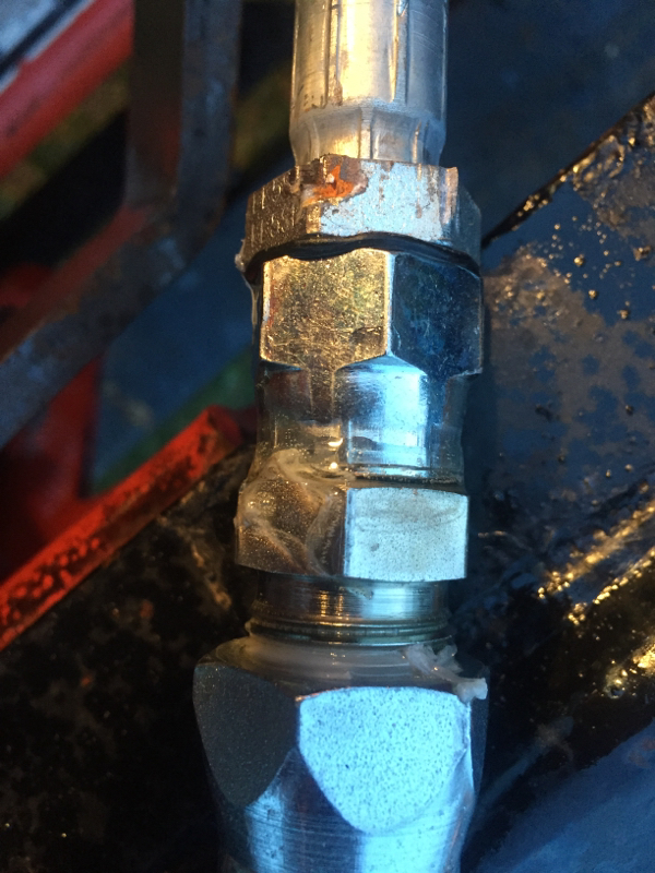

I may try this after my newest fix.... I stopped back at the Parker store(met another great employee) and I showed him my part. He stated the swivel is NIJ and torquing it down like a npt is not permitted as it will ruin the flange
Dope fully this is true Nd the fix works! If now, a new adapter will be coming

Ok, well this was a crock of crap. Still leaks under the new fittings (which were the spin fittings). So I called them and hopefully this coming week I'll get a straight adapter and not a fancy spinning couple.... SMH!!!

/ Which hydraulic coupler do I need #27
Never heard of NIJ either.
From the pic you posted, it looks like a Female JIC to NPT adapter.
JIC and ORB threads are the same. Same dimensional specs and one will thread into the other. However the seal is different. The ORB male threads dont have the 37 degree seat and arent normally long enough to tighten up the swivel anyway. And the way it looks like the o-ring is bulging out, it looks like you have a JIC fitting, That bottomed out on the o-ring, but is incapable of sealing at the swivel.
With a JIC swivel fitting, once tight, it should no longer swivel. The joint where it was leaking at the swivel, was it still loose and free to spin?

Never heard of NIJ either. From the pic you posted, it looks like a Female JIC to NPT adapter. JIC and ORB threads are the same. Same dimensional specs and one will thread into the other. However the seal is different. The ORB male threads dont have the 37 degree seat and arent normally long enough to tighten up the swivel anyway. And the way it looks like the o-ring is bulging out, it looks like you have a JIC fitting, That bottomed out on the o-ring, but is incapable of sealing at the swivel. With a JIC swivel fitting, once tight, it should no longer swivel. The joint where it was leaking at the swivel, was it still loose and free to spin?
Yes, lose and free to spin

Yep. You likely put a JIC female on that ORB hose.
Not saying they don't make one, but I have never seen a swivel female ORB fitting.
But you can get one that swicela on the npt side

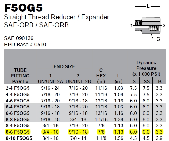

Not saying there isnt, but I have never seen one. Got any examples? Cause they make JIC, and Pipe in swivel fittings. So whenever you need a swivel adapter, its always the JIC or NPT/NPSM fitting that is the swivel end.
DHH dont show any that swivel on the ORB side SAE Straight Thread O-Ring (ORB) Hydraulic Fittings
To ken....I believe this is the fitting you need 6404 | Female Straight Thread x Male Pipe
Yeah, they do make a Male ORB Swivel. You can see one here:
but you'll have to to down to the bottom of the page to find it.
Either way the 6404 adapter should work.

Ok, well I received the right part yesterday and it all works.
First off, I mention NIJ. LMAO, I will have to edit my earlier post advising there is no such thing. I have no idea where I screwed up the letter but I was corrected on here and it is JIC. I apologize if I throw anyone else off who scans through this thread and reads that.
So essentially the hose end is a size 8-ORB....
To translate this. 8 equals 1/2". Every additional 2 is an 1/8" increment.
2 - 1/8"
4 - 1/4"
6 - 3/8"
8 - 1/2"
ORB is: O - ring boss
So I needed a 8-orb female to JIC male which fit into the ag ball fitting. I also learned ball and poppet ends are compatible.
Anyhow, hope this helps someone else down the line. If any of the hydraulic guys out there want to elaborate on this feel free. (Or correct what they see fit). Thanks for all the help.
