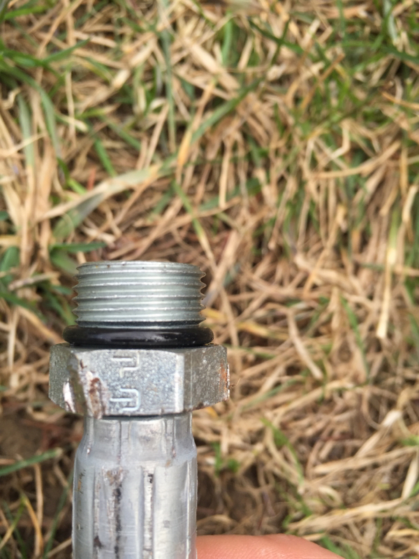

After buying a wrong part, instead of buying and trying I figured I'd ask here if someone has a part number I can just order online.
I have a 1/2" male O-ring end on the hydraulic hide and need it to fit my tractor side 3rd function quick attach.
This is the half inch hose side (for my new tree shear).

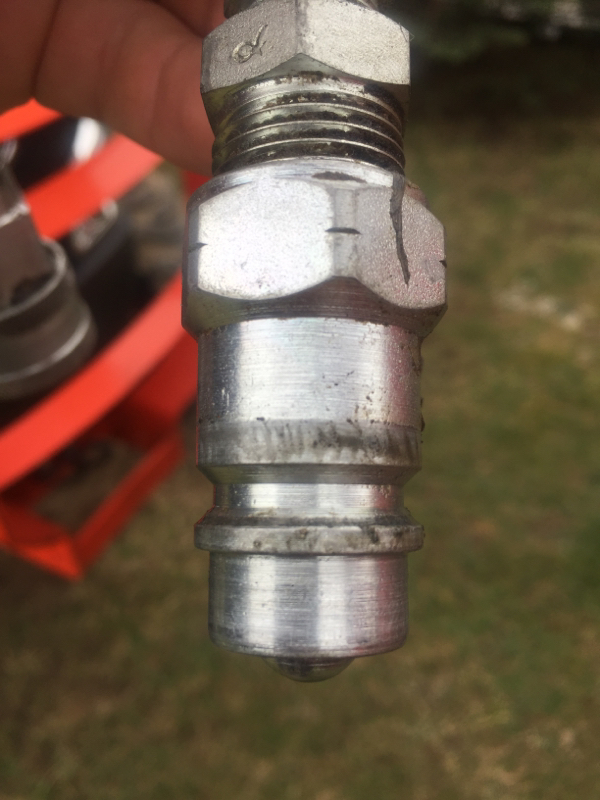

This is the tractor side quick attach. More photos to come but I can only post one photo per post for some reason

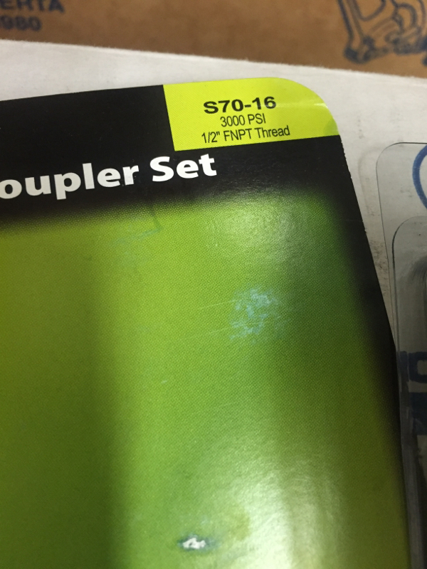

I purchased this as it fit the tractor side quick attach but I couldn't seem to get an adapter at the store which fit the hose side and the tractor side. All they had was female pipe and nothing else so I just returned them today in hopes someone here would have the right parts for me

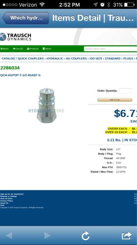

Here is what you need.
/ Which hydraulic coupler do I need
Will a poppet end work with a ball end?
Also, do poppet vs flat have a different flow rate ? Not that this should overall make a difference is think. Does it change PSI at all?

Isn't that going to end up with a male to male quick connect? It looks like he has a male end on his tractor third function hose.
It's ok, I should of been more clear, I'll need one female and one male.

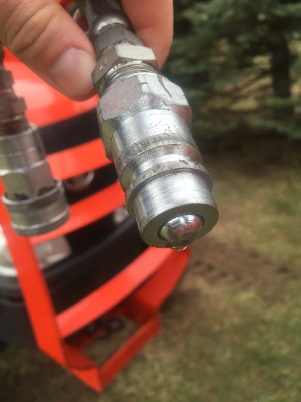

This is what I'm matching to...
/ Which hydraulic coupler do I need #9
Now go look at your other implements that line connects to and see which female coupler is on it, then look for the same coupler with a 1/2 female threaded end at a hydraulics supply place like the one the other poster posted up. You only need one fitting and that will be to adapt the 1/2" female threaded fitting to the female hydralic quick coupling. It doesn't look like an NPT pipe fitting because it has an O ring so isn't an NPT fitting.

Will a poppet end work with a ball end? YES
Also, do poppet vs flat have a different flow rate ? As long as both have the same size body, (1/2"?)they should flow the same.
Does it change PSI at all? NO

Put a -8 ORB female to 1/2" NPT male adapter and then use standard AG couplers. You may need adapters for the tractor side to go from 3/8 to 1/2" if your setup is the same as mine.

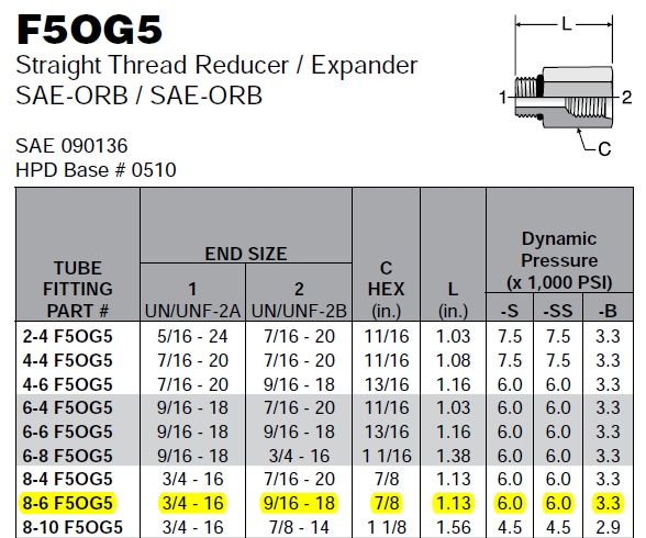

The Parker 4300 Catalog 4300 - section F "Pipe Fittings and Port Adapters" has SAE ORB (O-Ring Boss, straight thread) adapters, and every other variation. Every fitting you could imagine can be found on this catalog available for down load from the Parker site.
From you first photo the fitting is a ORB. The only question is it truly a a 1/2" (#8 ORB, 3/4-16 thread) on the 1/2" hose, or is it 3/8" (#6 ORB, 9/16-18 thread). The tractor side looks to be NPT. If the 3/8", Parker makes an adapter shown below. If the 1/2" you are good to go. They also have NPT to SAE-ORB adapters if you go that route.
Also if you need additional Quick Couplers (Parker Quick Couplings Catalog 3400 - Section B "Hydraulic Quick Couplers" PDF download) makes a 4000 and 4200 series of manual quick couplings in 1/2" size with either NPT or SAE-ORB connections conforming to ISO 5675 (standard agricultural fitting) . They also make a 8010 series nipple and an 8200 series coupler that you can connect under pressure, if your implement has shifted and there is too much pressure in the implement lines to connect to the tractor.
Most other companies can cross reference a Parker #
Happy plumbing
