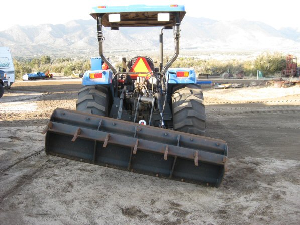

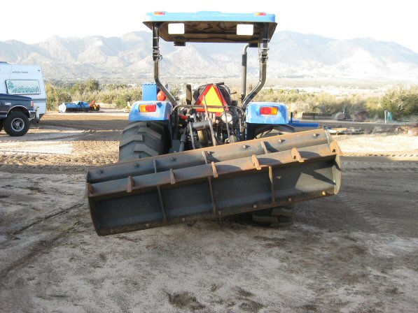

Thanks for the thoughts. I figure that I will have all of these attachments....eventually (could be a couple years). Yes I have a nice rollover box blade so the TNT would be useful, but someone already mentioned that I can make those adjustments by hand when needed, it just takes longer. My estimate on TNT might be a little low. I already have the rear remotes, but need hoses and I forgot to figure shipping.
The price on that grapple is good, but it's still more expensive than the other two options and it's probably the one I need the least. I can probably get by with some forks and elbow grease, but it's sure hard to pass on the price. Here is the thread where i found out about the grapple. The OP bought one.
http://www.tractorbynet.com/forums/...apple-research-tentative-conclusion-what.html
There are a couple auctions coming up and maybe I can pick up a decent set of pallet forks for cheap and then get a hydraulic top link.

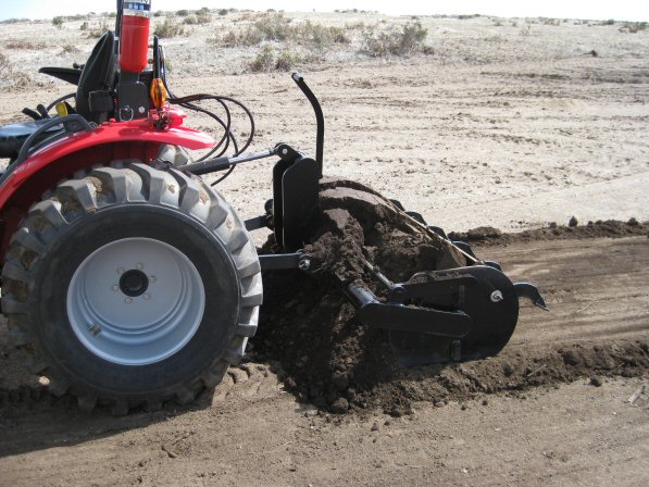

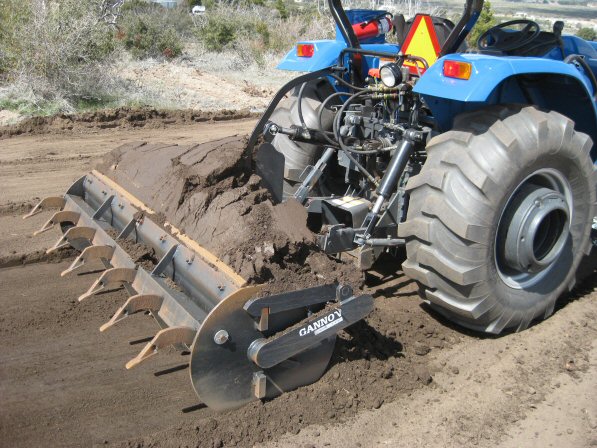

Trust me when I say that since you have a roll over box blade, you will have far more use for a hydraulic side link than the top link. RO boxs do not get used in the same manor as the std type BB. There is no need to be constantly changing the pitch of the box with a roll over.
As far as the "TnT" cost for your tractor, I would recommend a set built with 2 1/2" dia cylinders, with 1 1/2" dia rods for your size tractor. Hoses with QD ends and hydraulic flow restrictors. This cost would be $575 + shipping. PM me your zip and I can get an accurate shipping price for you.
Here are a few pics and as you can see, I like the roll overs enough to have 2 of them. :thumbsup: :thumbsup:
