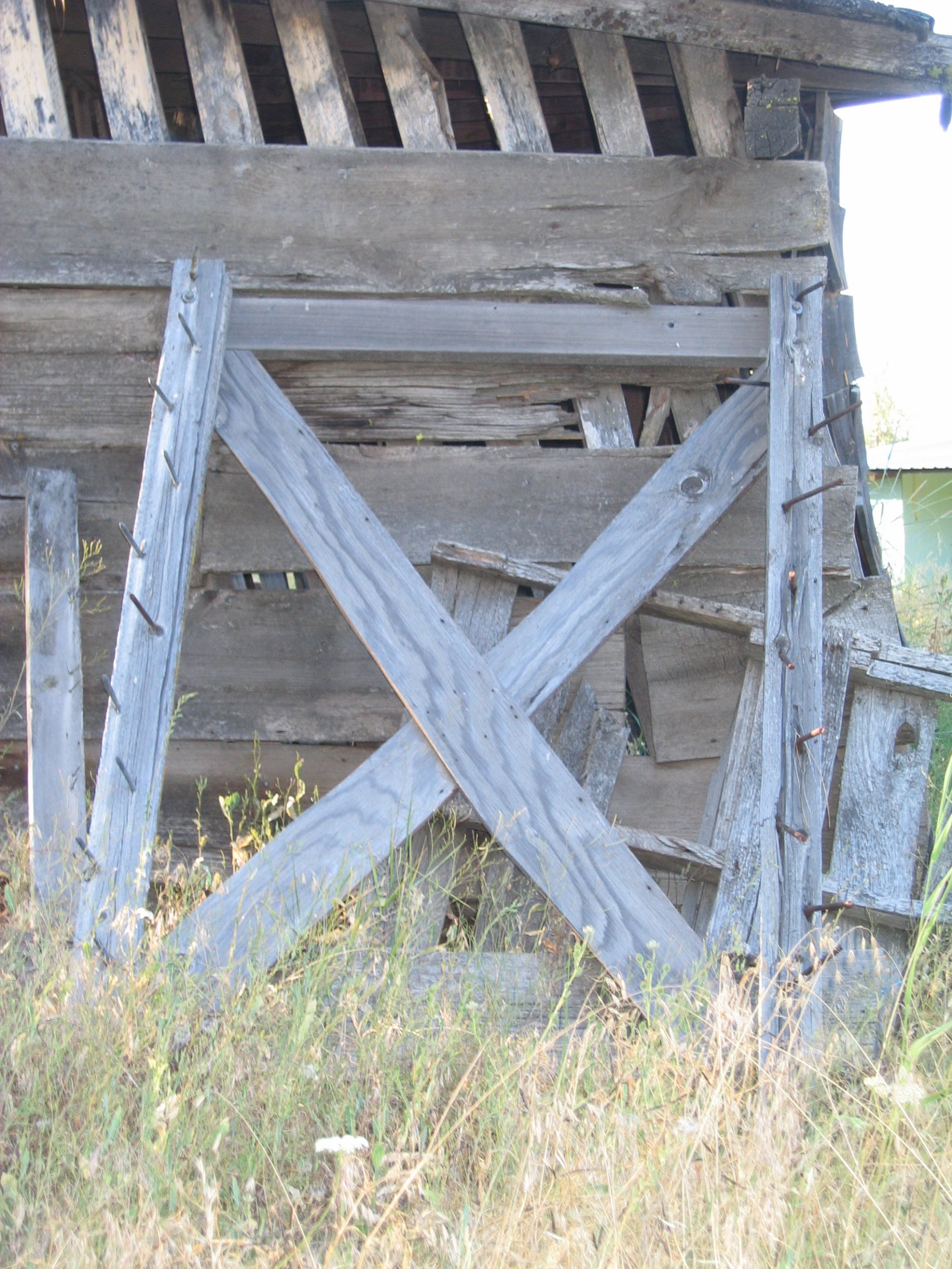

If my driveway was only 150 feet or so - - just as Rebeldad 1 says. Have the delivery truck dump/spread it with a controlled tailgate and finish with a heavy garden rake. Unless you plan on extensive uses for one of the three implements listed above - make yourself a simple "drag". I tow this behind my ATV to level land. It would take longer, more passes, if I used it on my driveway but the cost - ~$20 - is more in line with what you need.
The spikes were an added "option" - brought the overall cost to - $20.

Making yourself a "drag". Use what you have available and your imagination. A log or two - an old railroad tie - an old set of bed springs, wood pallets with added weight. I can/do add weight to my wooden drag. A sack of sand on each corner - cement blocks on the center plywood cross. I turn this drag over and pull when I don't need the spikes.
