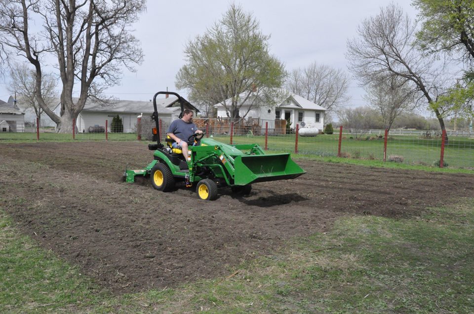

Greetings! I have a compact tractor and some former pasture with a tough layer of sod, that I'd like to turn into a 1/4-1/2 acre garden plot. I'd prefer to rent rather than buy. Can I accomplish this with a single implement? Harrow? plow? tiller? Do I need a college course? :scratchchin: Should I till in the fall or wait 'til Spring? Thanks!

I break field sod with the King Kutter II tiller and it works fine.
I first cut the field short so I don't get long grass wrapping around the tiller spool.
Then I make a first pass, shallow, to chop the roots up and find any shallow rocks.
Then I make a deep pass to mix and bury the chopped up roots.
Then I let it sit for 2 weeks to decompose and let the weed seeds I've just exposed germinate.
Then I deep till again and it's ready for seeding.
Then I cultipack to get the seeds in contact with the soil and create a series of ridges so the seed doesn't wash away into pools if we get heavy rain.
We don't have many rocks, here, so others may have better advice if your soil is very rocky.

You might think about renting a subsoiler to break up the soil first. For only 1/4 - 1/2 acre, a single shank one will be sufficient (which is all your Max25 will handle anyway). I would make multiple passes in a checkerboard pattern. Then a chisel plow, moldboard plow or disc plow would probably do a better job of breaking it up.
If you have a lot of rocks, you will want a shear pin on the subsoiler and spring-mounted shanks on the chisel (what I would call a field cultivator) in case you hit some subsurface rocks.

That's what I did...except I have a Deere 647 tiller.
