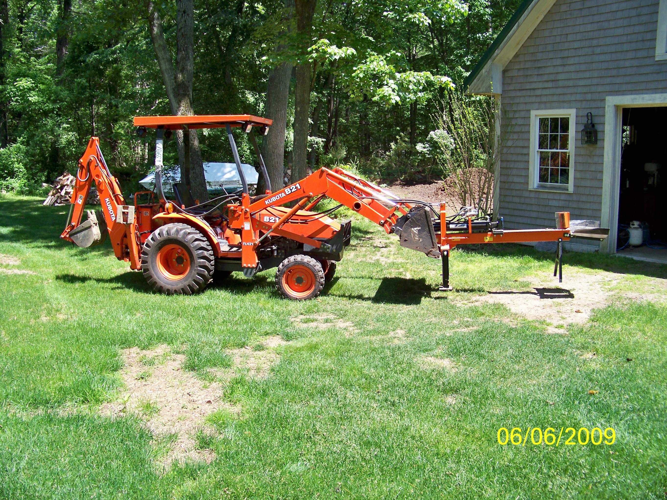

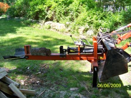

I agree with 955er - I bought directly from Doug 4 years ago and he made some mods to the basic 3 PT set up..
1. Legs that bolt on the 3 PT pins
2. Tripod that pins on the front
3. 15' Hyd Hoses to attach to the BH connection
The legs and tripod make it easy to use and store in the barn and the tripod can be unpinned and using the loader lower to the ground.
I put a loop thru the top link and hook onto the front of my B21, pin up the BH, hook up the hoses and I am splitting in 5 min...
THe spliiter works really well - not speedy but at a speed that I like, and the tractor runs about 1200 RPM - just above idle..

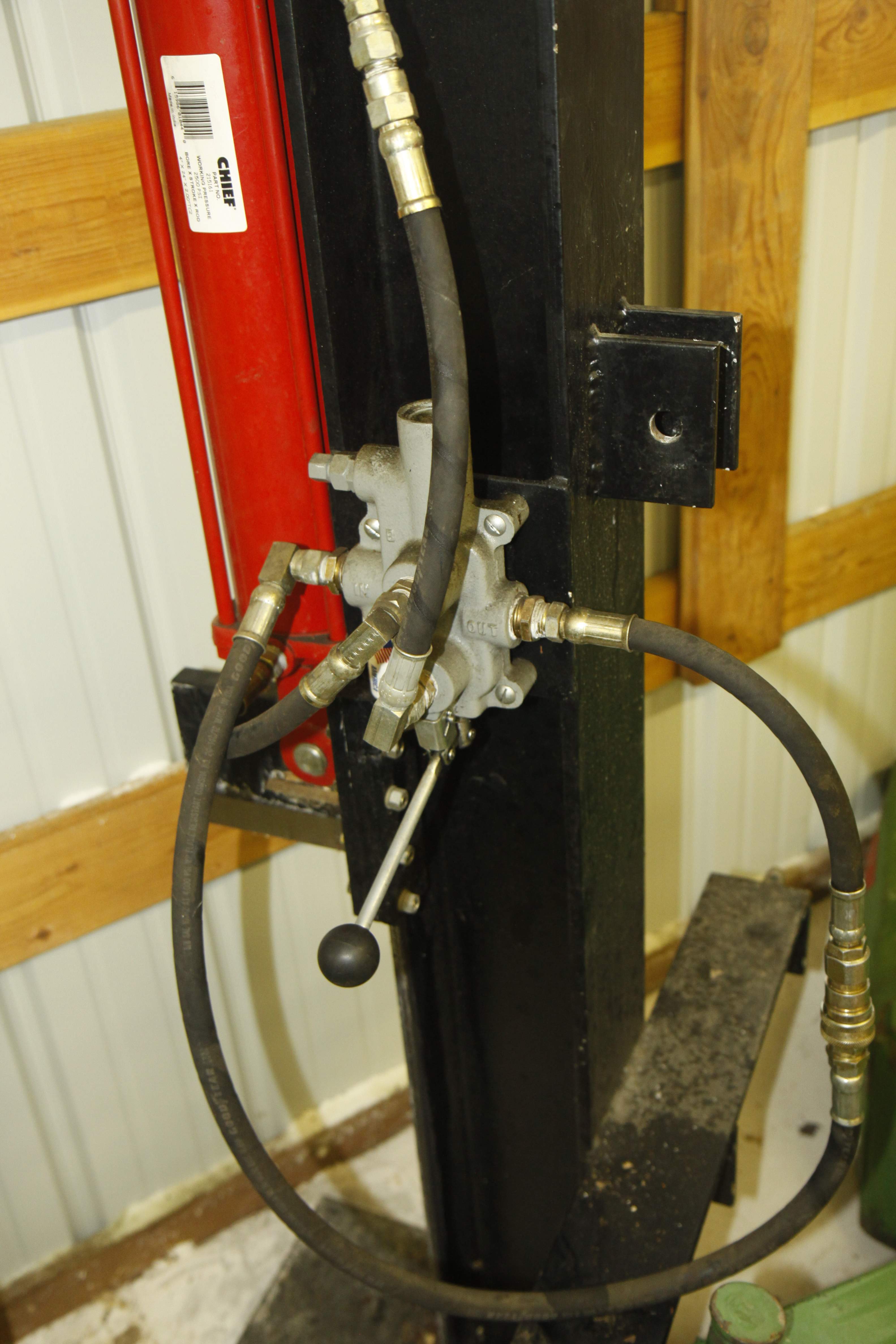

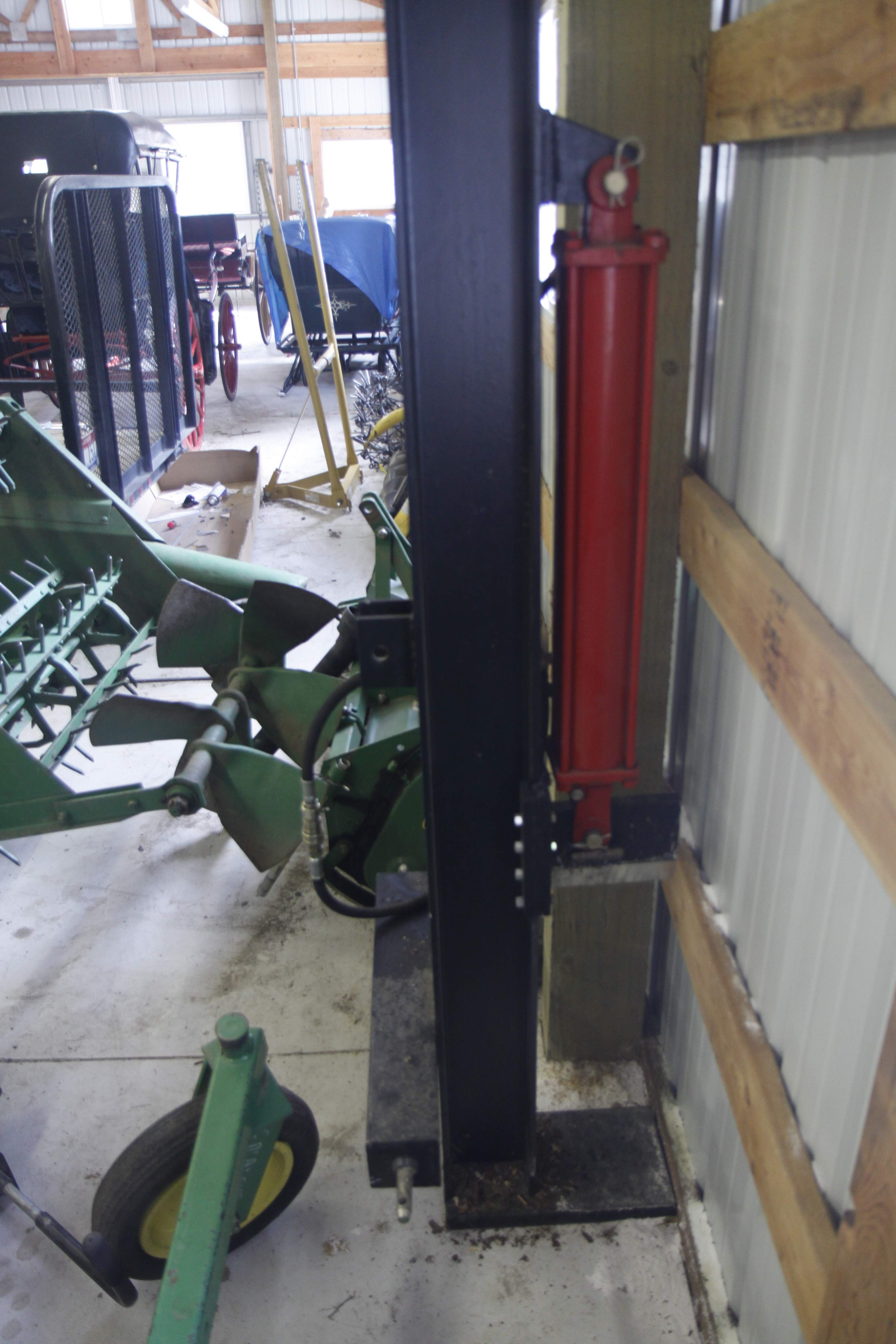

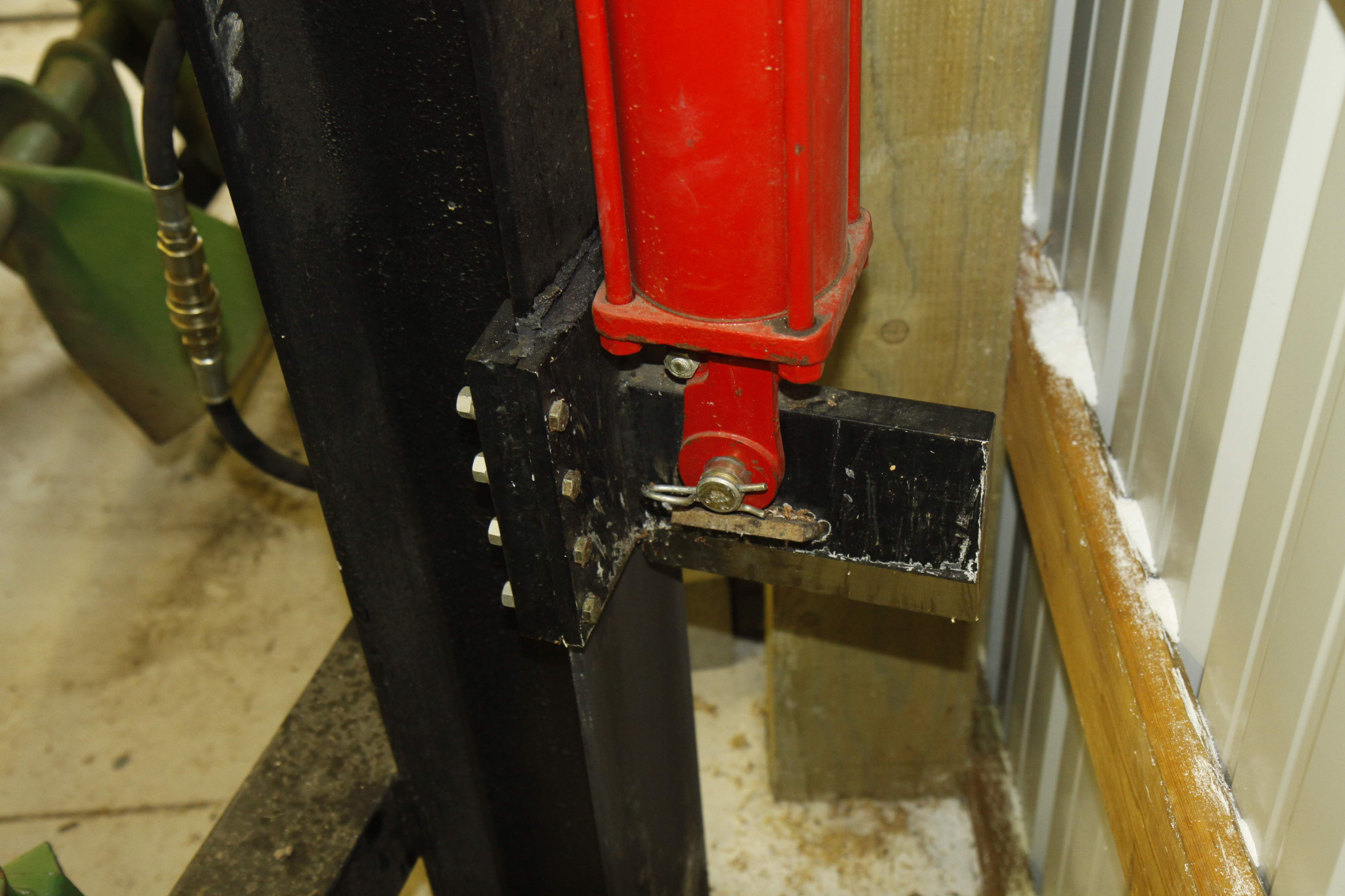

if you have a welder and some time...you can make your own. i made mine for a couple hundred in scrap steel, a surplus ram and some new hoses and valve. it took all of one day to weld up the thing. The hoses and valves took a week to get in the mail. i got the wedge and ram shackle from northern equipment. if i remember right, i got the 6 foot piece of i channel for scrap steel cost at a scrap yard i split mainly fir and tamarack here, and have never bound it up. I could have bought one....but i sure like making my own stuff. only problem is....if it doesn't work, i'm the only idiot i can blame. Also, as far as cycle time is concerned, i found that by adding a small v shaped wedge to the cutting bar, and since my logs are all 16" long, i usually only have to push into the wood 4-6 inches to split the wood, so i don't have to cycle the ram the entire way. it only takes a few seconds between splits. i only wish i had the energy to keep up with my splitter.
