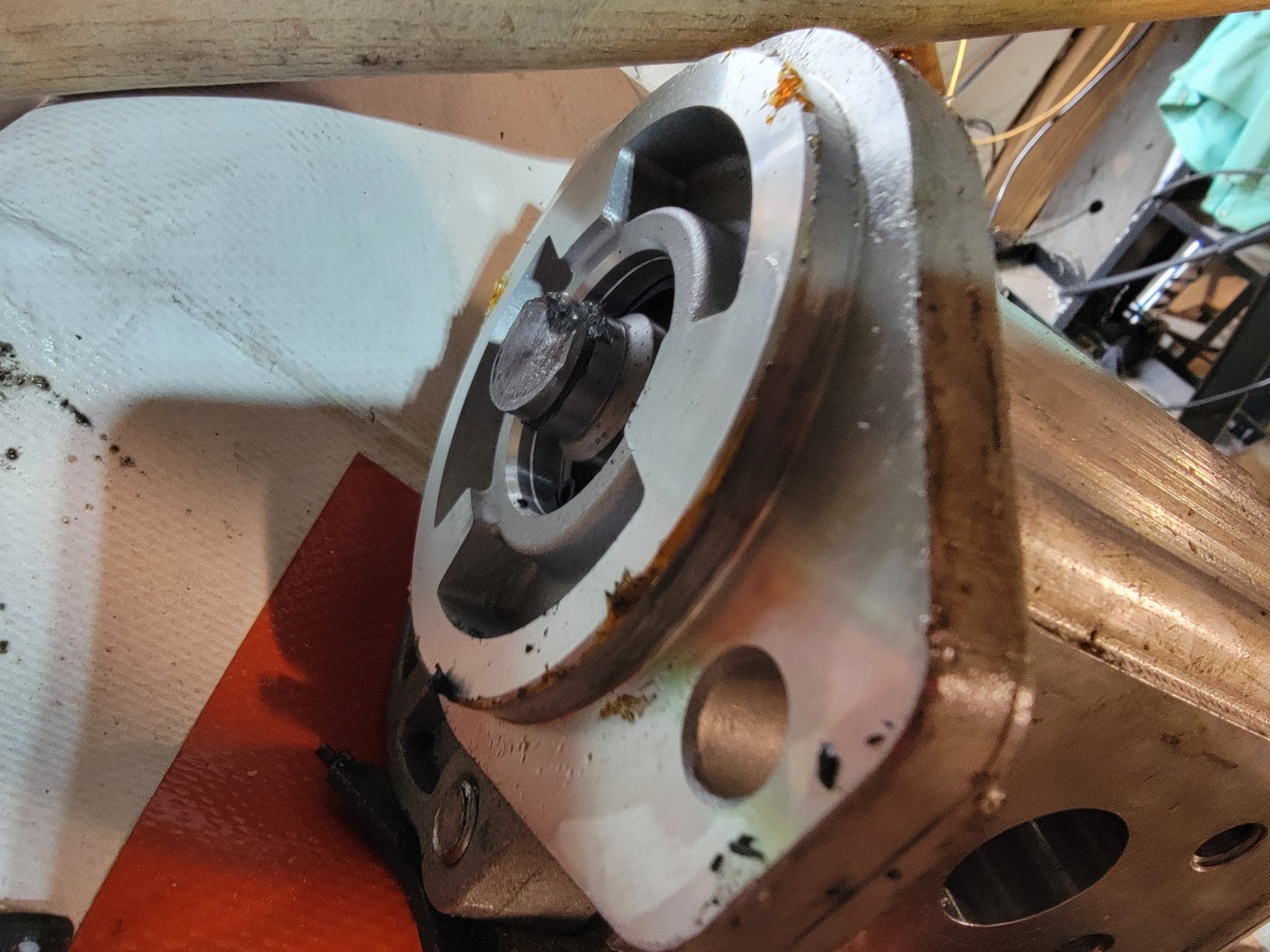

Managed to snap the input drive shaft (? - if thats the correct term) off on a Joyang JP20 /31 /F21 /S6 /L which was used on a 3 pt backhoe and am having a fit trying to find a replacement.
Anyone have a line on where to find matching replacements or rebuild parts on these?

See if you can match dimensions with a US Supplier. But seriously, when you buy these machine from Korea, Vietnam, India, etc, where do you expect to get replacement arts ? Or is the low price vs. service quality function so strong that you can afford to junk it after a few hours of use ? I buy stuff with a brand that a local deal can service, supply parts, and can show me the exact machine or attachment that I'm buying. I am surprised that Amazon doesn't have your part, maybe they do, you just have to carefully paw thru the maize of stuff, taking into consideration the bad reviews.

It might be easier to find a replacement pump that uses the same mounting flange, shaft, ports and displacement. SurplusCenter would be the first place I'd look.

any manufacturers markings or numbers on that pump? A concern I would have is why did that shaft break? Usually indicates some sudden torque shock like relief valve didn't open or if on 3 pt line possibly not connected fully.
