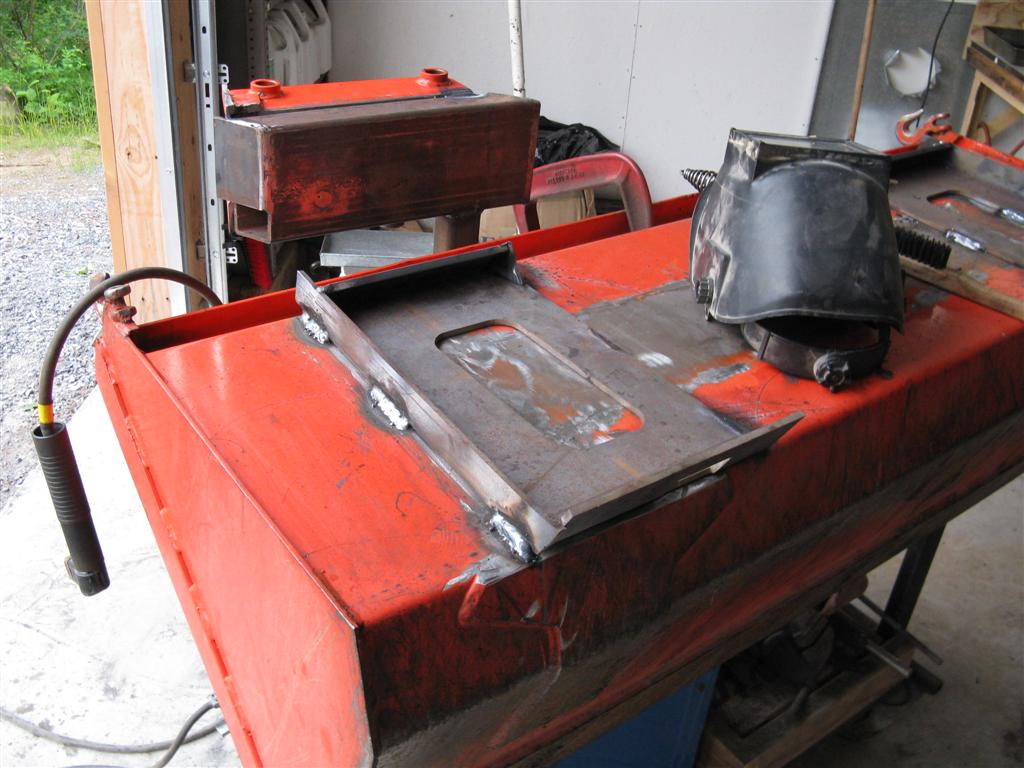

I need QT plates or mounts for the implement side of the QT.
I see some on Ebay. I like the two seperate plate style for a loader bucket.
Anybody on TBN make these or have a source?

I had a Bobcat skidsteer at work and wanted to put a 7 foot western plow on it.
I asked the nearest Bobcat dealer if he had the QA plate. He did and it was about $135 or so.
It was very easy to put the plow onto it and it hooked right up like any factory QA imp would
But it was the one piece plate

Here is a link to the ones that I have used and they fit well and I would buy them again. KFI QA PLATE

I bought a QA plate off Ebay. Sorry cant recall the company. But the bottom cut outs were a tad too small and I had to grind them out a little to get them to fit right. Took about 1/2 hour with 4 1/2" grinder and a couple of cutting wheels.
Looking to get another one when I convert my snow plow to skid steer mount for the tractor.

I think everythingattachments.com sells them and it could even be with free shipping.

I made my own. First sets I made I sent a fab shop drawings for water cutting and forming (break). I welded the top piece. These turned out very nice. Depending on the quantity you want done this might be an option for you. I can send you drawings if you want them.
I have since made attachments (pallet forks) where I integrated the QA with the frame of the attachment. This saves some weight that you don't need - especially with smaller tractors.
For cost, I would suggest you make your own. 1/4 inch flat stock, drill bit and jig saw and you will have the rectangular cutouts done in ten minutes. When you install them well gussets to support the ends.
Here is a pic of a QA plate that I had water cut and formed; search for "tractor side QA", I detailed my builds there.

In case someone wants to make one.
  • Bobcat quick attach plate.pdf
