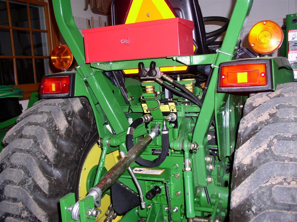

Where to get bulkhead Hyd. QD
   / Where to get bulkhead Hyd. QD #11
Beau, no part of my tractor is that clean except on the inside - - well-ll, maybe after a hard rain.
Larry
   / Where to get bulkhead Hyd. QD #12
W.R. Long has them. I just purchased the Coupler (bulkhead) plate and
2 fittings.
Fittings are:
Adaptor #6 Female Pipe to #6 Female JIC Swivel
Part # ADPT6506-6-6
   / Where to get bulkhead Hyd. QD #13
kennyd said:
Nice job Beau.
Are they under the operator platform? What do you use them for?
I put the QD bracket under my toolbox mount.
I use these remotes for the angle control on 1 of my rakes.
