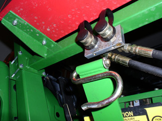

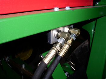

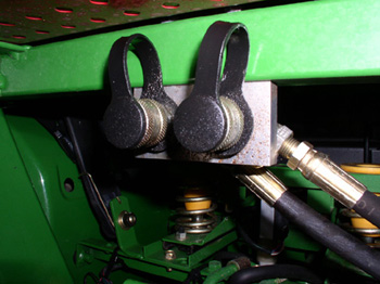

   / Where to get bulkhead Hyd. QD #9
Here's how I solved the QD mounting problem without buying any special parts:
I used standard off the shelf QD's and mounted them in a block of 1/2" aluminum bored to fit the diameter of the QD and held in place with a 1/4-20 setscrew.
I guess I should have wiped off the oil and dirt before taking the photos!
   / Where to get bulkhead Hyd. QD #10
Nice job Beau.
Are they under the operator platform? What do you use them for?
