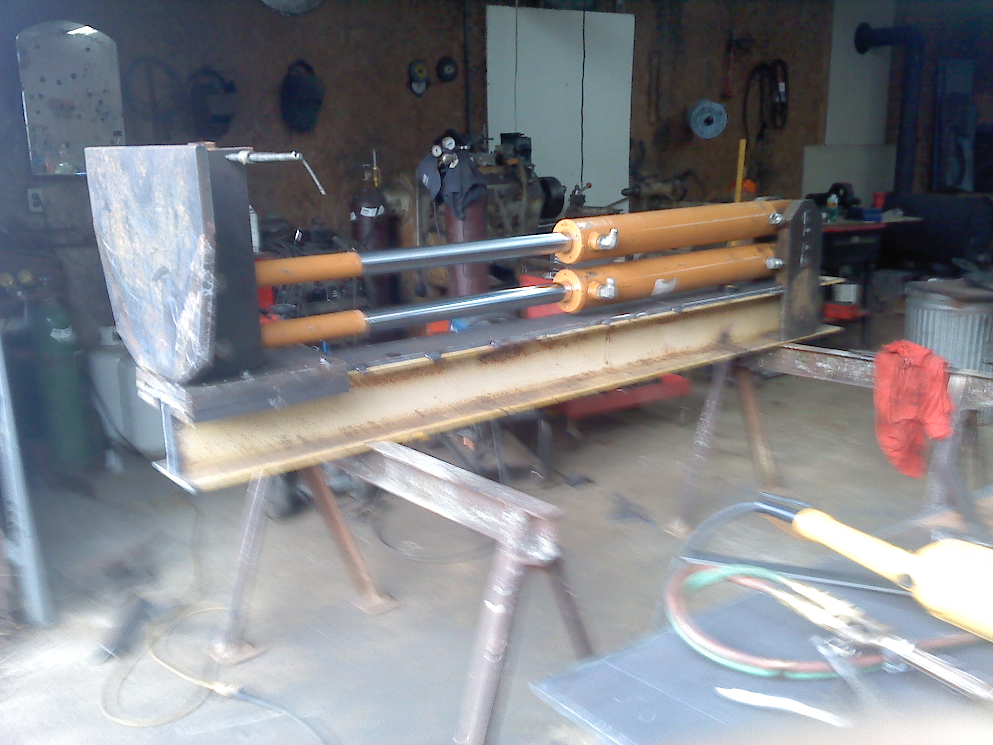

That's some serious size beam you're talking. I used S8 @ 18.4 for mine. I think you be better of using I beam (S), the outer edge of the wide flange flange will be quite a ways fron the center verticle section (web) of the beam and might have a tendancy to pull up. Depending on your design of course so I could be full of it :).....Mike
Not sure on his design, but S-type beams are pretty uncommon for a splitter for a few reasons. First, the inderside of the flange is tapered and not flat like a wide flange beam, makes it a little more challenging to secure the pusher connected to the ram, down to the beam. Second, S-type are alot weaker in the horizontal direction, and even a bit weaker in the vertical direction. And third, they aint very wide, so it dont leave a nice wide ledge to sit a round on that needs split.
Now to the OP, yes those are some pretty heavy beams......but you mention using a PAIR of 5" cylinders. I am curious to hear a little more about your design.....perhaps there are some better options out there.

I read it as he was going to pair his hbeam with a 5in cyl not use a pair of 5 in cyls
Here is a pair of 4.5in cyl on a 8x8 hbeam
I think you are right. I think I mis-read.
In which case, I think the OP is looking for way to heavy of a beam.
I am all for building overkill strong, but this is excessive. Many times I like to lift the splitter with my hands by the tongue and jock it around just a bit. That would be a bit harder to do if you build a tank. You dont have to build a 5000# splitter to be plenty strong enough.

I took that pic of my twin cyl splitter last Sept. I could take that same pic today as nothing has changed. I had rotator cuff surgery last Sept and Knee relacement last June and have pretty much been sidelined for a year now. Knee seems to be healing, weather is cooling, look forward to getting back to finishing my processor.
I am bad to over build and make things heavier than they need to be. In the case of my double cyl splitter and the 8x8 hbeam. I dont think there is anyway that beam will withstand the pressures those cyl can put out. The 30in stroke of the cyl and the overall lenght of the beam will probably cause the hbeam to bend in the middle. To strengthen the beam. I have already plated the top flange with 1/2 in plate making the flange 1in thick. I intend to box the web on both side with additional 1/2in plate. . Boxing instead of just plateing the web should provide some strength to prevent flex and twisting of the hbeam. I also made the slide for the pusher block extra long, hopefully to prevent kinking of the top flange. All this extra metal has made the splitter very heavy and I wont be moving it around by hand. I am hoping all this metal isnt overkill and not enough because i would hate like heck to rebuilt the beam because I didnt build it strong enough to begin with.
