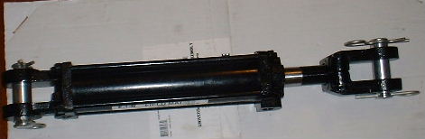

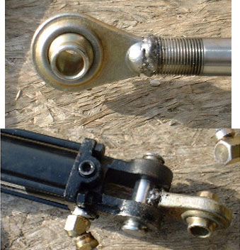

I bought an Eaton 2x8 at Central tractor (Quality Farm) for $40 on sale, then cut off about an inch. Now it goes from 19"-27", center-of-pin to center-of-pin. I had to put ball-type conectors on both ends, so I just bought an extra, regular top-link which I cut the ends off - I wanted to retain the original equipment /w3tcompact/icons/wink.gif.
2" is plenty of diameter... heck 1.5" would be enough. The top link does maneuver all the weight on the 3PH, but it's not like it is doing the direct lifting.
I know that CT is out of business, but any farm store should either have it or be able to order it, or you can get them at any of the pplaces the other uys have mentioned.
How were you planning on controlling the link? Are you going to need the valves, or did you already get them with the tractor

here's a picture of the ends
p.s. - I'm a novice welder, so don't look too closely /w3tcompact/icons/laugh.gif
